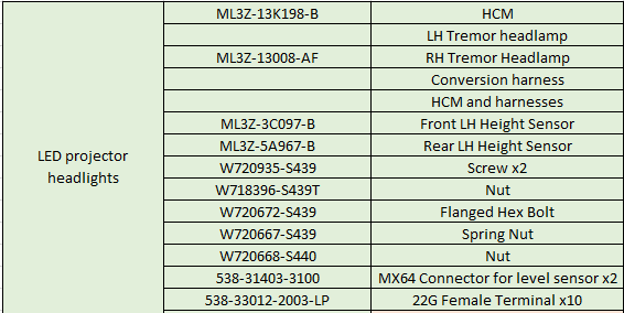

EDIT: Here are the parts I bought for my entire conversion WITH the auto level:
Ford F-150 LED projector upgrades 1680434543842
The ML3Z part numbers are all Ford part numbers that can be purchased from a Ford parts website. I never was able to find the LH Tremor headlamp part number, but they're easy enough to find on eBay without it. I purchased my Conversion harness and the interior harness (the one labeled HCM and harnesses) from Ryan Broderick, to the best of my knowledge he is not a member on here. Anyone can make their own, as there is nothing proprietary about any of it, but I would HIGHLY recommend purchasing a premade one if you are even the *slightest* bit unsure of yourself and your skillset.
I was only successful due to the help of @JHForman812 . He is incredibly talented with this stuff. (To be clear, I am NOT offering up his services, as that is not my place to do so, but I had little to no experience with electrical, I just know my way around cars and know how to work on them and with ALOT of his guidance I was able to get it done.) I spent dozens, if not over 100, hours reading and researching for the install of the headlamps and HCM and for the wiring and components required for the level sensors (I even purchased the incorrect set of parts once which were non-returnable). Everything from the "Front LH Height Sensor" down is required to make auto level work. I did not include the wiring I used, which is 22ga TXL wiring that I got from wire barn. You'll almost certainly want 6 different colors that are 25 ft long so they can be cut down to length.
I do not have part numbers for all of the various connectors on the harness for the headlamp conversion.

For example - part numbers for missing items. I found the HCM is ---------- and was able to pick one up for about $140 on the eBay. (EDIT: after seeing the other edit that you can buy it from ford for way less, I'm scrubbing my part number so nobody gets lost)
At the time of buying this place had the cheapest reasonable ship times to me. Results may vary https://www.fordpartsdistributor.com/oem-parts/ford-control-module-ml3z13k198b

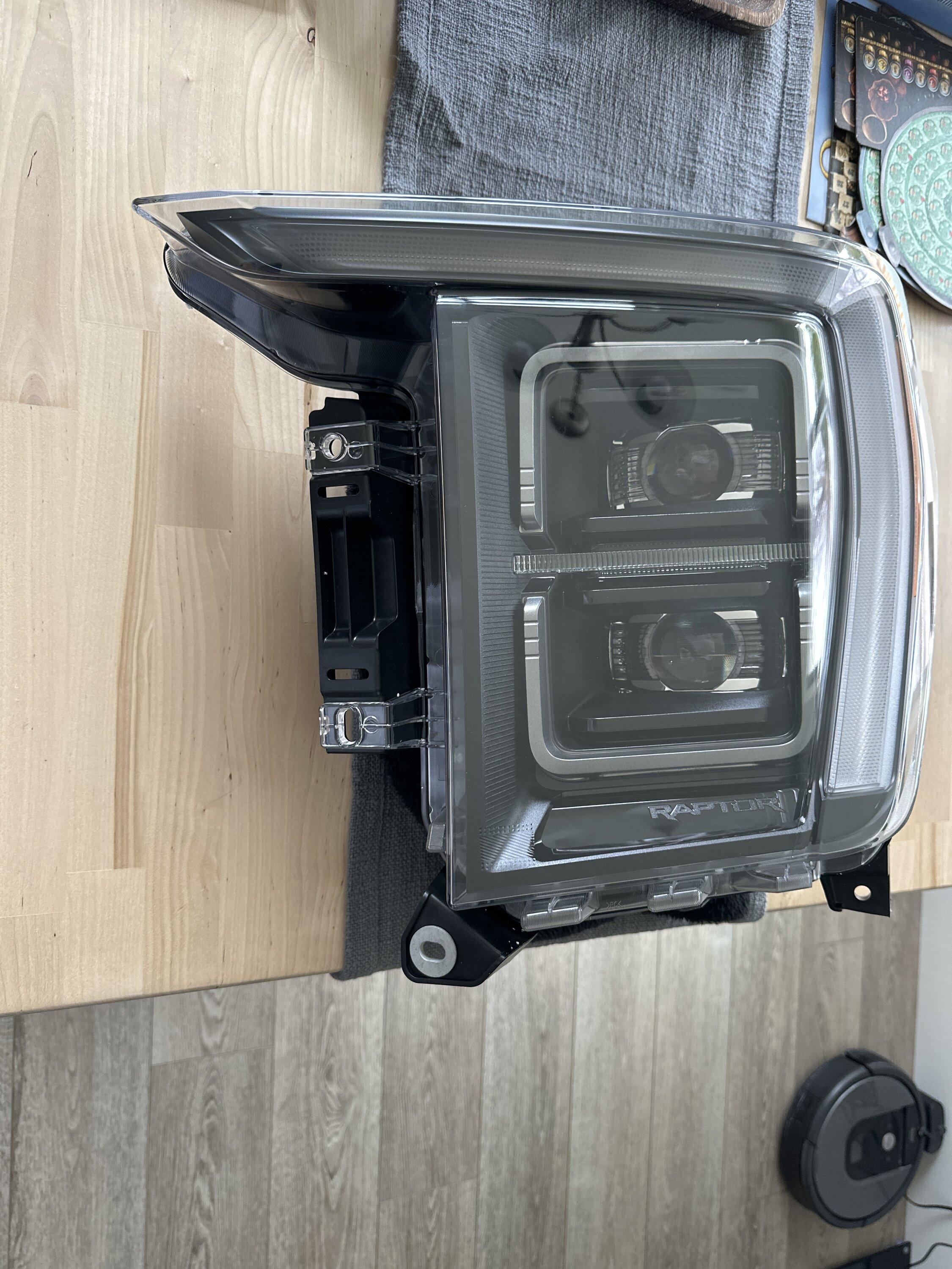

I actually have a set of OEM raptor projectors that should be here tomorrow that I would love to get working.
I have another set of the 800A raptor reflectors coming as a fallback, but I would prefer to get the projectors up to that 90% mark or even a 'functional' Hi/lo + DRL turn.
