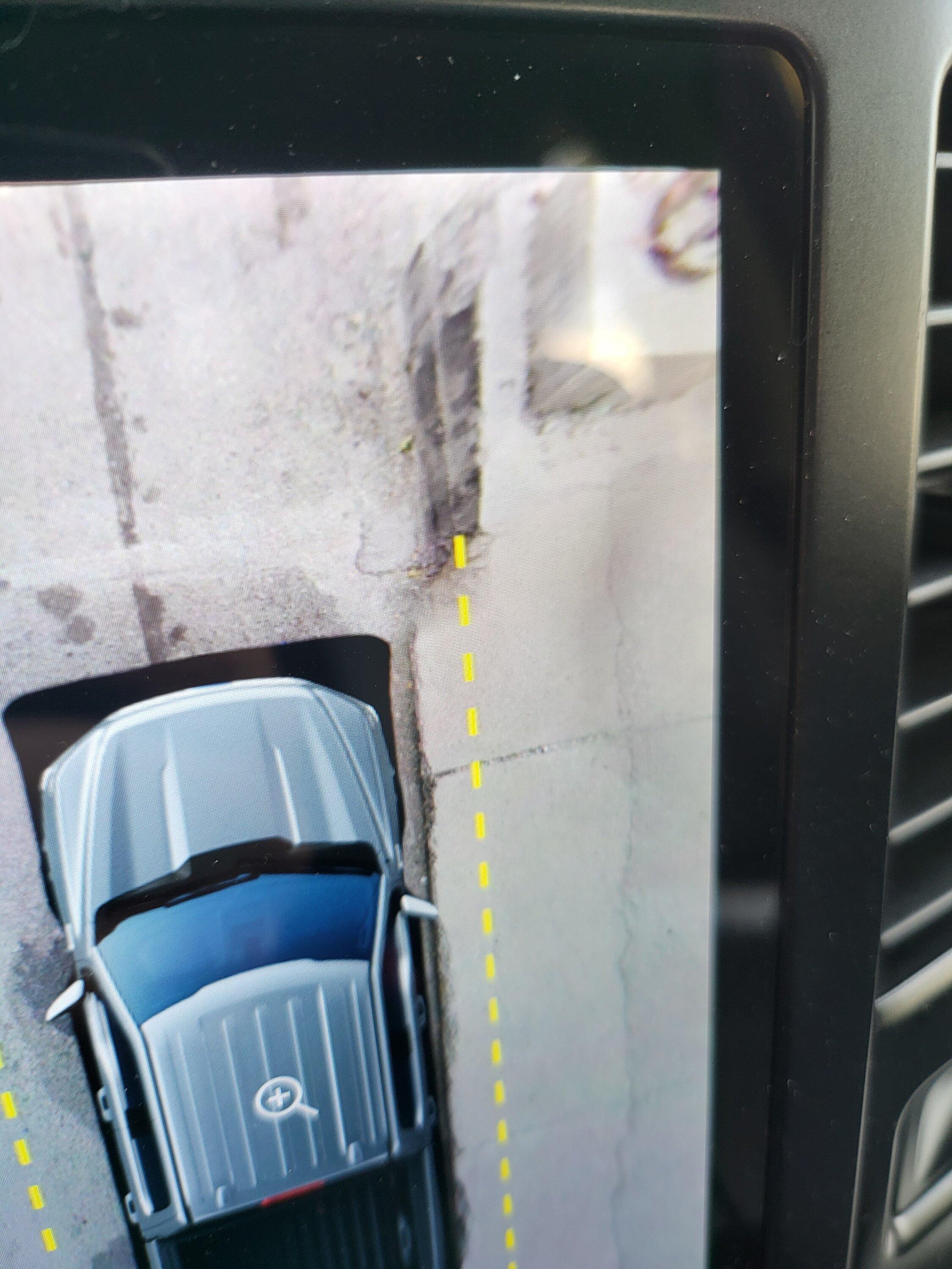

I have 2021 f150 lariat and it seems that my 360 camera system has an issue with right front side
see the below photos
any idea how to fix it ?

Did you try cleaning the camera lense? Rule out the simple solutions first.
Just use some water or a bit of dishsoap. Don't use window cleaner. Let us know if that helps.

I tried that before still same issue
My car had an accident on the rear right side with the original owner
maybe this issue is related to that ?

Maybe need to calibrate the cameras and IPMA. Your dealer can do it, or you can get FORscan and do it yourself if you feel tech savvy enough to do it.

Agree it just appears it needs calibration if mirror is well mounted and straight.

Yes i have forscan
Did a lot of modifications throu it

Perform the 360 camera calibration in a well-marked parking lot. It will stitch the cameras together and rectify your issue.

I searched onyoutube how to calibrate the camera
it is not easy as I thought
