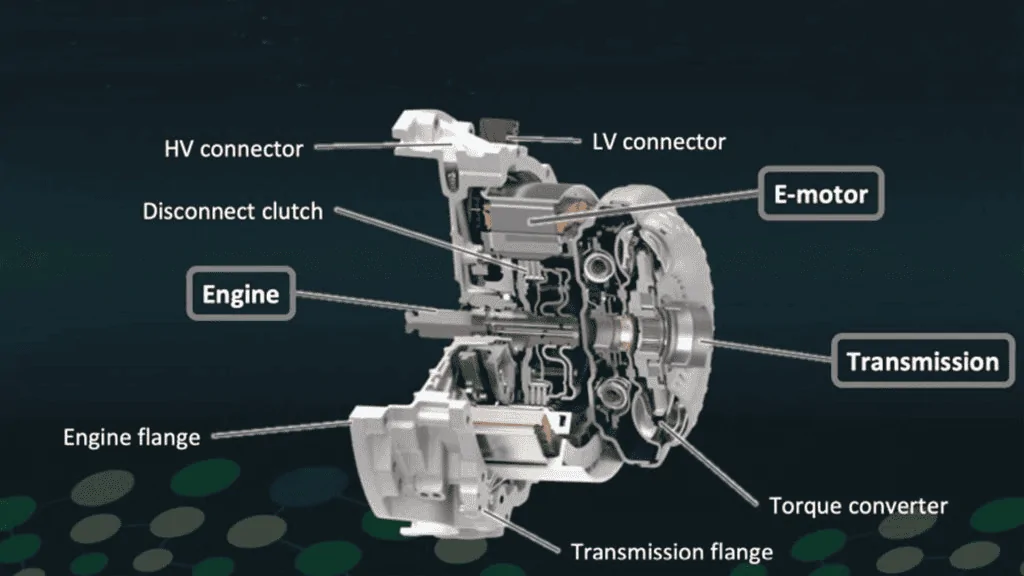

I found a nice depiction of the MHT(Modular Hybrid Transmission) Engine/E-motor/Transmission interface for newbies like me.

I think the hybrid is a MHT 10r80. All 10r60 references I could find are for the non-hybrid models ??‍♂

A TSB dated 5/30/23 made no mention of a 10R60 MHT existing. Just 10R60/10R80/10R80 MHT.
