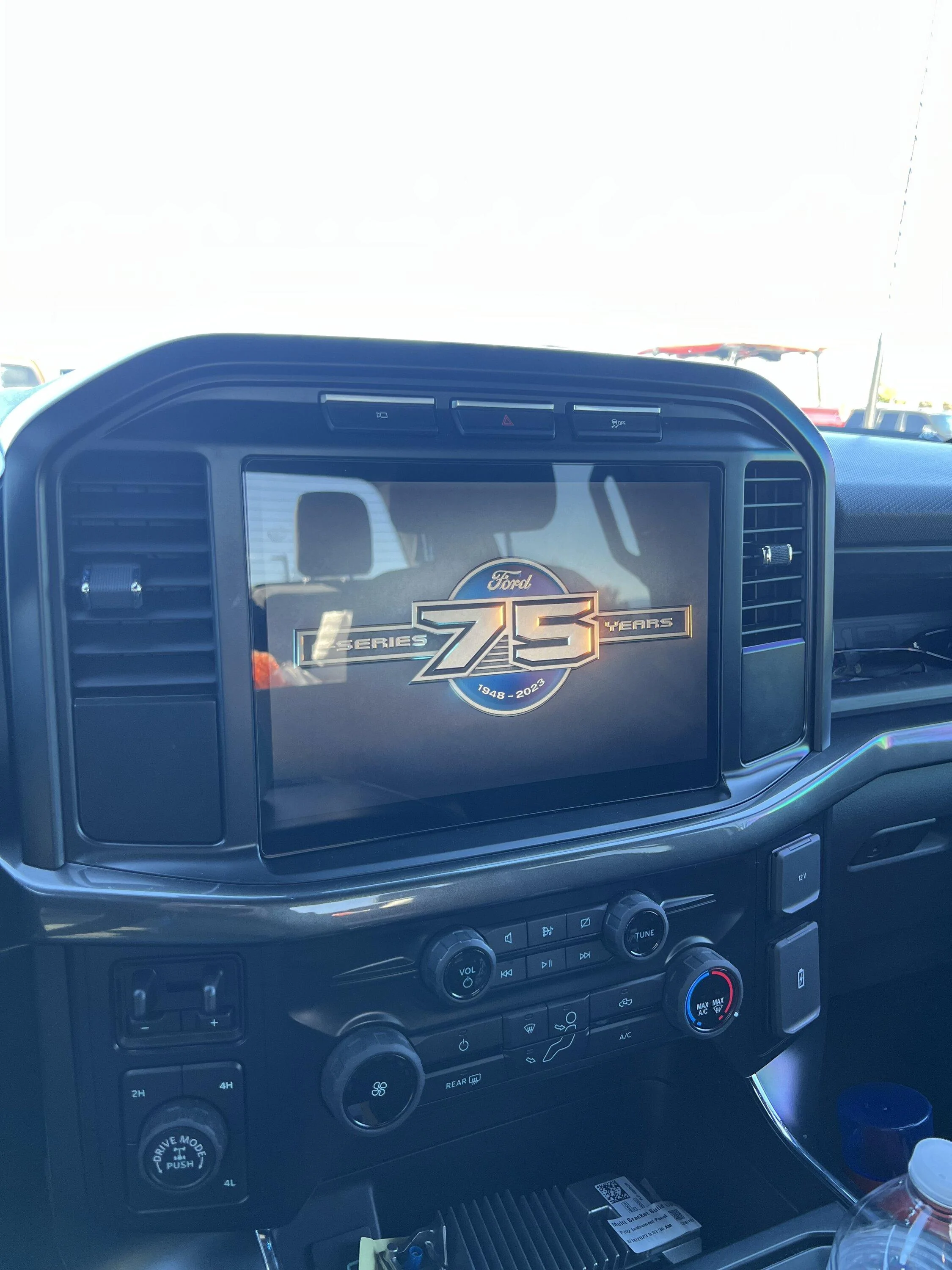

Ford F-150 Is programming required on the 8” to 12” radio swap? IMG_7106
I received the kit and put it in. They reached out and asked for my vin and picture of my existing buttons above the screen, before shipping it out and sent it to me preprogrammed. It all works perfect without any sort of hiccups or
Dummy buttons. Install was easy, I can’t say I wasn’t nervous about taking apart my truck with less than 10k miles on it, but all the parts were new & oem. Even the wiring harnesses they provided had the ford tags on them like the ones that they were replacing. I’d recommend buying from these guys 100%. I checked out infotainment and will be ordering the console shifter from them soon!
Glad youre happy. If you ever need anything Im the guy that programs and ships them out. Feel free to reach out
