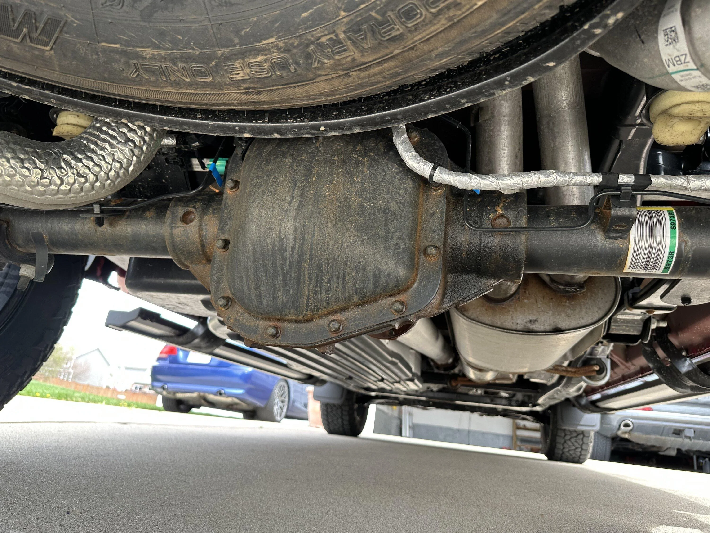

Just picked up my F150 at Granger yesterday. All went well- truck was flawless with the exception of some underbody surface rust. Could I use something like IronX to remove the rust here and on the axle ends safely and effectively? Any recommendations?:

..Looks like IronX is just detailing grade for painted surfaces; I used a product years ago for this kind of rust conversion and protection- but couldn't remember the name of it. I beleive it was this. I'll test on a small area and report back if it works as intended:

Although I would rather have no surface rust, we have had very knowledgeable individuals on the forum suggest that the surface rust is not an issue and somewhat provides a layer of protection. I don't know that I agree with that, but it at least makes me less concerned about it. With that said, I would be interested to see your review of whatever you use. CLR is supposed to remove rust, but I've found that it generally removes only a portion of the rust, and is limited in its effectiveness.

Yeah- that's true- but this converts and is supposed to inhibit future rust from forming- I've seen it work pretty well on other applications that are admittedly not exposed to as much of the elements as the underside of a truck- but it seems worth a shot as it's no risk and realtively quick to apply. I will surely let everyone know if it's even moderately effective.

Finally got a chance to apply this today after weeks of some wet weather here. Pretty satisfied with the results with very little prep work. Basically just a pressure wash of the area and some light steel wool on the axle ends with heavier rust. First picture is before- and the 2nd picture is after 2-3 light coats dried for about 6 hours. Still needs a little work- might try a couple more coats to see if I can get the heavier rust completely converted- but MUCH better than when I took delivery:

If it's just surface rust, which new trucks should have (well, shouldn't) -- use the rust converting black paint spray paint after cleaning it. It's ~ $9 / can at walmart.

Yeah, I’ve used those products before- really work well; my only issue is I’m lazy and didn’t want to mask anything off before doing these touch ups. This converts the rust as well as protect against future rust without reacting with any of the other areas- and where the rust was relatively light it’s now a nice satin black.
Still-like you said- the rust converting paint is pretty nice for anything heavier than this I think.
