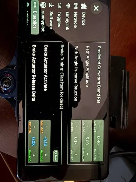

I will send you pictures of setting but
My in lane factor is 0.00
Lane change factor is 0.60
Predicted curvature blend rate is 0.40
Path angle amplitude 5.00
Path angle in curve reaction 0.17
Brake actuator activate -0.14
Brake actuator release delta is 0.08
It's some time change lane aggressively and also some time do cut lines while curve on road
Switch to the “low“ profile. Increase lane change factor to 0.72

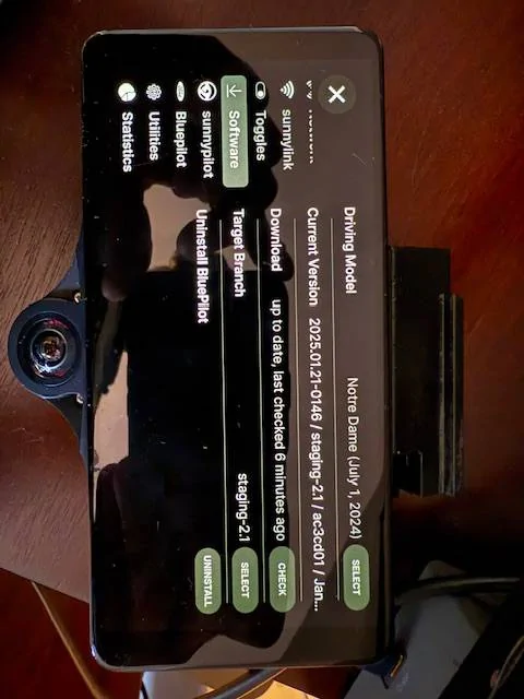

Let me know if there is anything else worth sharing or if any of this is unnecessary in the future

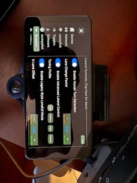

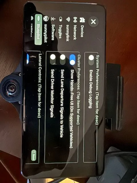

These are the two useful pictures. Do you feel like the ping pong is fast (less than 3 seconds side to side) or slow (sometimes called a wander)?
More slow, almost like a boat slowly rocking back and forth. I can even see my wheel turning all the way till I almost get to the lane on one side then doing the same the other way over and over
