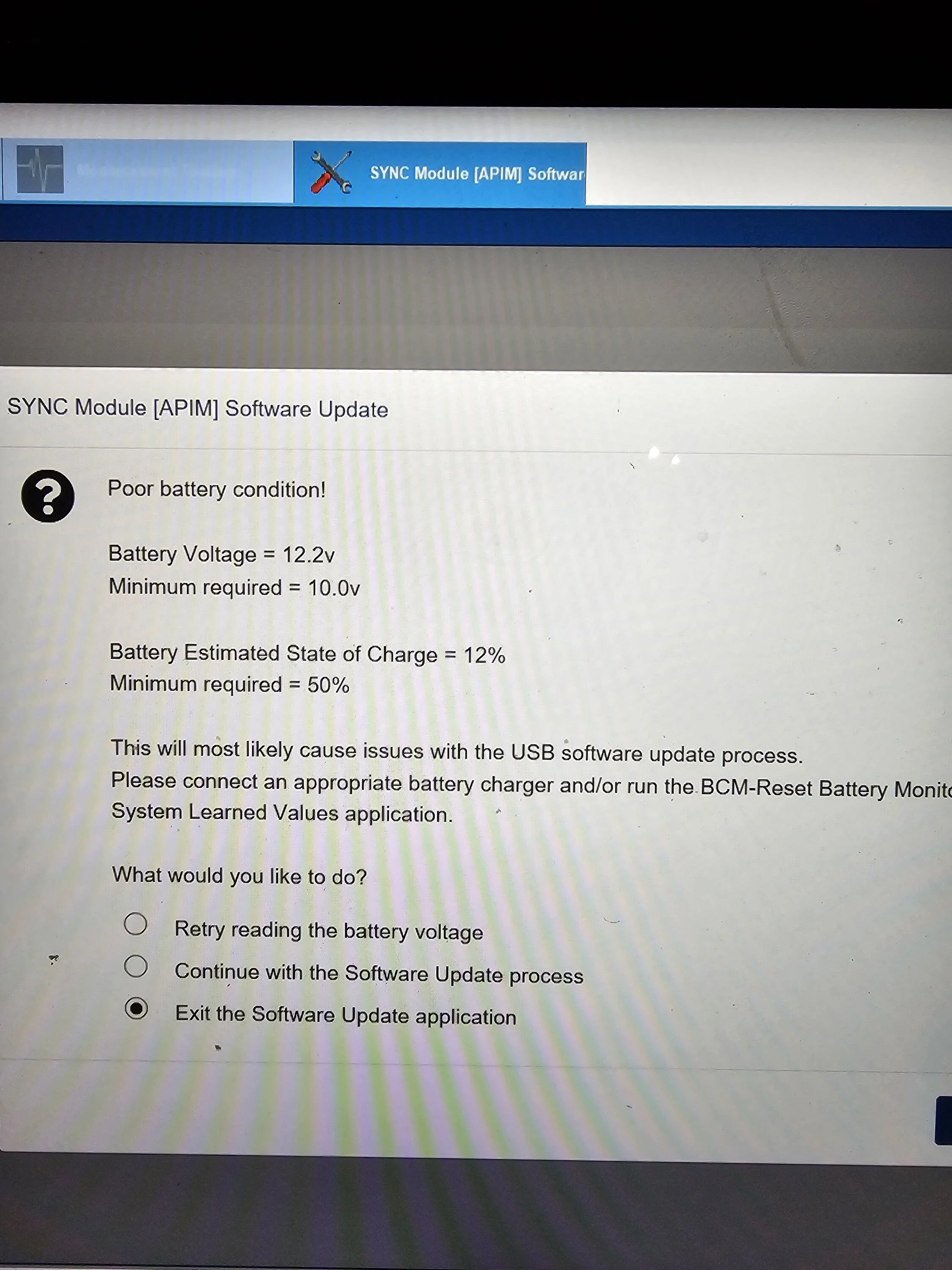

Here is something new. I tried to rerun the ipma update. When it started it came back with an error that said I have poor battery condition. State of charge 12% needs 50% I have a 40amp charger on it. Always had . I have cables attached to the battery terminals. Not the battery monitor cable. It should read over 12 volts?

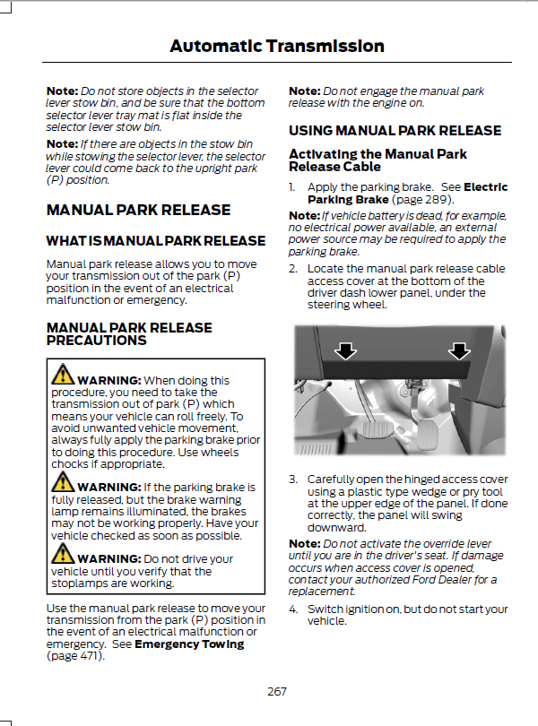

My biggest problem now is I can't get it out of park. I need to move it out of the way to get my other truck out.

I can't figure out how to move the gear shift lever. Pressing on brake won't release it.
Page 288 of the manual tells how to manually release the shifter.

Piping in with little to no experience here, but if you're charging directly to the negative battery post, the truck won't 'see' the charge.
I never thought about that. Thanks.
Is the manual available in fdrs?

I'm sorry and disappointed i didn't see your offer last night . I stopped working on it and had to finish the brakes on my 2016. I needed a truck today. I finally got the hybrid moved by putting it on casters.
Sorry, it's pg 267-269 for your year (mine is a 2021). You should have a manual on your truck in the menu on the screen. Also, you can download the whole thing in PDF from here
https://www.ford.com/support/vehicle/f150/2022/owner-manuals/
