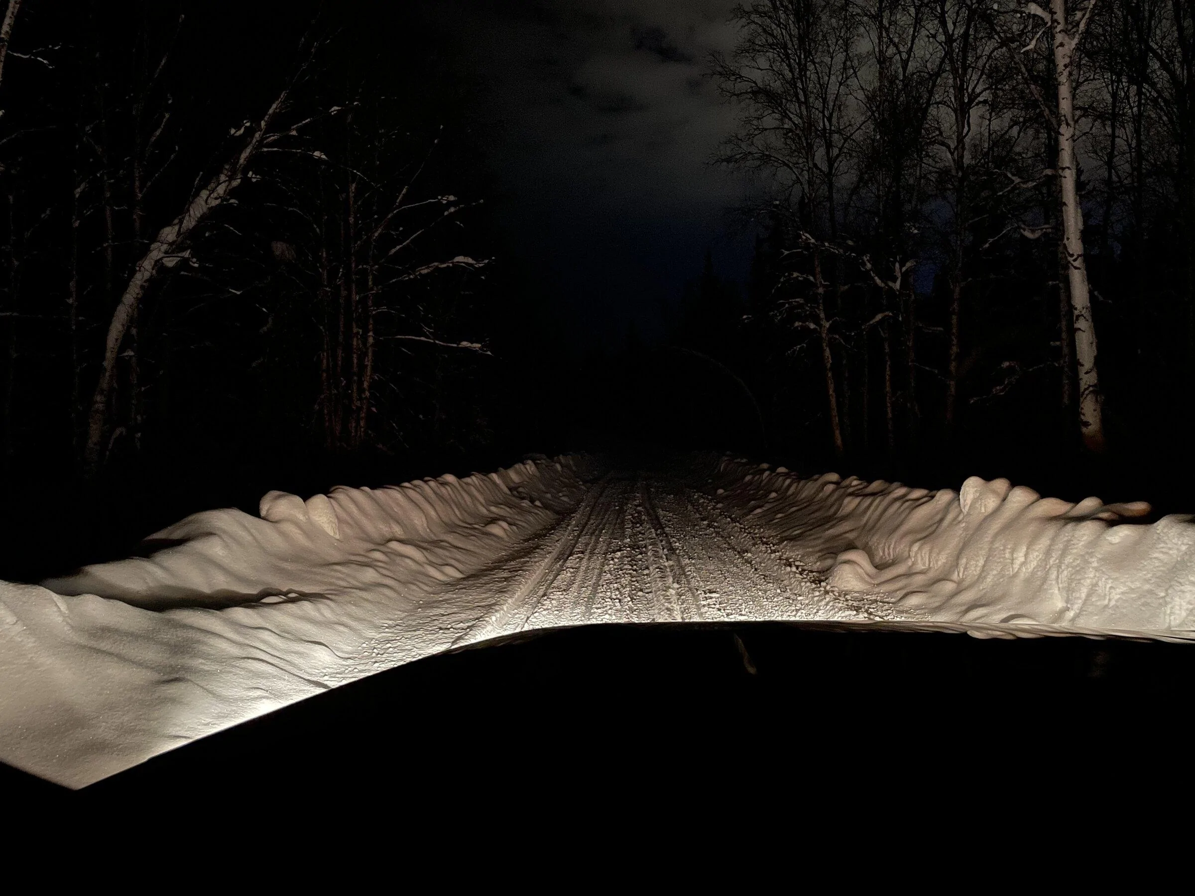

I picked up my 2021 STX Tuesday night and like many of you I noticed immediately that the forward lighting isn’t great. IIHS rated the halogen headlights as Poor due to a lack of distance projection both down the road and to the sides.
Most people immediately think “These lights suck! Time to throw parts at it and try to fix it!” But what if they didn’t actually suck. What if they just weren’t aimed properly?
As delivered:
Ford F-150 How-To: fix your Headlight and fog light aim! D3866D97-97B2-40FE-BC34-ABAB1D0564BC
Lows only

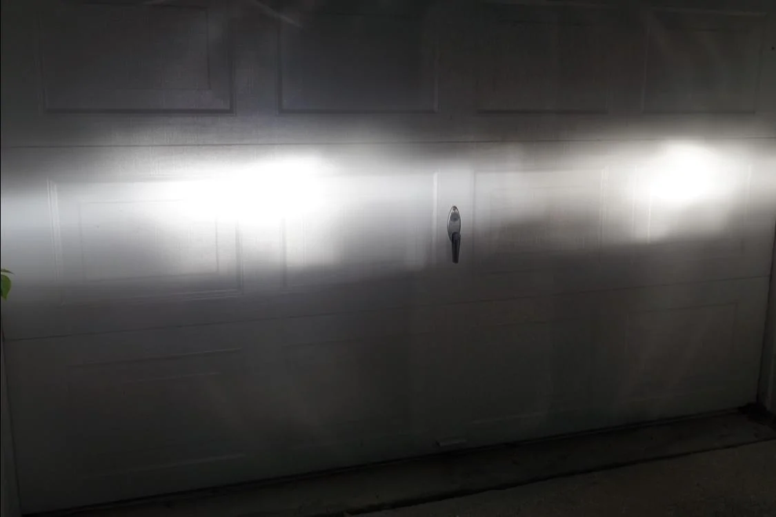

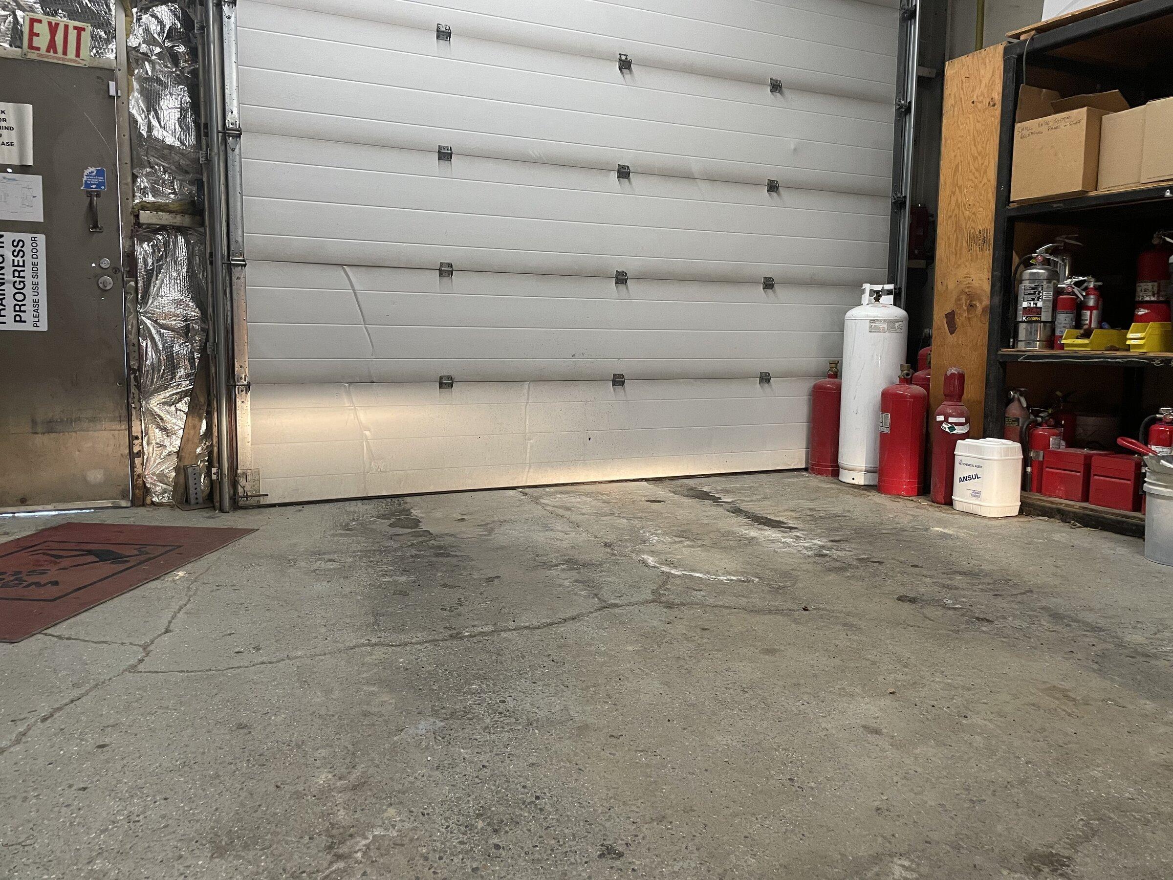

Ok, let’s investigate. The standard for fog lights at our truck’s height says the cutoff should be 3” below the height of the bulb at 25 feet. I can only pull in 15 feet at my garage at work, but it’s clear the fogs are no where near 3” below the stock 24” light center!
Ford F-150 How-To: fix your Headlight and fog light aim! 49FDF117-DCFE-409E-9618-757492DCDDD8

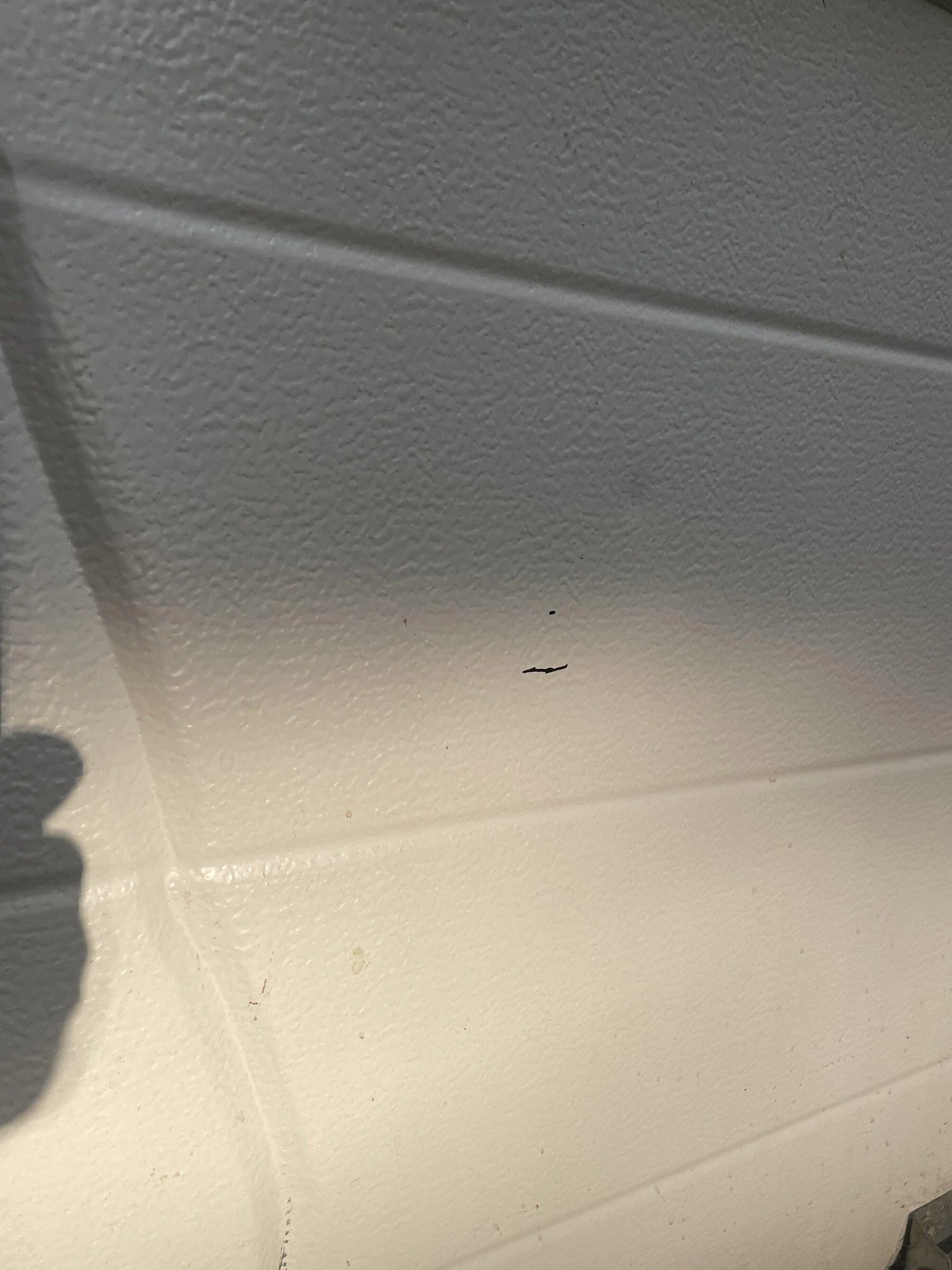

Headlight aiming is explained in the owners manual, but basically the top of the hot spot should be at the same height as the lamp center at 25ft. On my truck that’s roughly 40”. Measure your truck, then measure to the top of the hot spot on the right side of the pattern. My trucks lights were at 38” at 15ft, also low.
Ford F-150 How-To: fix your Headlight and fog light aim! 54225068-2196-4FF5-B1D0-1E70562E3738
Use these adjusters to put the headlights where the need to be with a #2 Phillips screwdriver
Ford F-150 How-To: fix your Headlight and fog light aim! 539D027D-6848-468B-8AA9-7D53958DE6C7

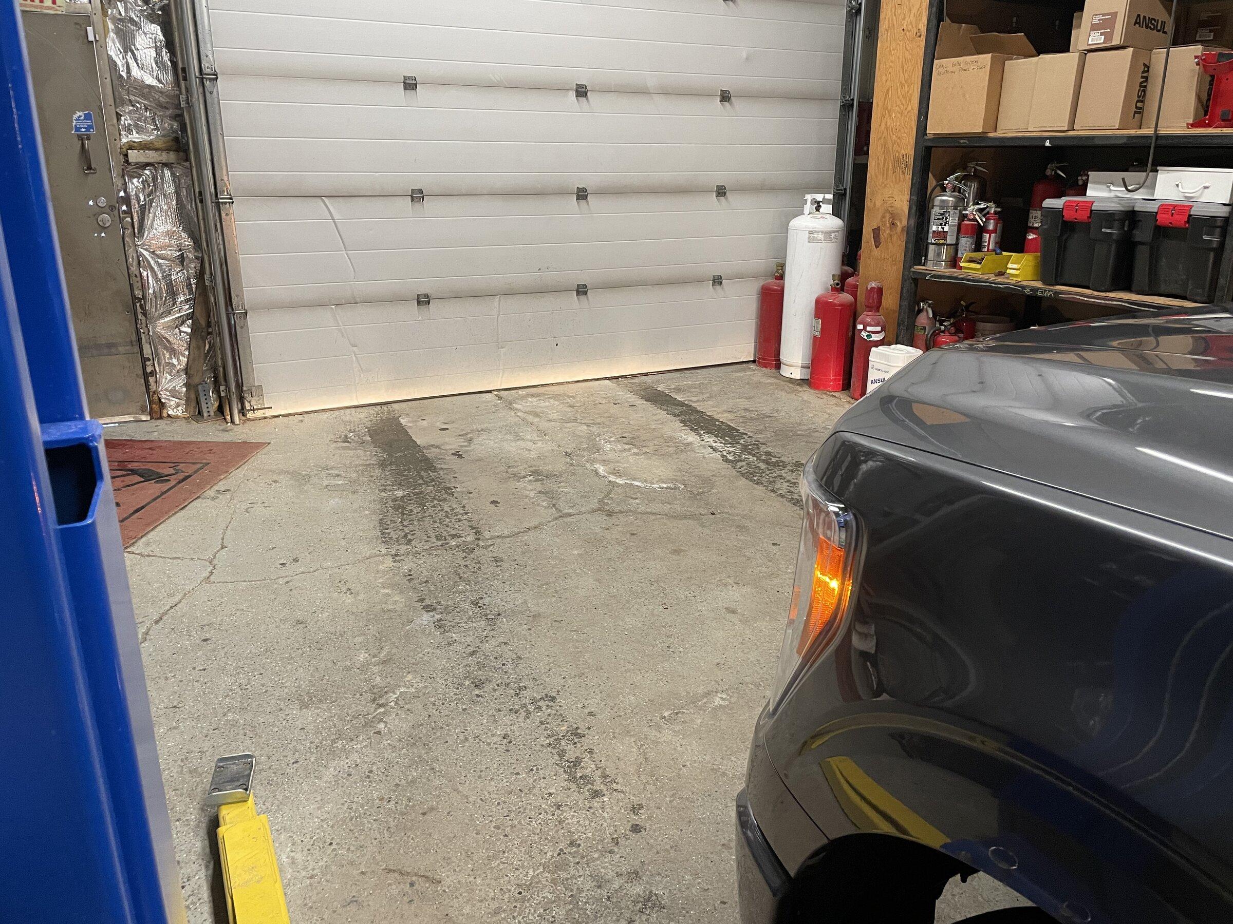

an example of how I made my aiming marks, bigger is more accurate but this worked for me.
Ford F-150 How-To: fix your Headlight and fog light aim! 7CA488E7-F831-4C64-BBB9-3EC86CC3DE76

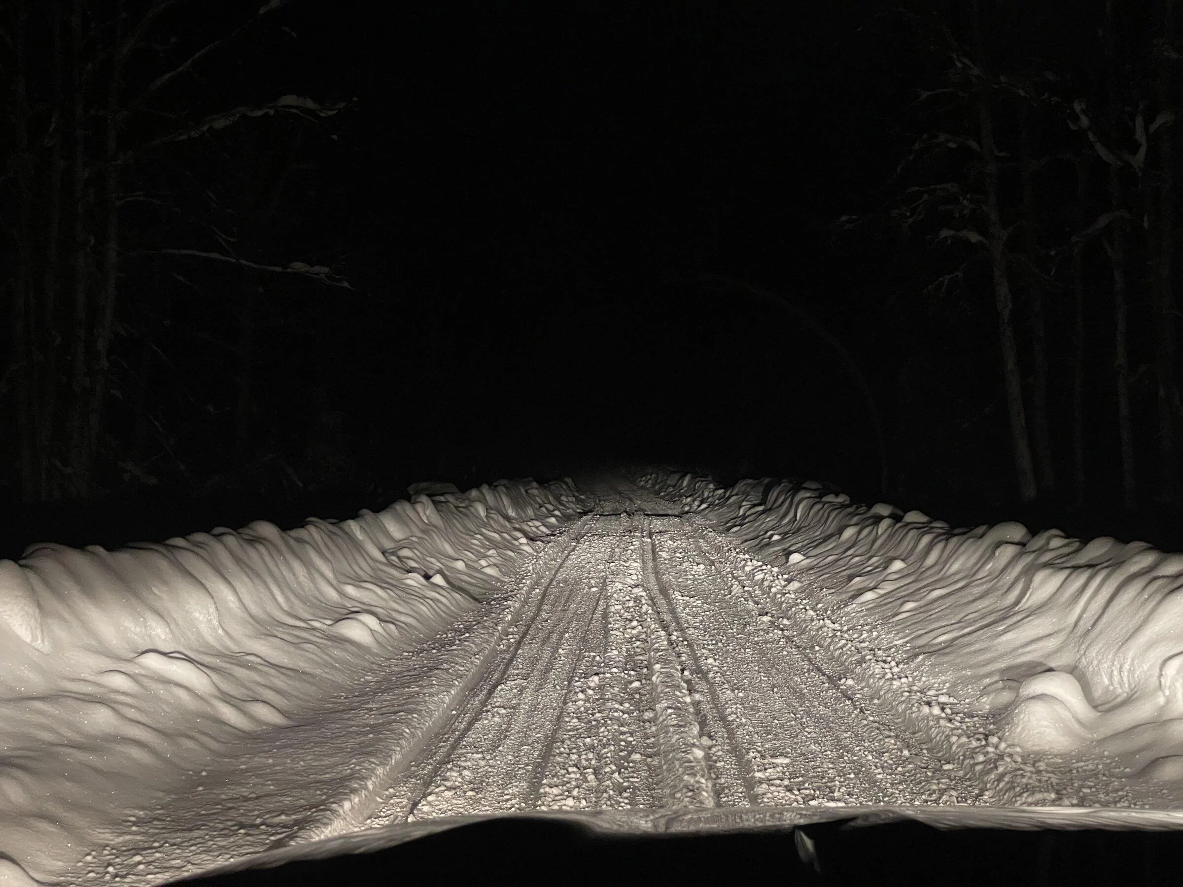

the results?
Fogs only:
Ford F-150 How-To: fix your Headlight and fog light aim! DB9B45C9-A7B8-4CC2-B8C0-DD97BB698083
Lows only:

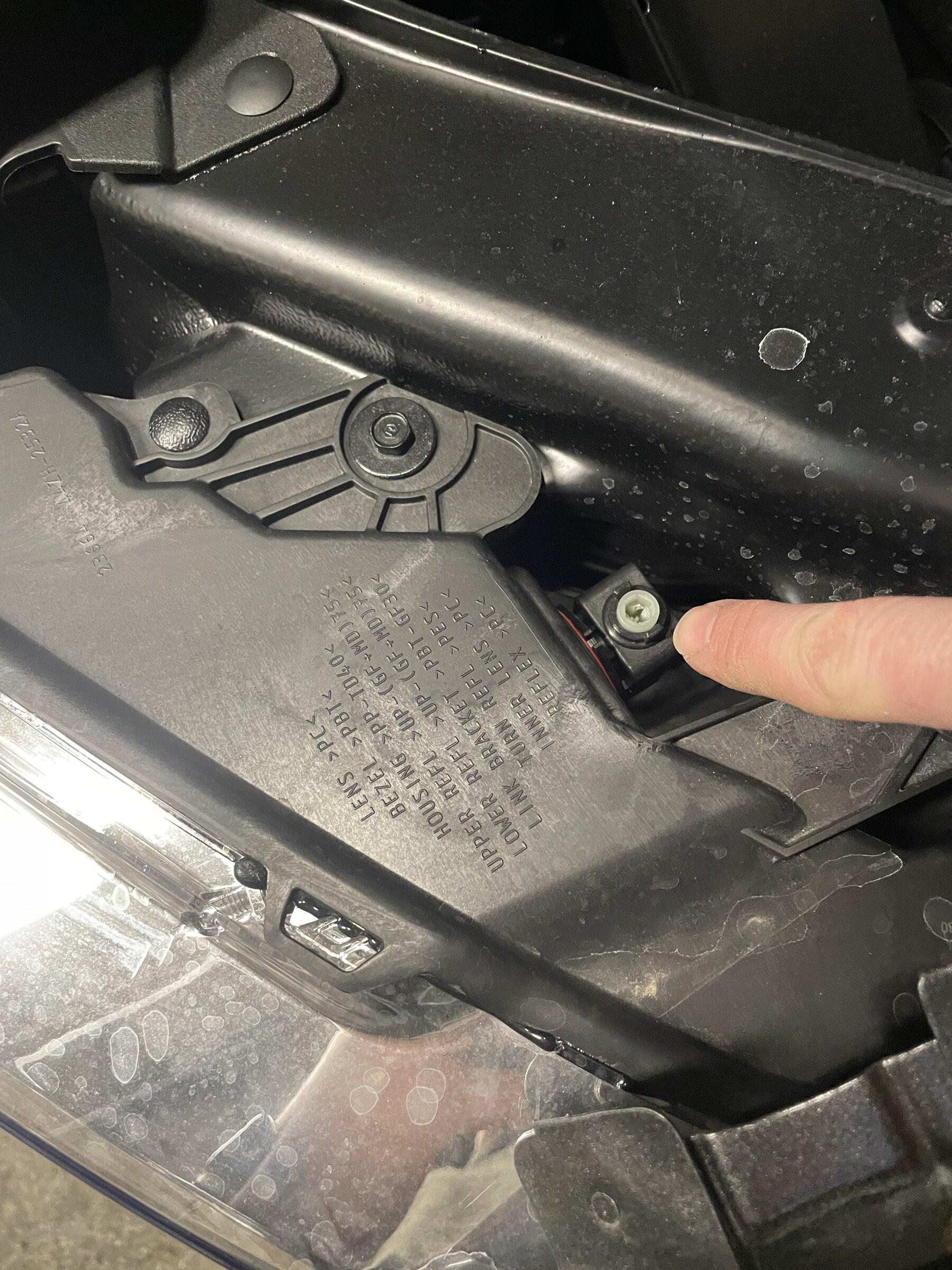

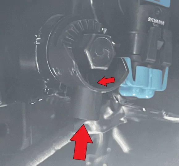

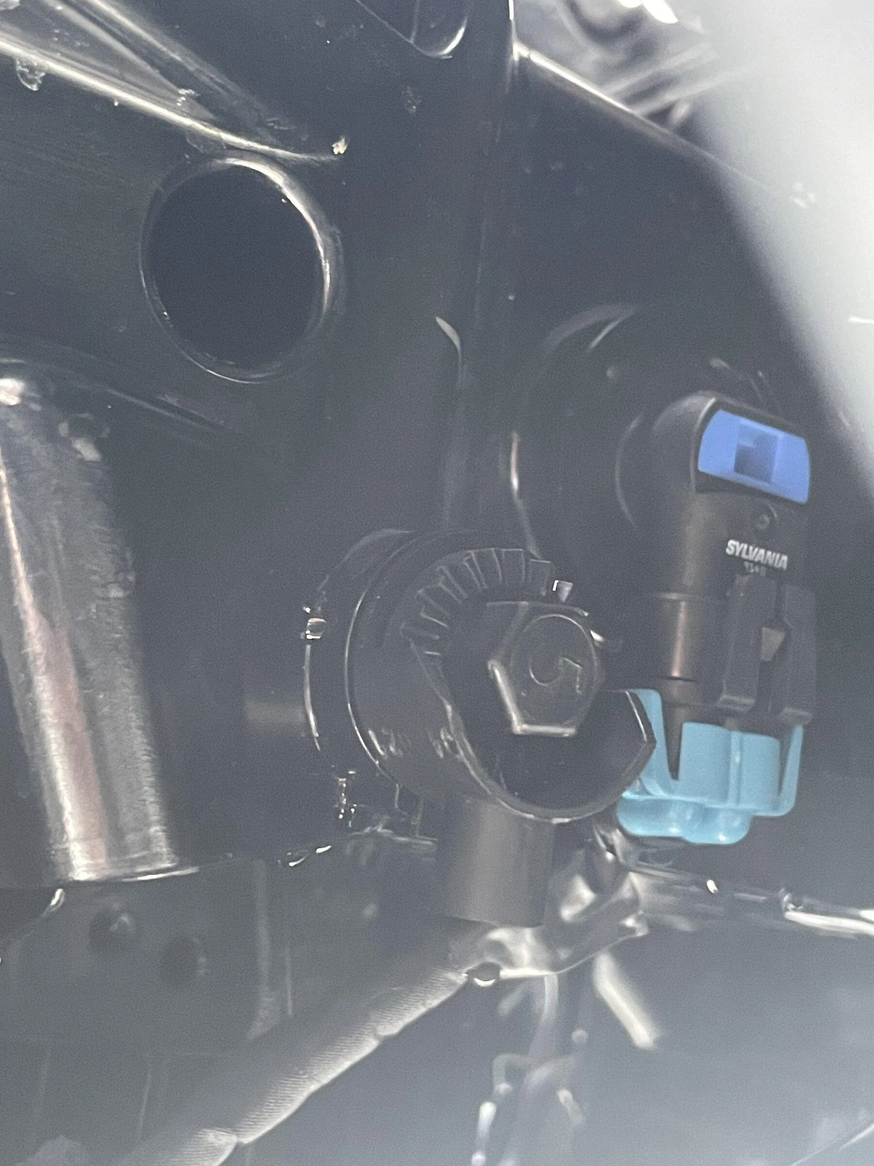

Found this write-up looking to verify the process for my LED fogs (different adjuster), and just wanted to drop in a possible tip.
There is likely a screwdriver interface in this lower tube that turns the gear teeth on the outside of the larger 1/2" hex. Helpful if you don't want to pull back your fender liner.

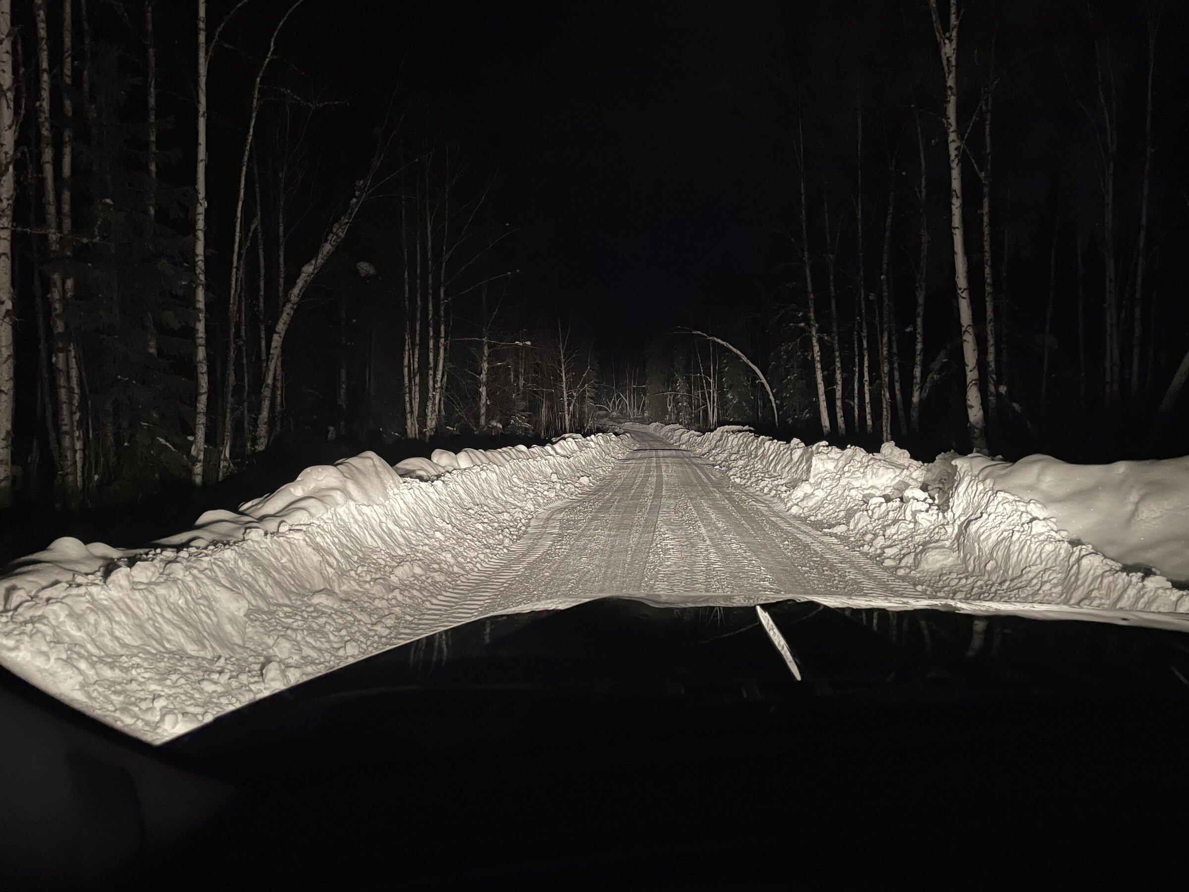

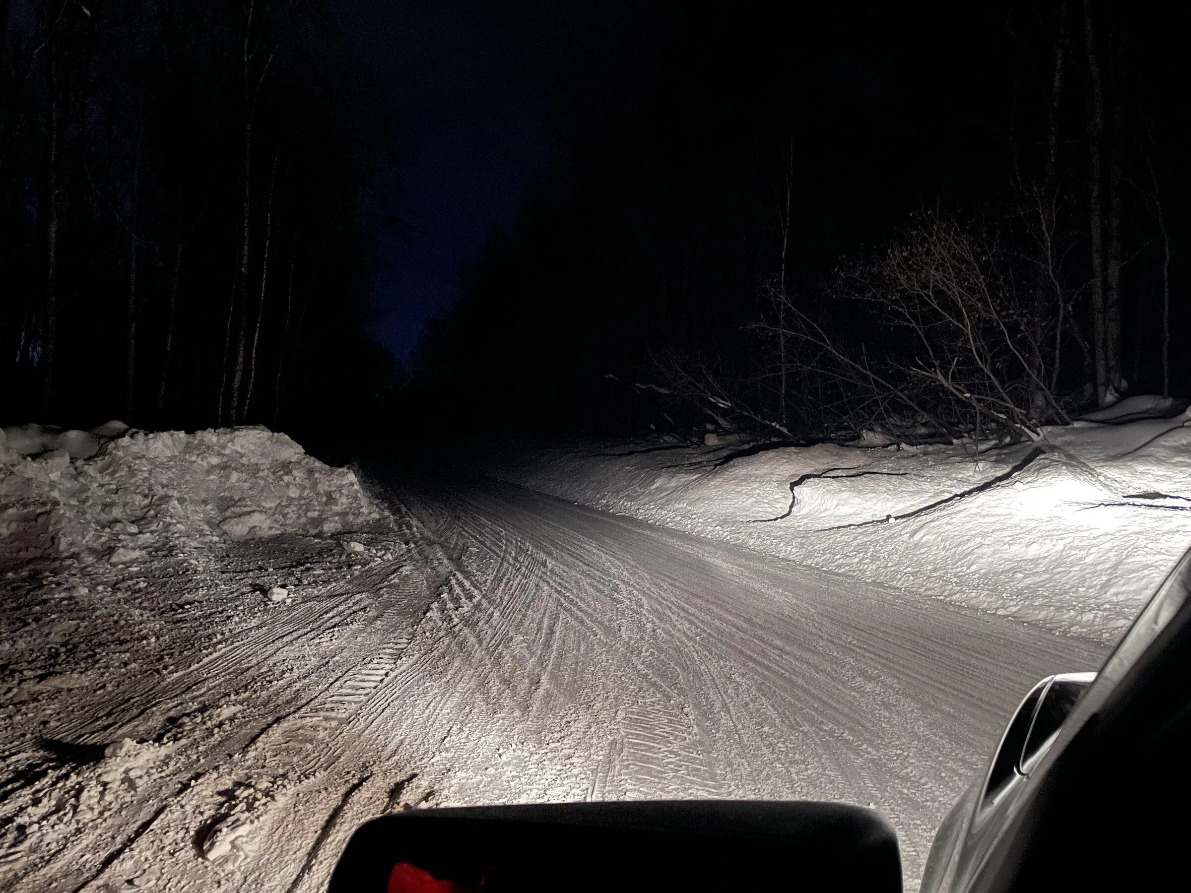

Just did the same mods to my truck. The fog lights were pointed straight at the ground from the factory, absolutely useless, however my headlights were actually aimed too HIGH. The cutoff was above eye level on some smaller SUVs, and that was UNloaded.
After reaiming I still wanted to improve the dingy yellow light output. Based on the stock beam pattern LED bulbs are not an option, the beam pattern lacks the focus and cutoff necessary for LEDs. Even if LED bulbs could perfectly recreate the stock beam pattern (which they won’t) it would still be unusable. So I went with the H9/9011 upgrade. The bulbs I got were Hella H9 2.0, Philips crystal vision 9045, and standard Philips 9011. I’ve seen people speculate that new 9011 don’t have the true HIR coating and are just high watt filaments, but the glass had an iridescent look to it unlike standard bulbs so I don’t think that’s true.

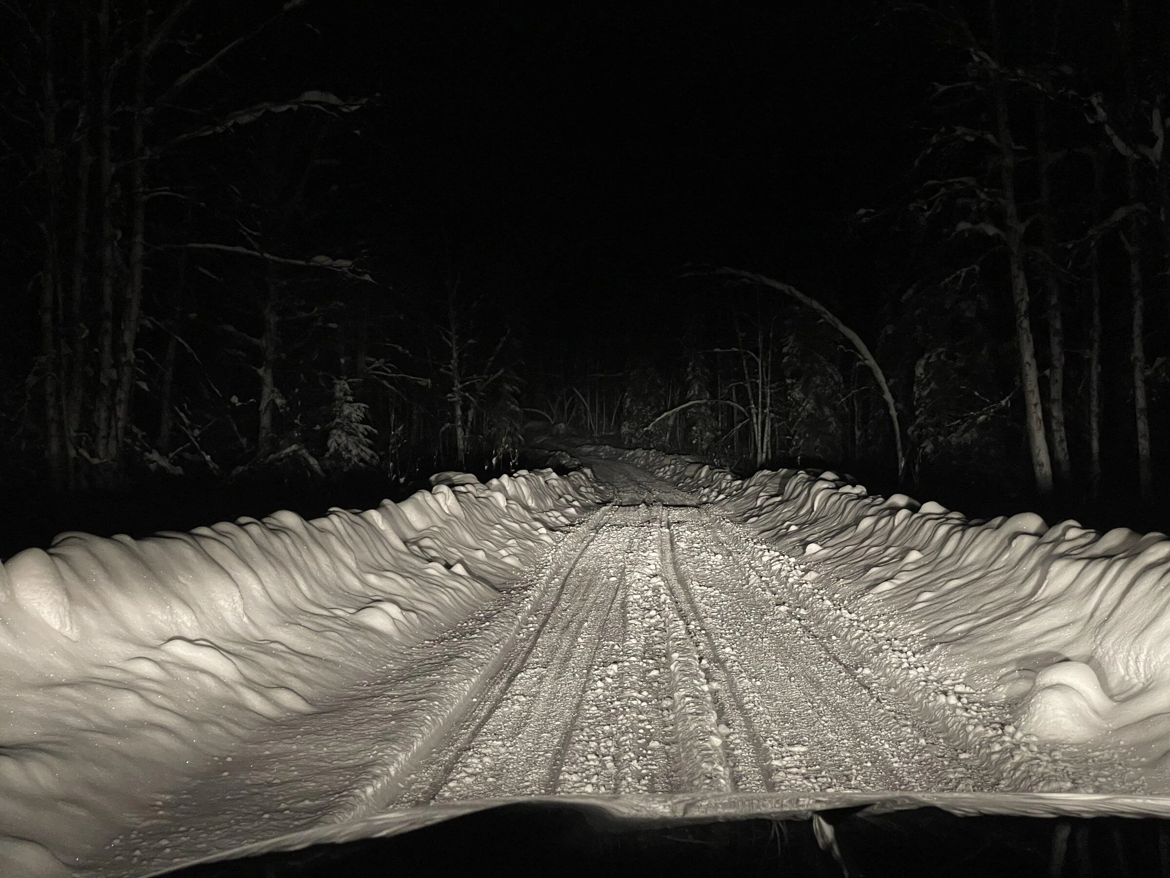

There was certainly a huge improvement with the better bulbs, you can see here lows/fogs and high beams. Upgrade bulbs on driver side.
Ford F-150 How-To: fix your Headlight and fog light aim! IMG_0370
Ford F-150 How-To: fix your Headlight and fog light aim! IMG_0371
The new bulbs have a much whiter light output and a fuller beam. Actually driving is where the difference is most noticeable, vision is much better due to the better color quality. No increase in glare, looking at the lamps themselves you can’t really tell the difference.
