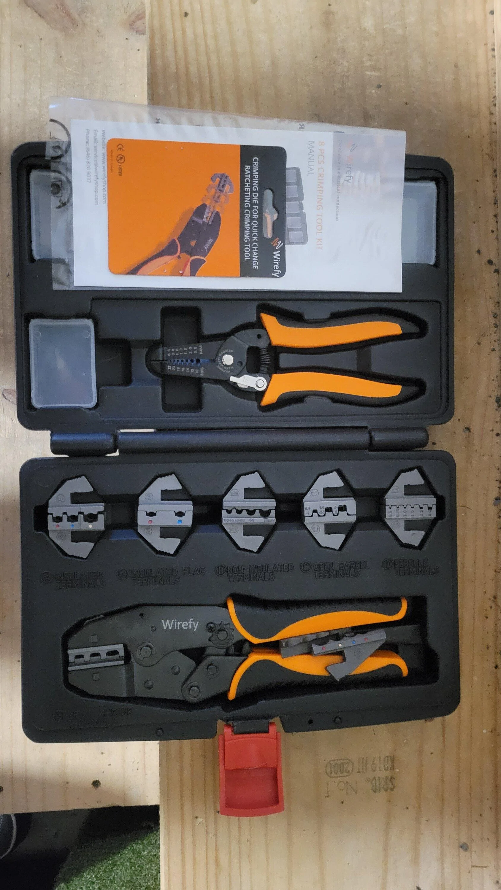

Any recommendations? Molex wants $500 for theirs
I got this set from Amazon along with some additional dies. Definitely not professional grade, but it works for my needs.

I got this set from Amazon along with some additional dies. Not professional grade, but works for my needs.
Awesome, I don’t need professional either, lol, just effective. YEARS ago I had a 1990 mustang GT hatchback and did some wiring work and had crimpers that didn’t work well. It’s a big part of the reason I’m so gun shy with electrical lol. I had a ton of electrical issues out of it AFTER I started messing with it. Young dumb and 18-19 at the time
