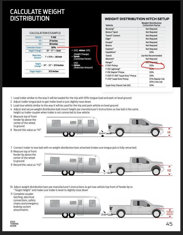

Follow your WDH instructions on setup and make sure you set your truck using the Ford setup. Get the 2023 Ford Towing guide....
Ford F-150 How Important is able GAWR 1725042976202-hk
Pics?
I did primarily use this guide along with the hitch manufacturers instructions. I’m going to go through everything again to recheck everything using the information you guys have provided and see where there’s room for improvement. Thanks for the input. Unfortunately the cell signal is too weak to include a picture. Will send that later.

Ford F-150 How Important is able GAWR IMG_5923
Only pic I have.
