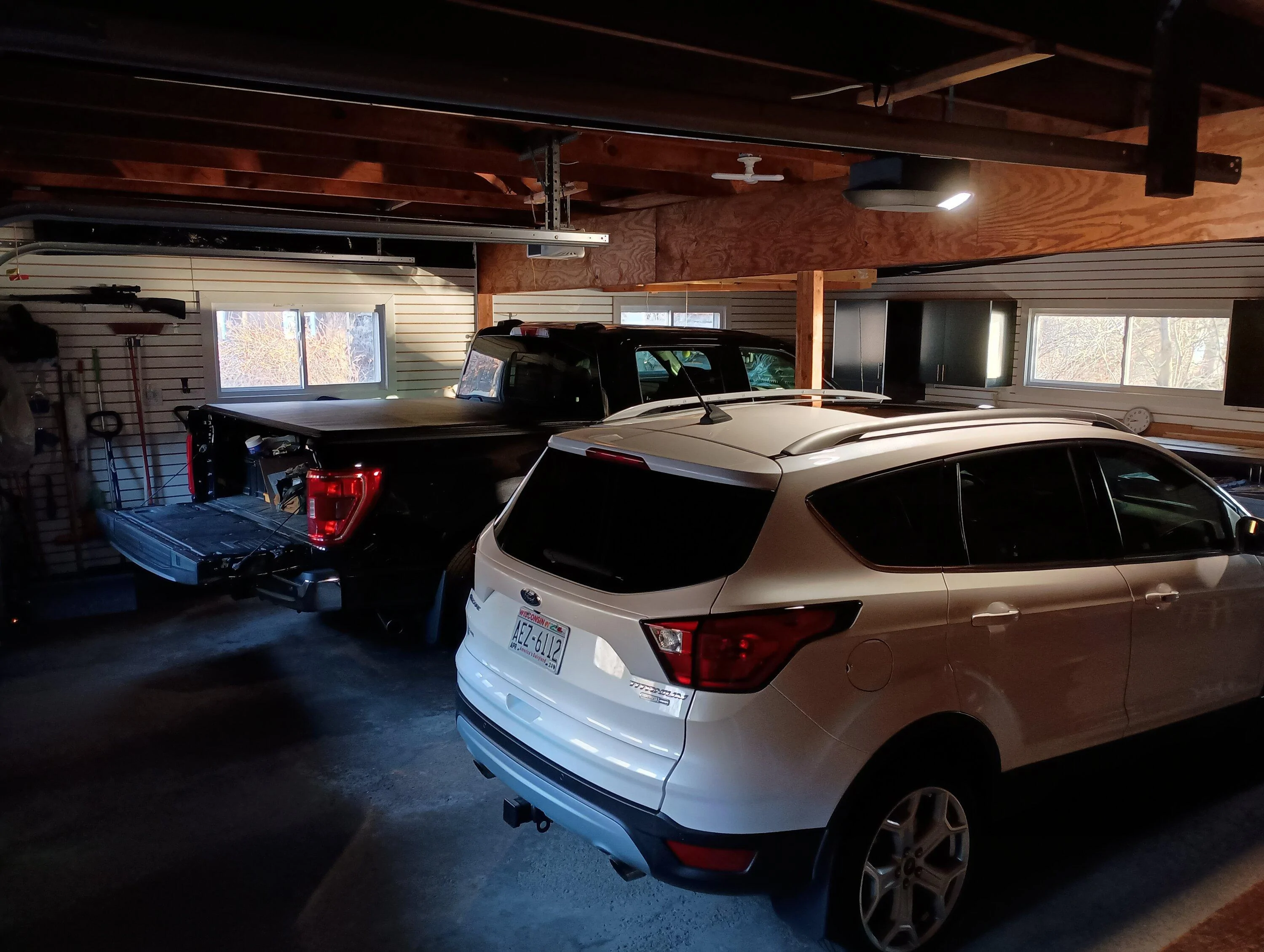

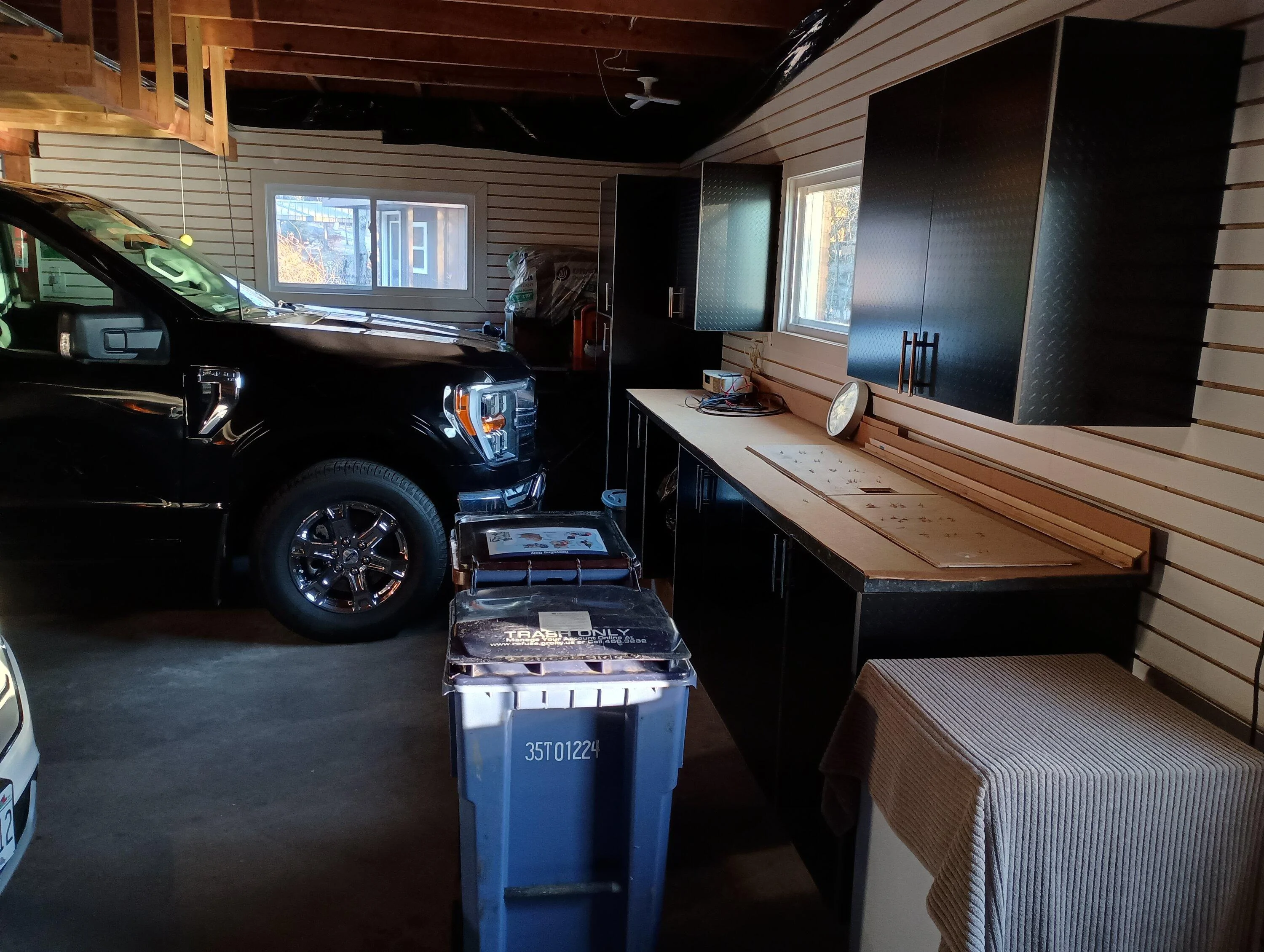

The wife an I are in the beginning stages of a reno/addition and am looking into a garage. I'm curious to see what sizes you guys have. I'm thinking at least 26'x26' and I know everyone says the bigger the better but, I think that's as big as our property will allow. Anyway, ideally I'd like to be able to open at least 1 vehicles doors and some room for a workbench, any thoughts
A Screw 5.5 box truck will fit with some room, a Screw with a 6.5 box will be tight and the only work room would be in front of the non truck stall then subtract 36" for a service door your left with about 8' for a work bench.
Go to your local zoning officials and find out the real facts.
Here we can go much larger when attached to the home but limited to 1200 (30x40)square feet when detached. But a detached can be closer to the property lines than when attached to the home.
Present attached garage on a ranch type home built in 1973 the attached garage is 26Wx28D. Enough room to have a cabinet system and just room enough to check the oil on a 22 Screw 5.5' box truck. 6.5' box would be very tight and one would have limited access to open any cabinet doors.
Here when building a detached garage we were limited to 1000 detached and built because of location at 24Dx40W year later they upped it to 1200 square feet. Today just shake my head not having that 6 extra feet.

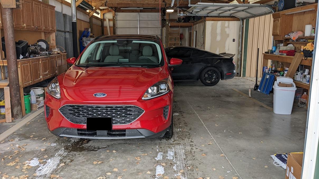

When the wife and I moved to Nevada, we really wanted some shop space to park our vehicles out of the sun/weather and have room for my tools and our projects. We lucked out big time! The measurements escape me at the moment but it's a "T-shaped" space that can fit 3 vehicles of almost any size comfortably with 4 in a pinch. We have another out-building that can easily fit a very large truck or two small cars. It's hard to tell from this angle but there would be enough room to park another car or small truck on the other side of the Mustang.
