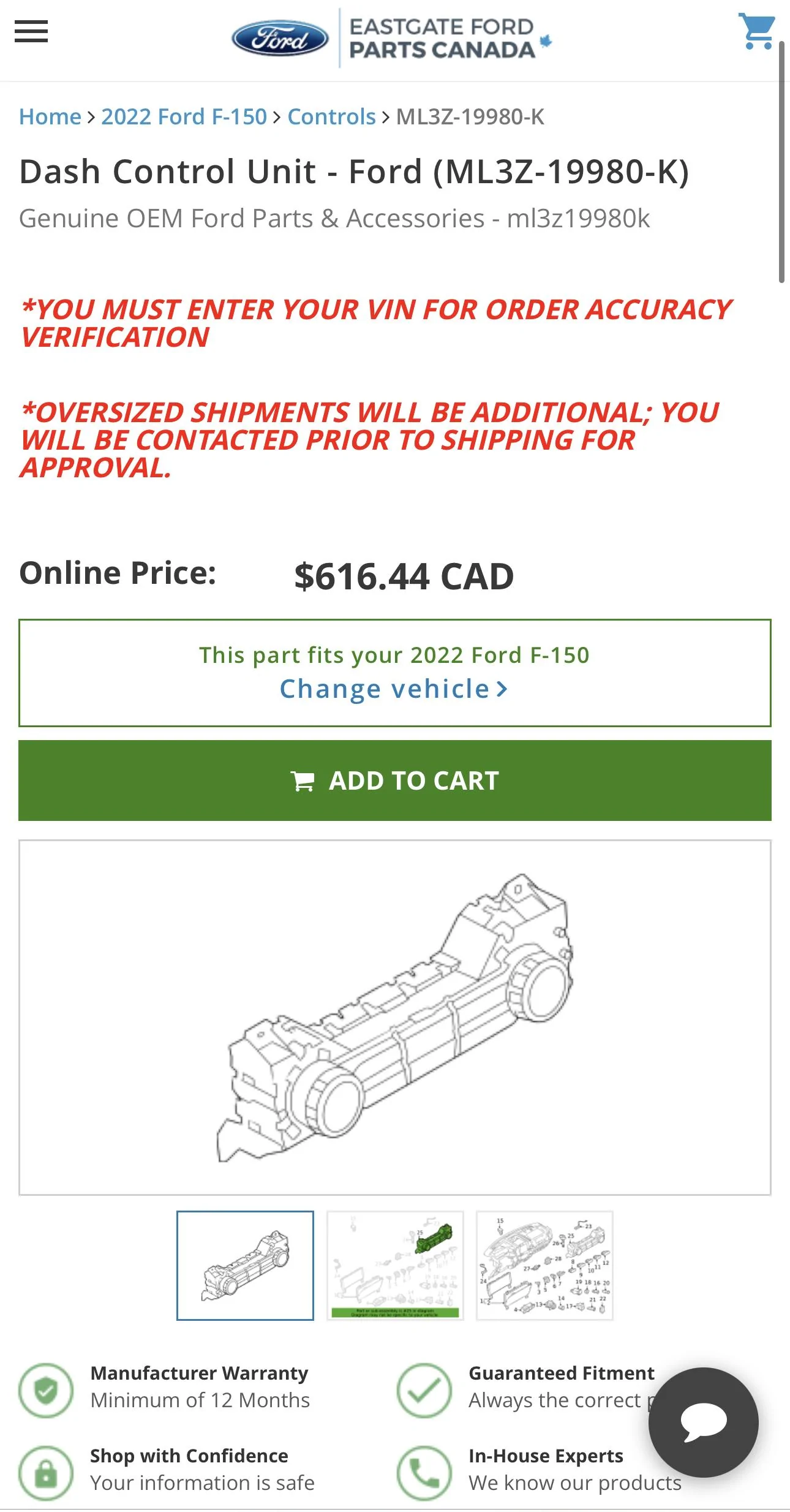

Well boys, looks like Ford jacked up the pricing by $400-500 from its original pricing of the HVAC around $150-160 (this is for those in Canada); for those in US I see the price went up as well.
This is for those looking for the HVAC change for heated steering wheel hard button, might as well find a used one or just add a button through the Sync 4 screen.

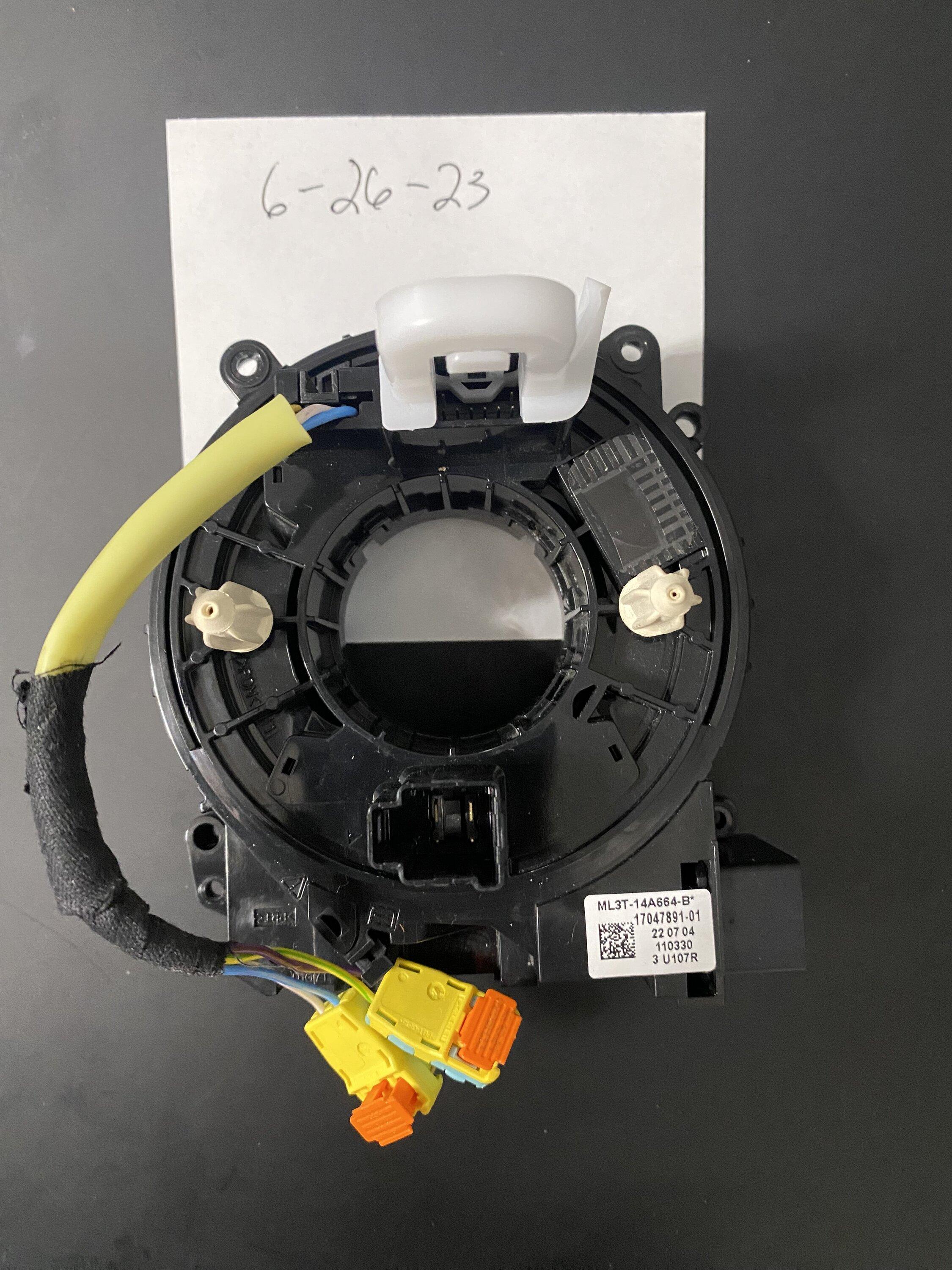

If anyone need a clock spring I give an extra one that Iam selling. $75 shipped.

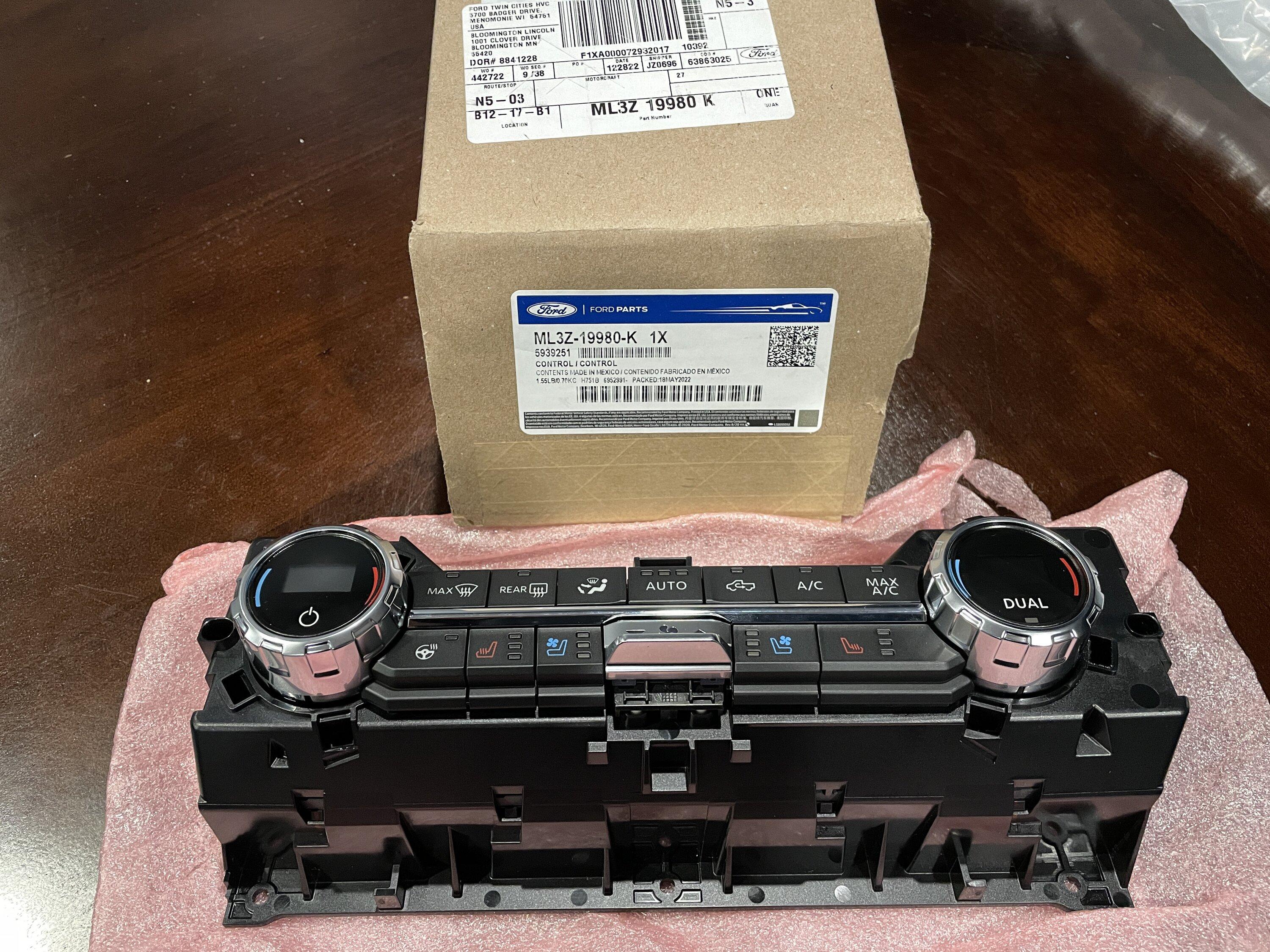

I received the HVAC module today and will be installing this and the SCCM in the next few days.
In the meantime I have put together a spreadsheet of changes I intend to make in forscan to enable the heated wheel and heated wheel with remote start.
These changes have not been tested yet. The list was compiled using As built explorer and referencing livnitup's forscan spreadsheet. @Livnitup looked at it this afternoon and offered additional settings which are included.
My truck is a Lariat 500 extended cab 5.0 with heated and cooled seats w/o heated wheel
The comparison truck is a Lariat 501a extended cab 5.0 with heated and cooled seats with heated steering. Those changes are highlighted in yellow.
If you have heated seats only you should be able to also find the appropriate changes here, but i haven't highlighted them.

Put some type of tie on that so it doesn't spin. If the center point is off and someone installs it, the first time the wheel is turned it could end up destroying it.
