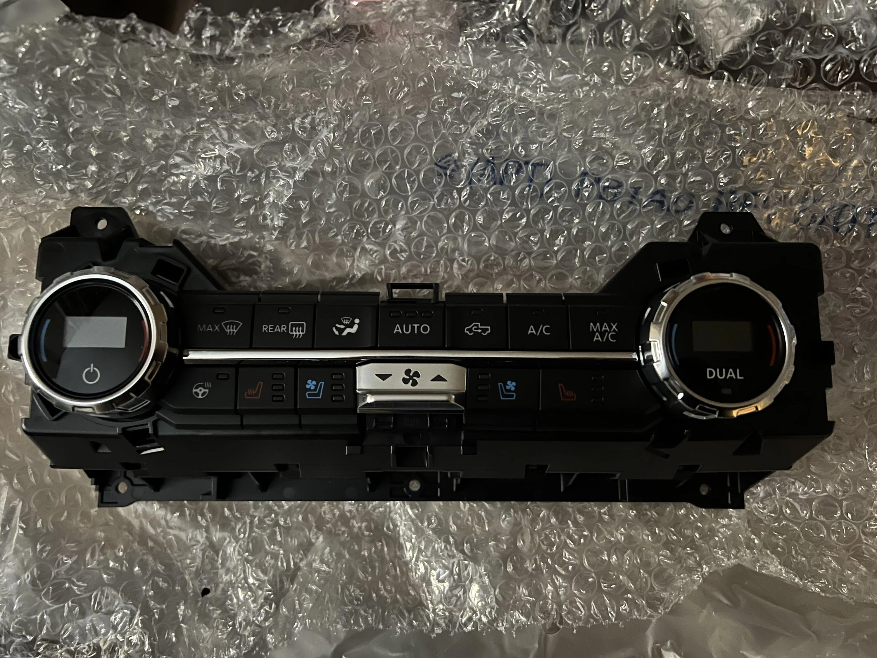

Part number for the HVAC unit with heated/cooled seats, heated steering wheel, and temps in the dials is: ML3Z-19980-K
Ford F-150 Heated Steering Wheel Retrofit - updated with information IMG_0600

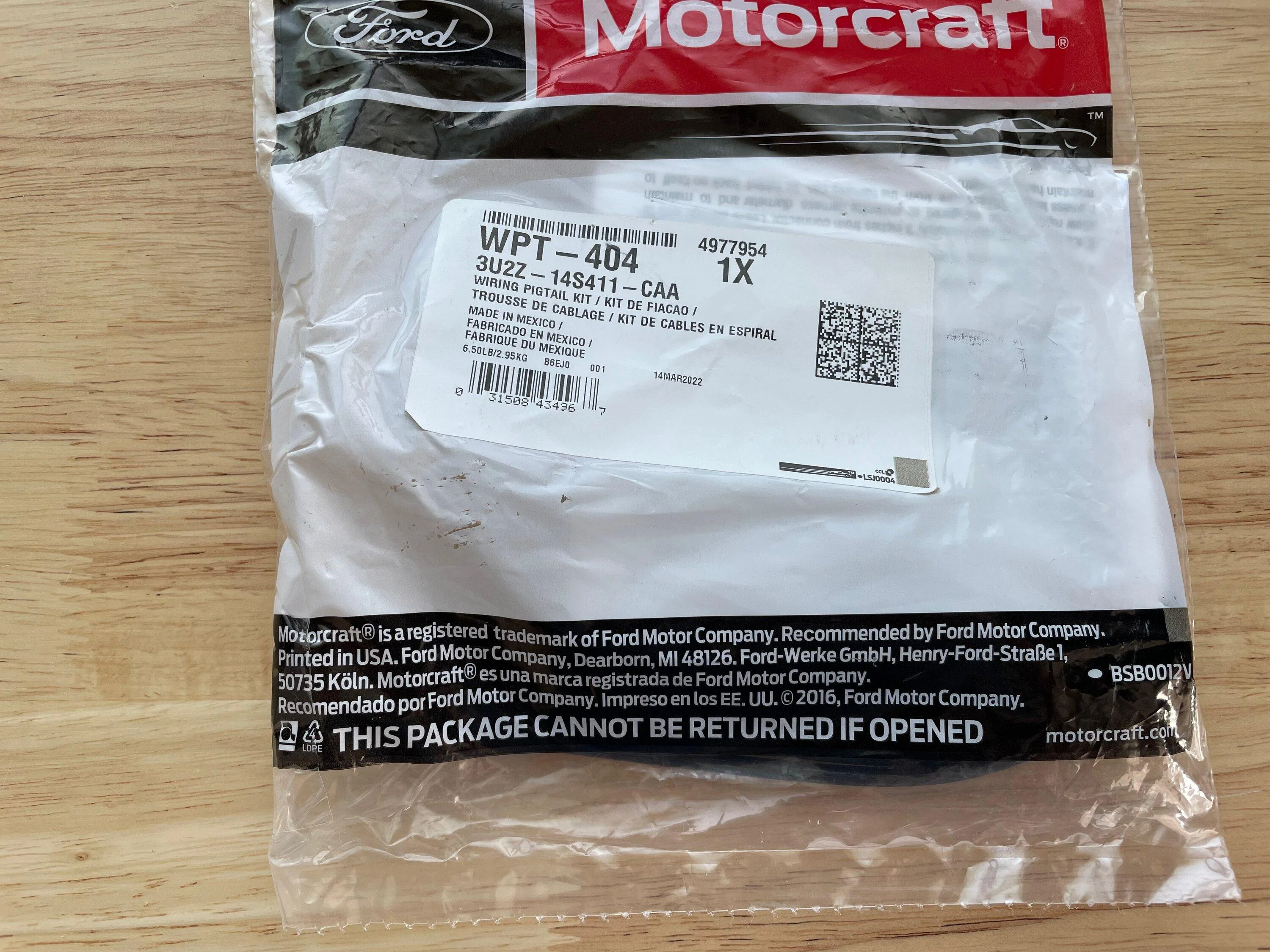

If anyone needs a WPT-404 cable i ended up with and extra one. $30 shipped
Ford F-150 Heated Steering Wheel Retrofit - updated with information IMG_3485 (1)

Could anyone point me in the direction of a ready made harness? Boosted Grey Goose has been out of stock for a while and I can’t muster up the courage to make my own as I feel I’d burn my truck down.
I can make one I guess.. I dont know it would be a big seller. It is only two wires. one ground the other runs to the BCM. It is probably the easiest harness to make.
Correct me if I’m wrong: one end will be WPT-404 connector from the SCCM, running 18 gauge wire (power/ground) to the BCM/ground point. WT-1004 is the terminal needed to connect power into the BCM?
Make the ground intercept something near the column -- the other one floating around is poo trying to intercept near the BCM.
