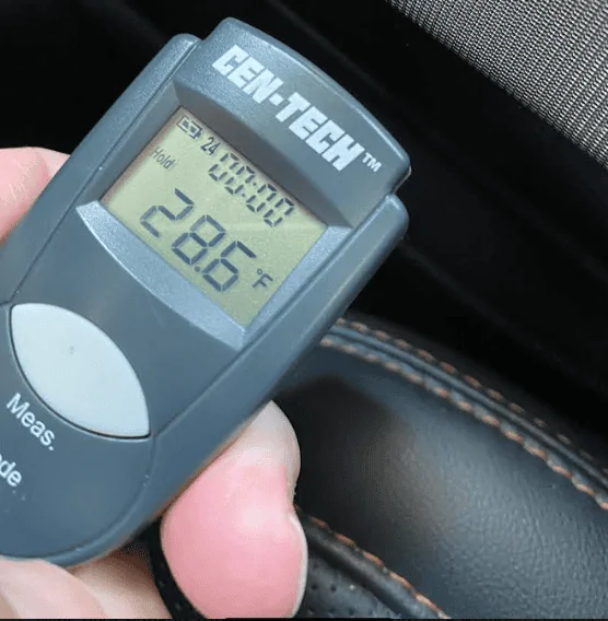

Remote start via key fob. 6 minutes run time. Truck bed in the shade about 25 degrees. HVAC Blowing warm(ish). Steering wheel almost 80 degrees.

Interior surfaces in general 28.6 degrees.
Ford F-150 Heated seats via FordPass 1705447080699
Some somewhat working. The seats used to get much warmer after a remote start. Something no bueno somewhere.

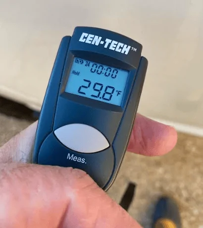

Truck outside body temp 29.8.
Ford F-150 Heated seats via FordPass 1705536571159

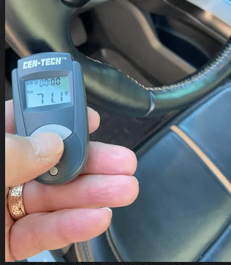

Steering wheel hot:
Ford F-150 Heated seats via FordPass 1705536636907

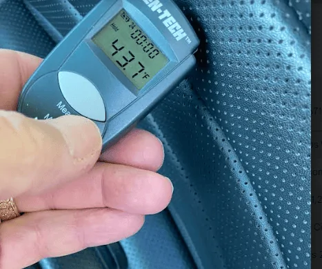

Seat back cool but not at ambient:
Ford F-150 Heated seats via FordPass 1705536793851

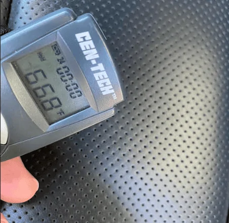

Seat bottom warmer but not "warm."
Ford F-150 Heated seats via FordPass 1705536865839
Speculation: So when you sit down on a 67 degree seat and a 44 degree seatback you are NOT thinking "This is nice and warm." Even the first seat heater setting is much warmer than this.. especially the back.
But the seat heating is in fact "working" otherwise the seats would have been about 30 degrees.
Maybe Ford is worried about seat temps or something and only lets the seats get marginally warm until the Start button is pushed. Maybe "Auto" is working as designed.. but less than desired... and we just don't know why.
But that speculation seems false to me as my butt fondly remembers warm remote started seats early in the ownership (2021). Anyone have any ideas?
