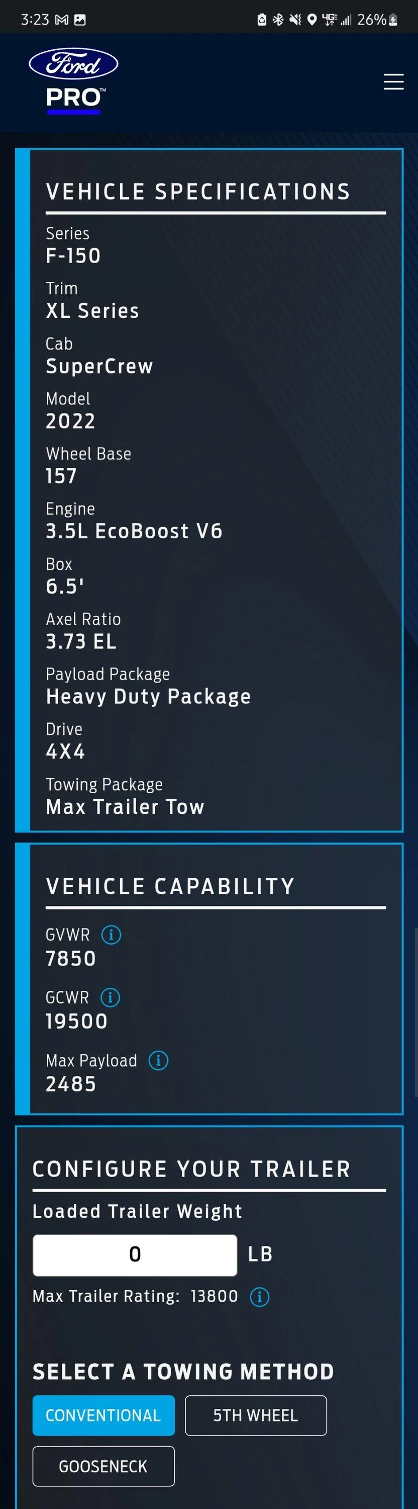

Attaching window sticker for options
Ford F-150 HDPP Build input appreciated Screenshot_20220825-083937_Adobe Acrobat
According to the online vin lookup tool, should be a pretty capable truck for a half-ton.
I'm coming from a 2006 Powerstroke Super Duty, and this one has 200lb less payload than SD, but should get much better mileage and be much more comfortable, plus it's 4x4
This one is also rated to tow up to 13800lbs, which is a good deal more than the 12500 on the old SD

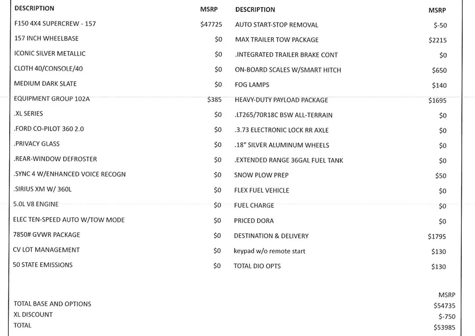

I finally ordered the HDPP f150 on 9/23. Here is the build sheet.
Ford F-150 HDPP Build input appreciated HDPP F150 Build Sheet Sni
