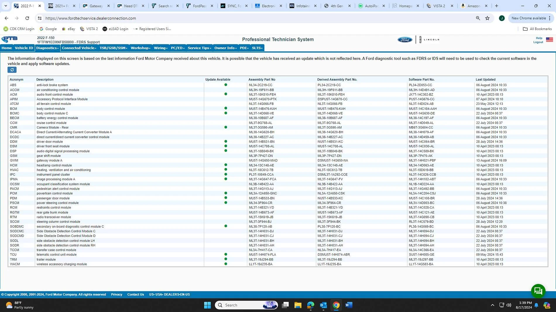

I got your message, but figured I'd respond here. I see they replaced the GWM and seem to have PMI'd it correctly. The truck has not reported any codes that show there are any issues. Without being able to plug into FDRS, I can't see what they're seeing. The only thing I see that is abnormal is in the column to the far right below. They did a network scan with FDRS as recent as two days ago. That forces a sync of all modules with the server. However, as you can see, many modules have not reported themselves to the server on a consistent basis......some dating back to last year.
Ford F-150 Gateway Module communication problem 1723916406696-ok
For comparison purposes, here is my truck that was scanned with FDRS recently. As you can see, the dates are more consistent between when the modules reported themselves. So, it seems like maybe something is wrong, but I can't tell what it is.
Ford F-150 Gateway Module communication problem 1723916659042-82
This may be a Jesse question more than me. If you have a Mongoose and FDRS and the issue is software related, I am sure Jesse can figure it out.
