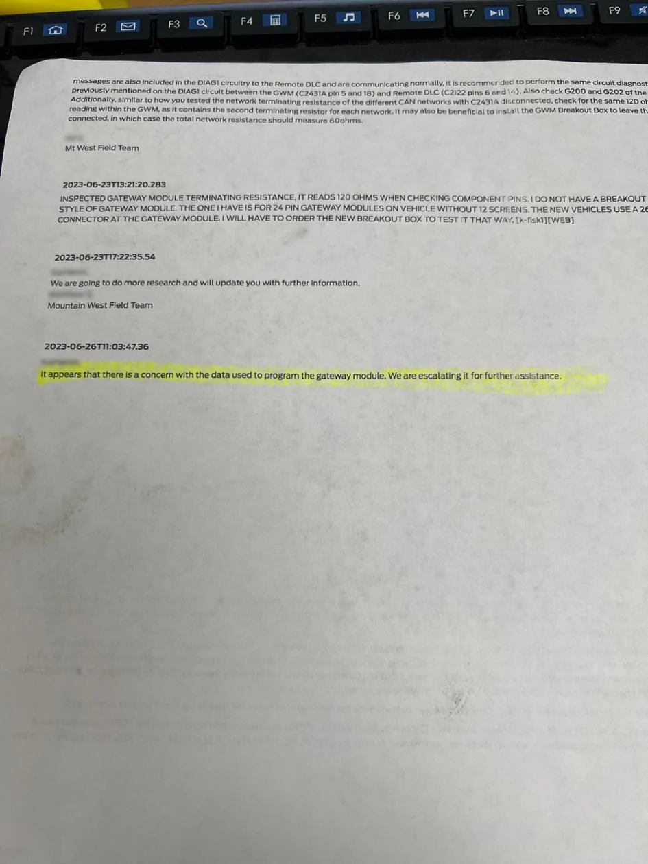

Update: Dealership claimed repairs complete after 45 days, and I picked up the truck a week or so ago. All the issues I took it in for are still occurring. Trailer lights were and have been my biggest concern, the TPMS issue is just annoying and the HVAC issue is hard to test when its in the 100s every day, it was more evident when cooler - might have to wait until Fall to check that.
Working with the Ford RAV/Buyback team this week and waiting on their offer.
I don't believe any of the issues I'm experiencing had anything to do with the Gateway module, and while glad that is "fixed" (not sure how to confirm) still frustrated at the situation and have been taking some time off from thinking about the whole ordeal while waiting on the RAV team.
I've done hours and hours of reading about the Trailer Lights problem - I've yet to see a resolution to anyone with a late model truck and a trailer with LED lights. Every light on my trailer is LED. And both loaner trucks (2022 PowerBoost XLT and 2023 XLT) the dealer provided during the repair had the exact same trailer light issue. A dongle like this from Curt (https://www.amazon.com/dp/B00AFVOF3M?psc=1&ref=ppx_yo2ov_dt_b_product_details) completely fixes the issue for both loaners and was able to test with my truck once picked up and also resolves the issue. I have done a few hundred miles with the dongle and all good. The trailer works fine with older Fords or newer vehicles from other manufacturers and was completely fine on my 2019 Ranger I picked up the trailer with. I'm going to start a new thread just for this issue.
I was able to get a full copy of the Ford Engineer communication with the dealership service tech - I'll post that tomorrow for future reference.
