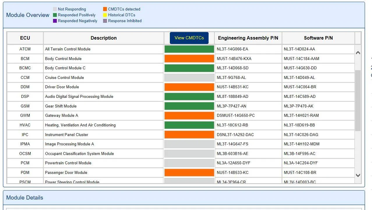

I was doing a update to my image control module and midway I didnt notice my laptop was setup to power off after an hour.. and it failed due to the laptop shutting down
I can't get FDRS to read the comms from the module anymore
is there anyway to rescue this?

What color is the IPMA in FDRS?

Click the IPMA in the main screen of FDRS to pull up all the guided routines you can do to it. Find the PMI and run that. When fdrs asks you if it is the original module, make sure you select no.

This will recover the module and update it at the same time. It will take about 3 hours, so make sure you have a good power supply on the battery.
