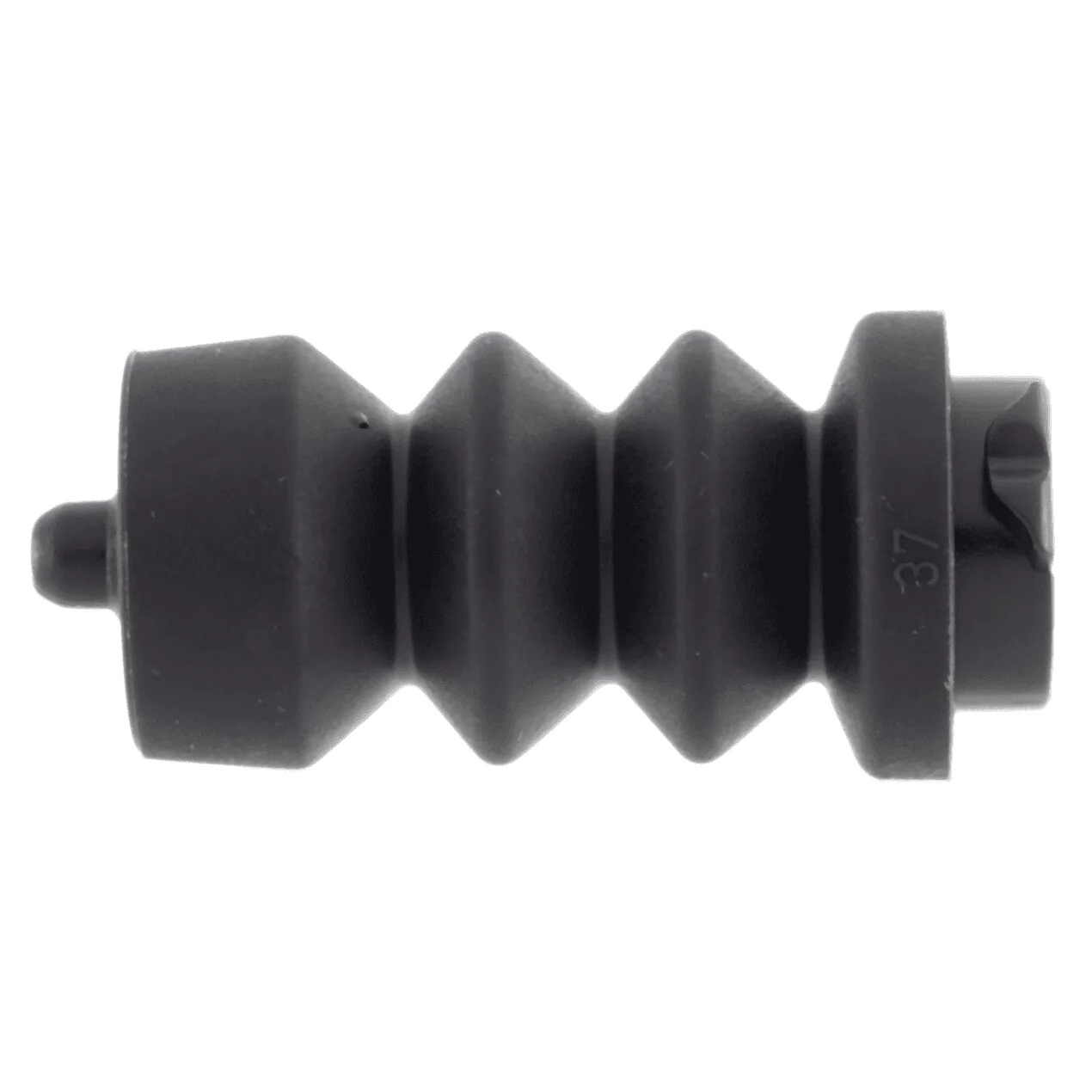

Only picture I can find
That was exactly it. Mine just came and I now have the secure metal pin and a couple of spare boots for when the rubber starts to shred. Thanks for posting that part number.

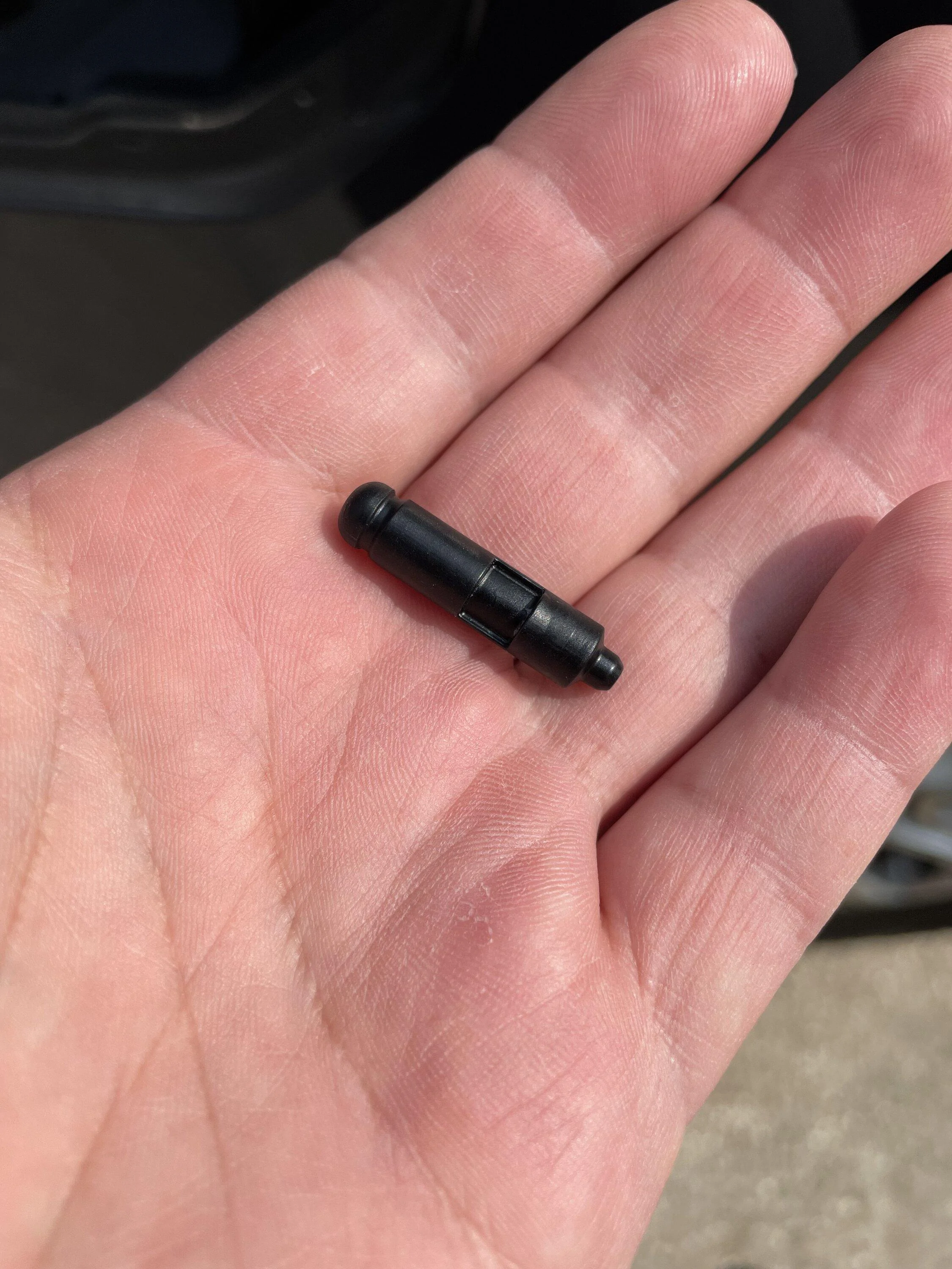

We have the pleasure of having the only F-150's (to my knowledge) with the remote fuel door. About a month ago, I went to fill up and noticed the door was slightly ajar. I didn't think much of it, assuming I had hit the button accidentally at some point or it didn't close all the way on the last fuel stop (I was travelling, so I made a few stops that day).
I went to fuel the truck and the pump kept stopping. I quickly realized that it wasn't the pump that was the issue, but that the truck wasn't allowing fuel in. Long story short, if the release pin is engaged, it closes the overflow/breather tube on the fuel filler neck, which in turn makes it almost impossible to fuel up the truck.
Good news, the pin just snaps back into place inside the rubber boot. If this happens to you, it is not broken. It seems to be designed to break away, should there be an issue closing the filler door.
Bad news, or word of warning, if the pin is engaged, DO NOT hit the release button inside the truck with the fuel door open. It will shoot out of the hole like a patriot missile leaving the USS Ticonderoga. Close the door, hit the button, retrieve the pin and snap it back into place inside the boot.

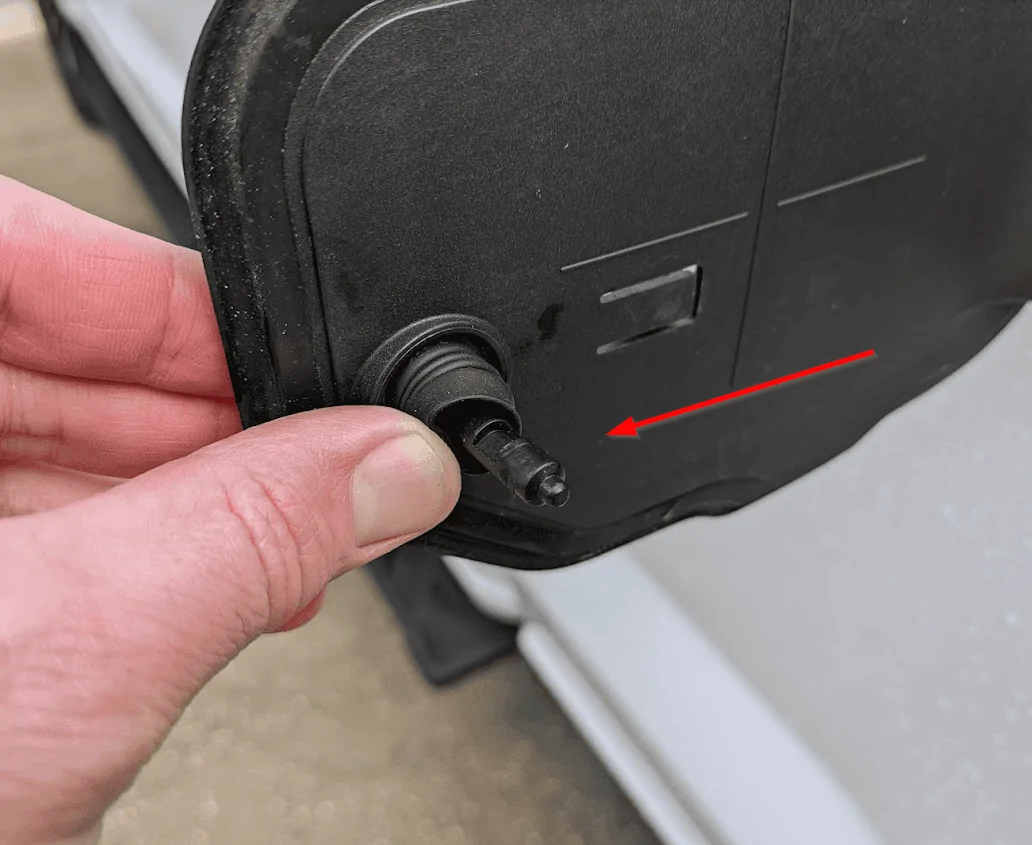

Rotate the pin 90* with some pliers on the stalk clockwise if you're looking at it normally or counter clockwise if looking at the rear side below.
Ford F-150 Fuel Door Pin 1708349340498

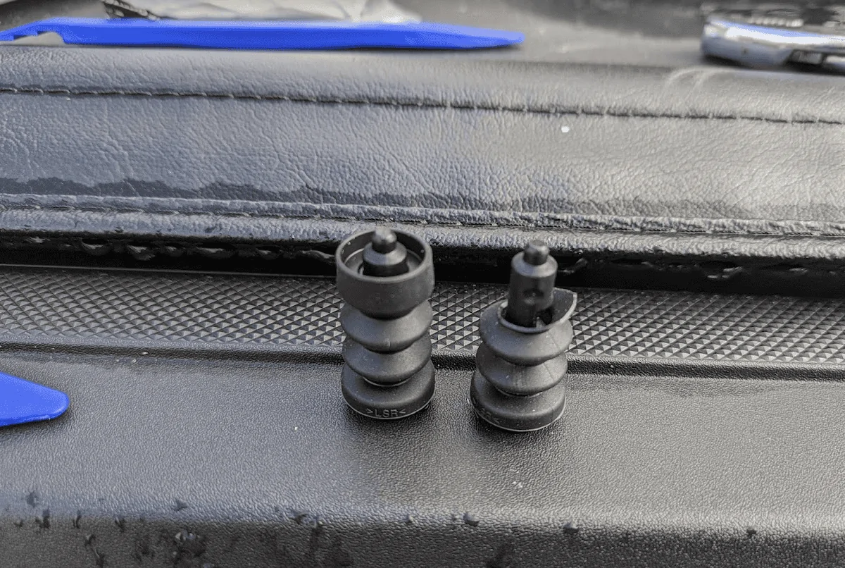

Ripped rubber tappet removed and next to new tappet.
Ford F-150 Fuel Door Pin 1708349396074

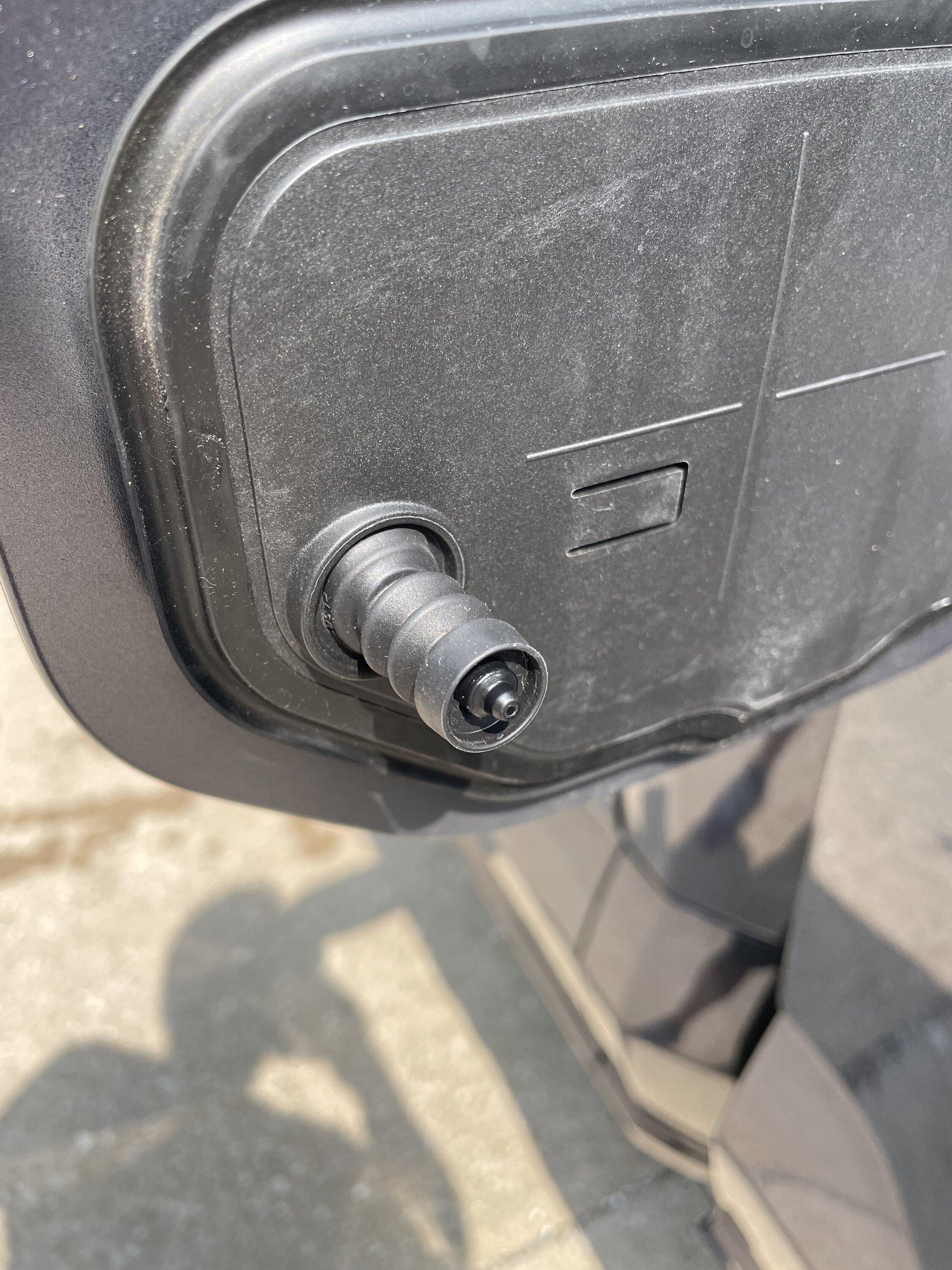

Insert new tappet with notch facing truck and rotate it 90* with pliers so it is at the top and locked in place.
Ford F-150 Fuel Door Pin 1708349439838
Once secured, do a few test closes and releases and then put painted fuel door cover back on, make sure secured, and then do a couple more tests.
Ford F-150 Fuel Door Pin 1708349531101
