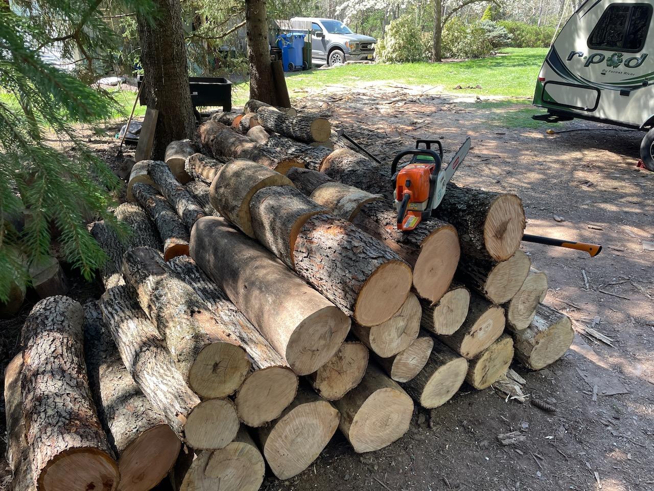

Today, I needed to buck and stack a few logs for next winter. Knowing it was going to be an all day project, I decided to do a little test. I put the truck in generator mode ( see it in pic below ) and made sure something was hooked up to truck WiFi. No load.
I started @ exactly 9:48 and 260 miles to empty and finished ( including cutting lawn and shower - TMI ) @ 5:48 and 248 miles to empty. 12 miles or roughly 1/2 gallon.
So, why is ICE even coming on at all? I can't imagine the modem is using much. When I ran my house for 12 hours, I used 28 miles. I just don't understand the logic.
