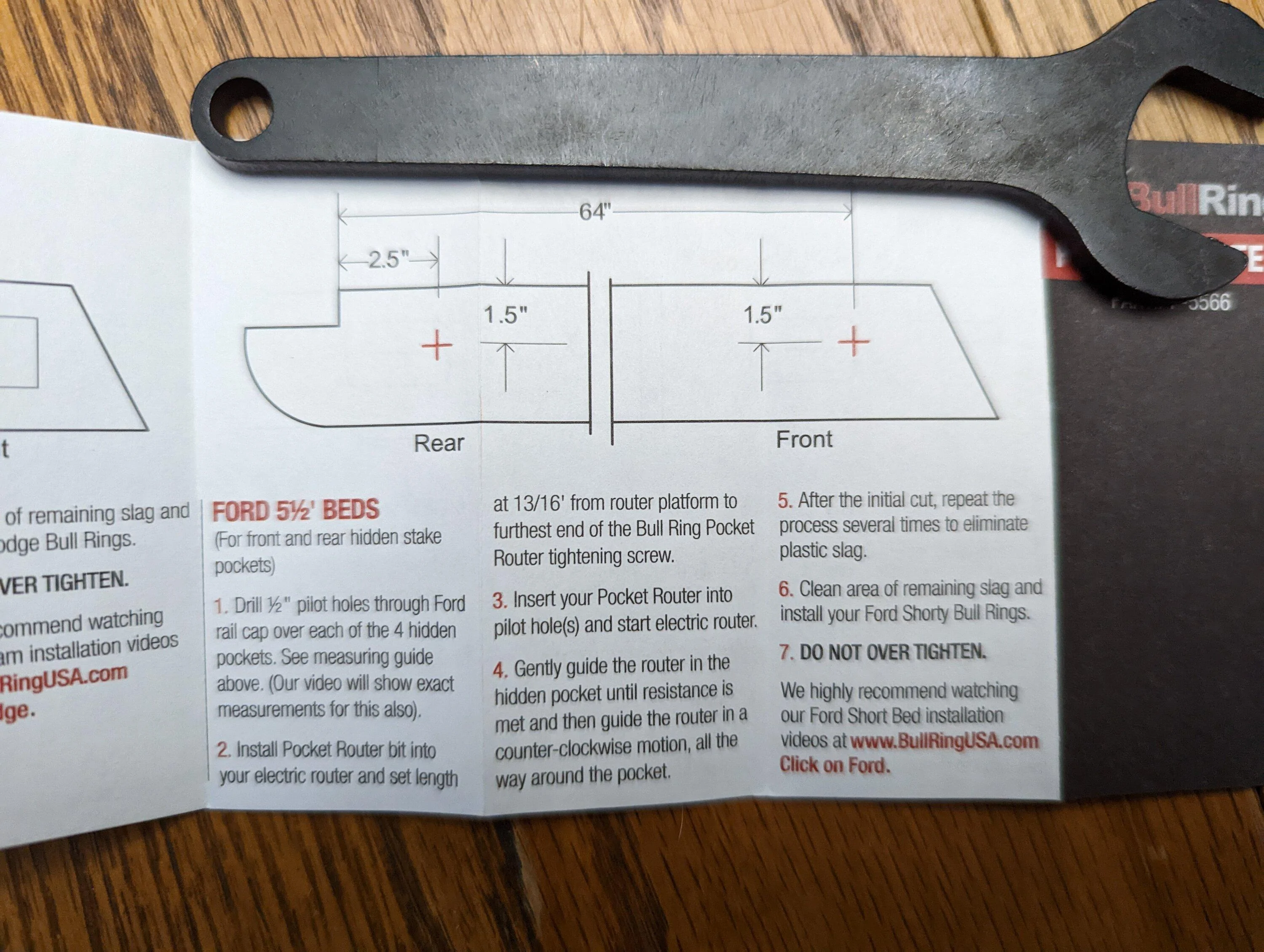

For anyone that has uncovered the front pockets, do these measurements look correct? From what I can see, it looks good, but having confirmation would be appreciated before I put a hole in the top plastic rail. It looks like the middle on the front hole is right at the edge of the raised portion.

I drilled the holes tonight, but didn't fully open them up because I ran out of daylight. The measurements above do not get you in the center of the front stake pockets, but you are still in them at least. The center is about ¾" to the rear.
I plan to use the bit to open up the holes, then center the rear pocket covers over the opening and trace around them. I'll then use either a utility knife or my oscillating cutter to take more of the plastic rail off so my tie downs sit flush (more or less).

I hate posting after myself again, but I got my stake pocket tie downs installed tonight. First, the router bit stated it needs to be exposed 13/16". When I went out to go cut the first hole, I checked and the bit would have barely been cutting anything. I exposed it to 15/16" and it got almost everything. Another 1/32" probably would have helped, but it wasn't necessary.
Using the covers from the rear holes, I scribed where to cut with a straight pick from a pick set. Then I used a utility knife to cut where I marked. I needed to do a little trimming, but once you're through, it's pretty easy to cut. I plan on getting something to seal around it and clean up the look of the edges, but it turned out really well I think.
