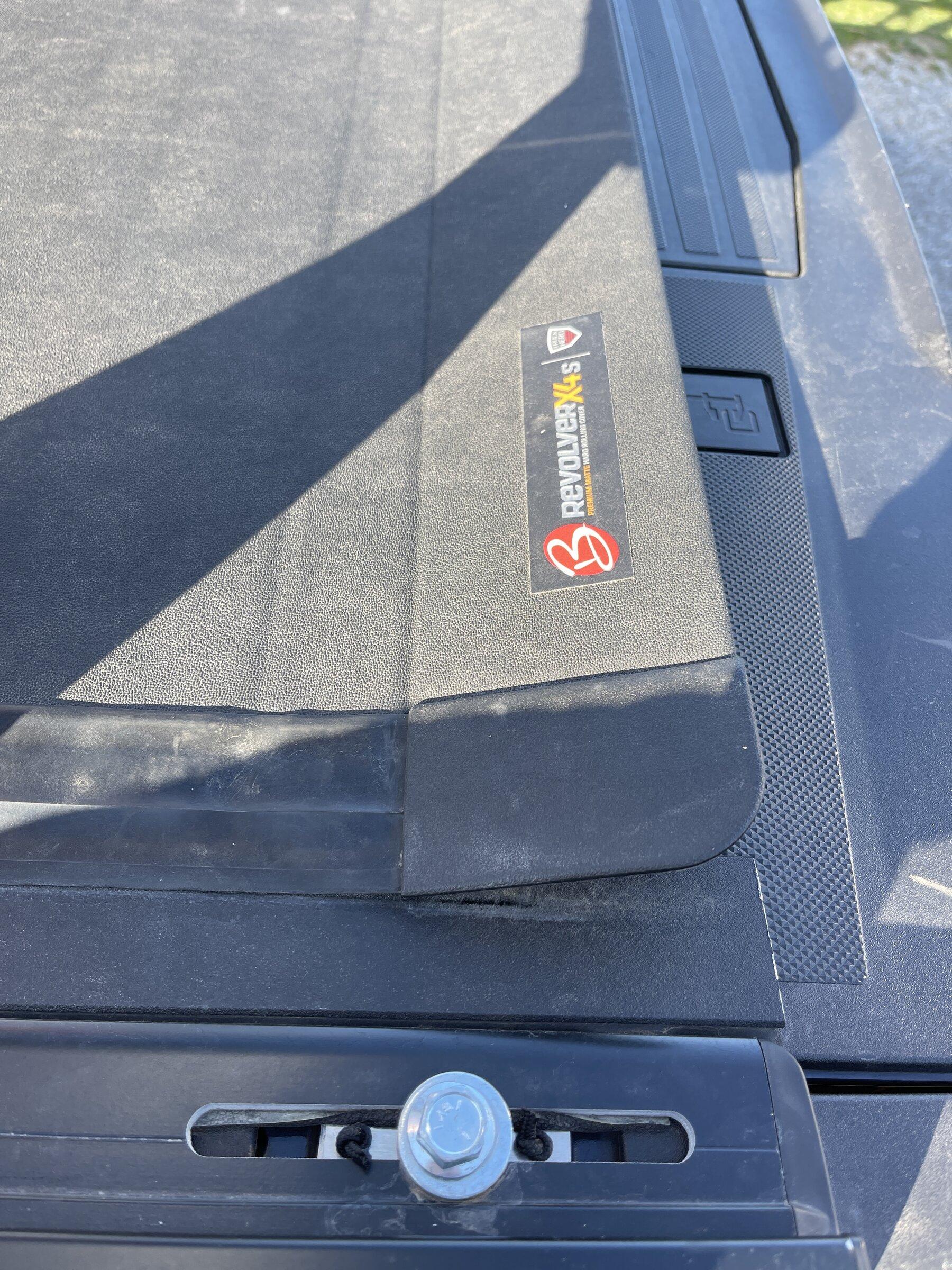

Installation went pretty well. Opening up the stake pockets in the front corners was easy enough, but messy. The Adarac bed rail rack is well engineered and unobtrusive without the vertical load towers. I can manage rolling and unrolling my BAK revolver tonneau cover (not the Tri-fold) just fine. My beef is that Agricover (parent company of Adarac) shorted their parts bag a total of 12 recessed, specialized nuts - so start to finish it took a week.

You bet. Here’s front and rear, all installed and working properly.

Thanks for sharing! Looks good. I like the idea of the stake pocket rails, just wish Adarac had t-slot channels on the bed rails instead of their own system.

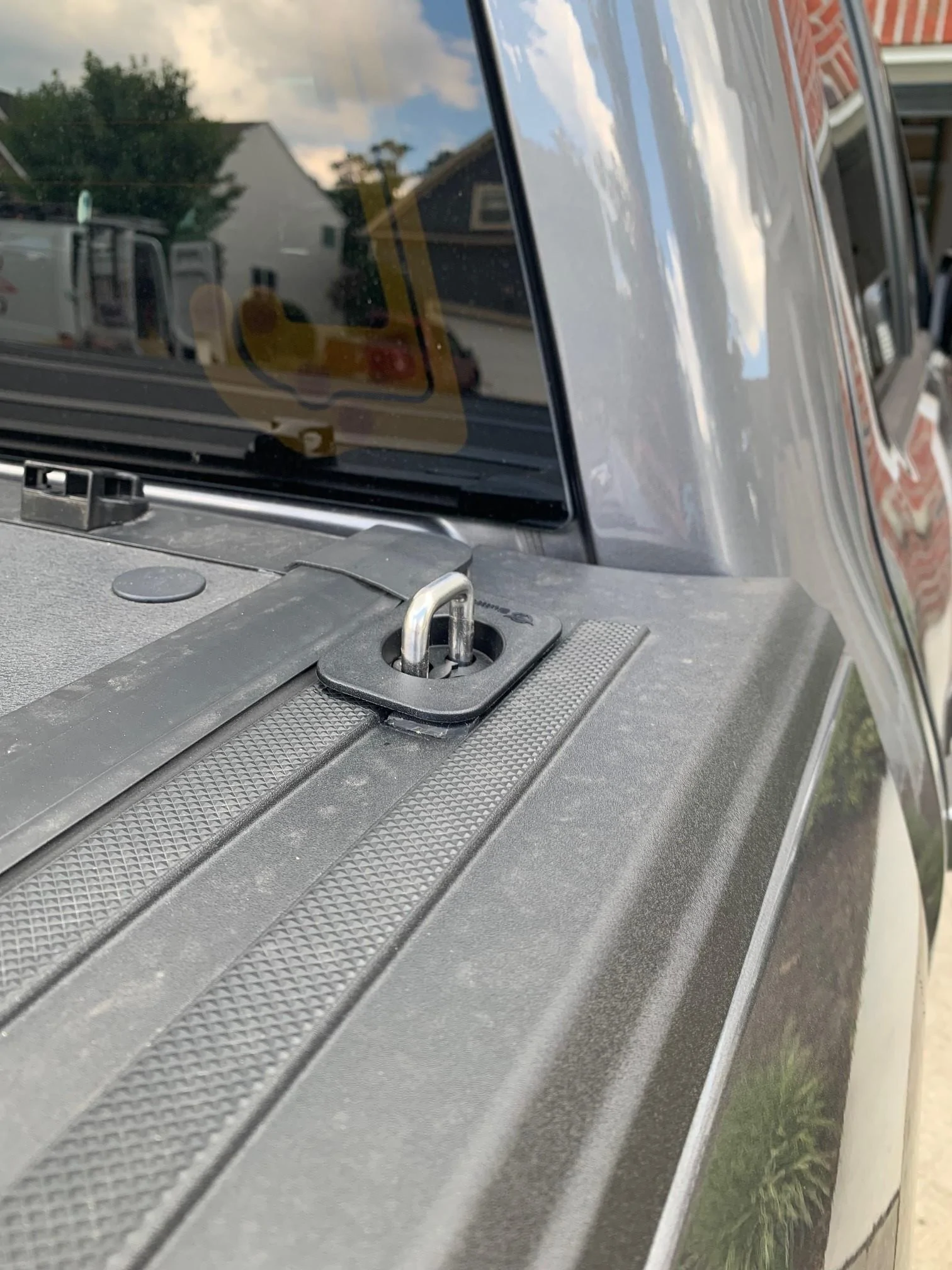

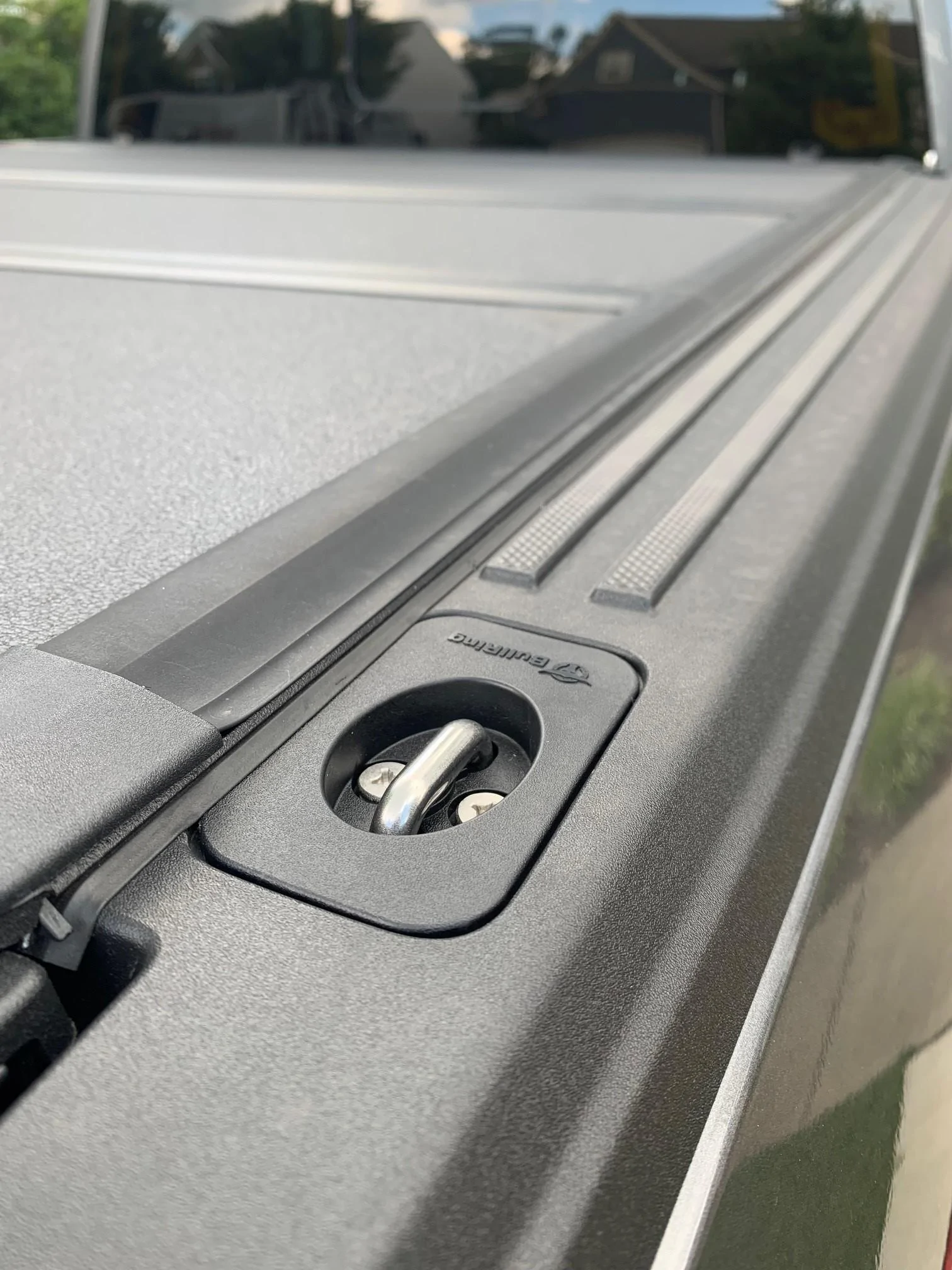

Pics of the standard BullRings tie downs front and rear. The fronts do not sit flush like the rears and I added some plastic spacers underneath to get it as best I could. I don't think you can trim the raised part of the bed b/c there is a piece running underneath it that gets in the way. I thought it was pretty ugly at first but it doesn't bother me any more. This is on a short bed. The stake pockets on the long bed are not hidden so it will sit flush in the front just like it does on the rear. I reached out to BullRing and they didn't even know about this issue so they didn't have any solutions to make it sit flush. I'm sure with more time and effort I could devise a way to make the fronts sit flush but I didn't want to start cutting more of the bedrail and screw something up. I just used a drill to get the hole started and then cut the pocket with a Dremel on low speed so it didn't melt the plastic. A box knife worked equally well.
