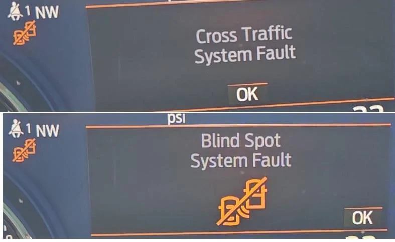

Oh, also found out that behind the darker piece of red plastic, next to the white reverse light must be a microwave transceiver, because this happens when it's unplugged:
Ford F-150 Friendly reminder to check your taillight fluid level! faults

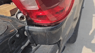

Confirmed all four blink/brake bulbs are the same dual filament part and interchangeable.
Closeup of a new OEM bulb from the local Ford parts department:
Ford F-150 Friendly reminder to check your taillight fluid level! bul
Also for fun, here's what my plug harness looked like before cleanup (still works):
Ford F-150 Friendly reminder to check your taillight fluid level! plu
Please note I don't know which trims have a different lamp assembly and the above info is for my '21 XLT. The Lariat / Platinum might have LED, perhaps. And hopefully is sealed better.
Now that it's all fixed, I think I'll go drill a little weep hole...
