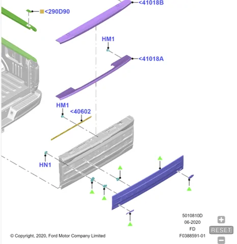

Just checking in to see if anyone who had their 2021 F150 tailgate appliqué replaced by the dealer is having the same issue again. My 2021 F150 Limited has had the tailgate appliqué replaced twice under warranty for the warping and each time it did not fix the issue. Literally both times when I picked up the truck it had a new appliqué but there were large gaps on the upper left and right sides of the appliqué. It is clearly not secured properly by design. The two areas where there is hardware/bolts that fasten the appliqué to the tailgate is sucked in super tight to the truck. Everywhere else is gapped out about 1/8”+. It is extremely noticeable when walking up to the vehicle from the rear or side as the reflections are warped and distorted as a result just like a warped mirror at a carnival. At any rate, I am awaiting Ford’s third attempt to replace the appliqué (part is now back ordered for over a month). I saw a YouTube video where a custom shop was removing the 2021 F150 Appliqué to paint it and the tech said he would put 3M Double Sided Tape on the back of the appliqué so it would adhere better. I am tempted to ask Ford to do this when they replace it. Thank you in advance for any feedback on your replacements and if it actually fixed the problem.
