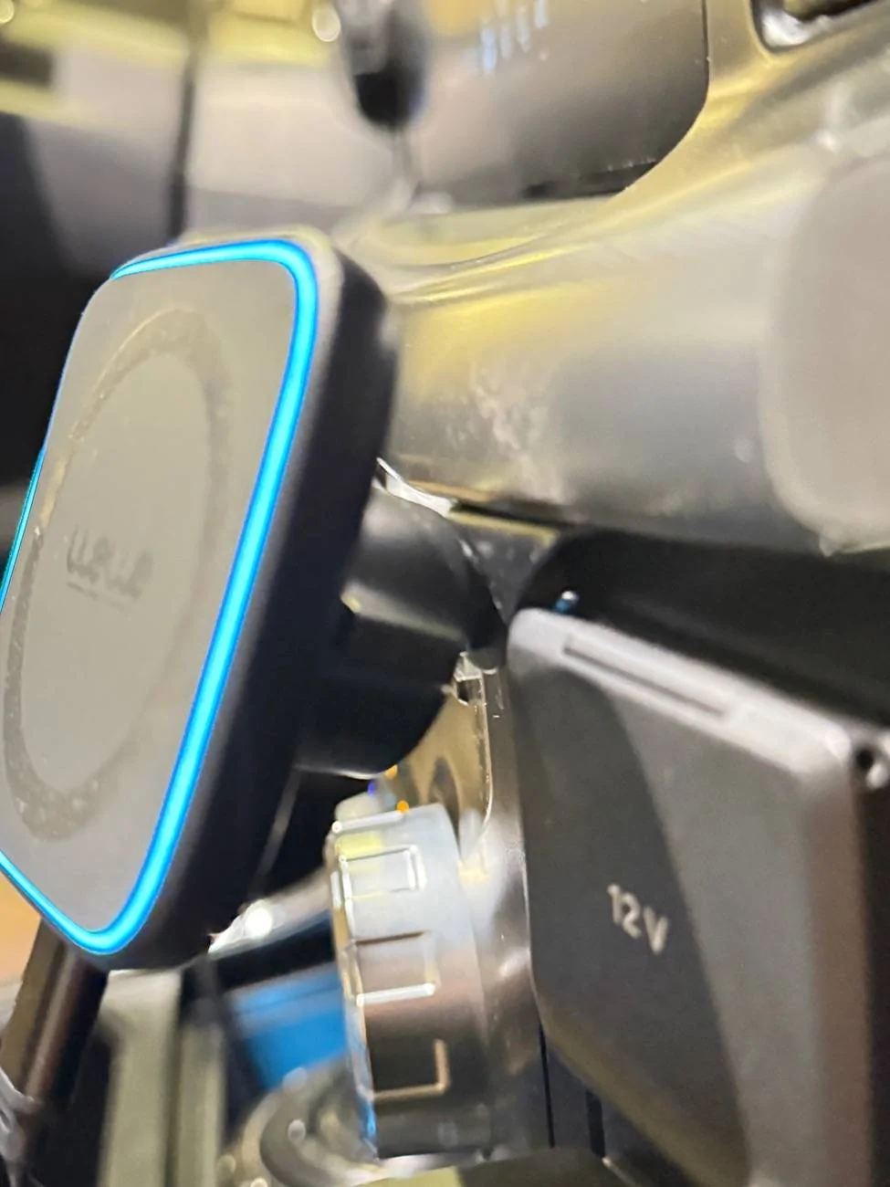

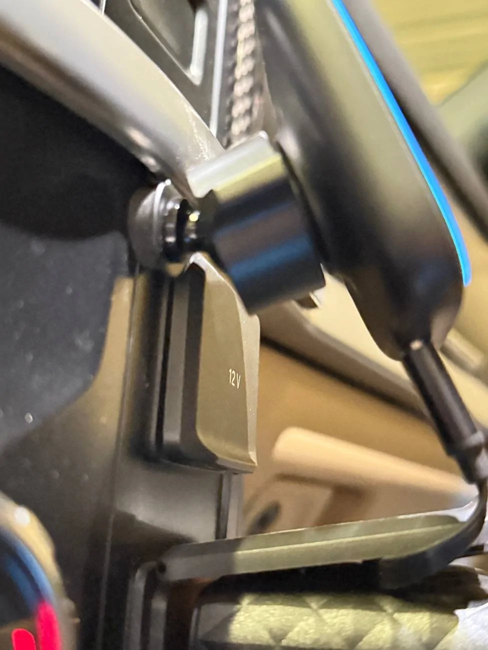

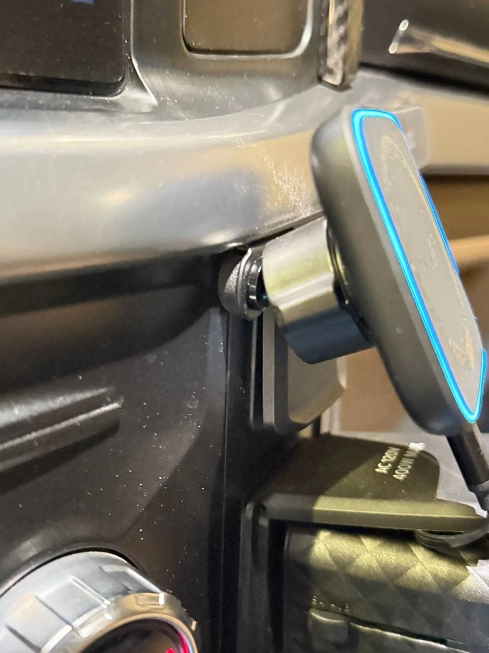

I switched the magsafe charger head with my second car so its matched the ambient light color. Same bolts and nuts that came from course motorsport.
What brand charger is that? Love the blue

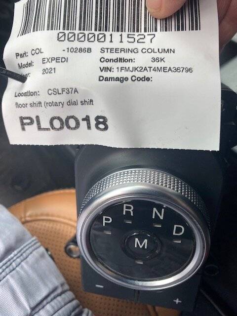

Mine Works as it should, manual and if you open the door it goes to park. I temp connected with the truck off (I did not disconnect battery) and all worked. Unfortunately, I cannot give you the model number, the only label on the switch is faded which is weird. But here is the vin number.

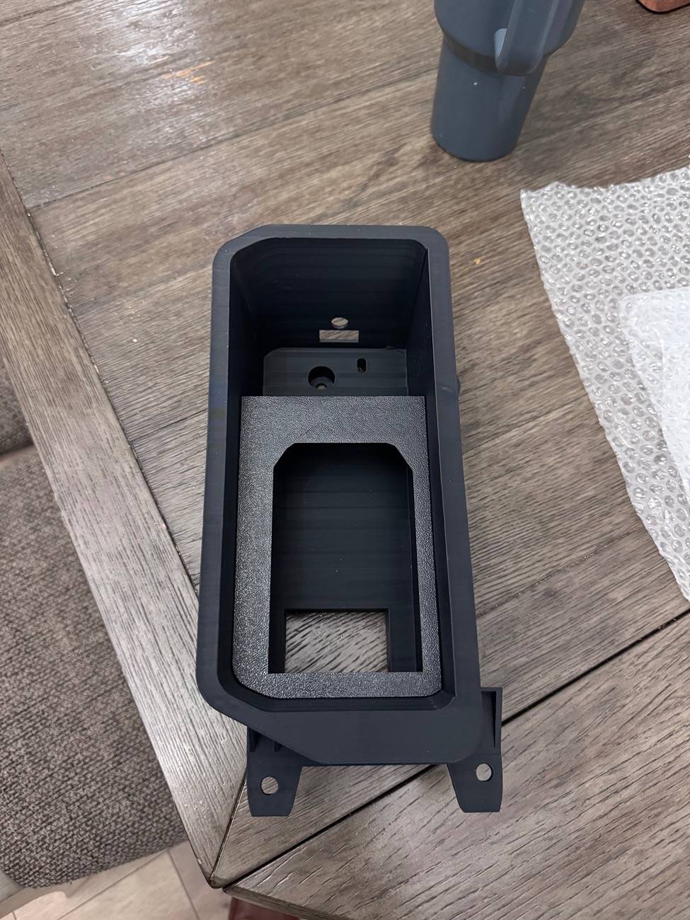

Received my print from @Ajzride
shifter will be here tomorrow. Also from a 2021 Expedition like @digitaltrucker
will install this weekend!
check the box to make sure you don’t throw away the TPU mat that covers the bottom of the cubby
Outstanding! Please let us know how you make out. I have the housing coming from the Etsy guy later this month and want to do this for my 2022. Let us know if any codes get thrown with the 2021 Expo dial (part #) and please post pics! :) Good luck.

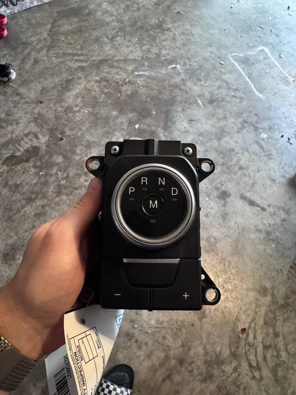

Received my shifter today!
curious - what are you guys using to cut the mounting holes off the shifter? Just dremel with a cutoff wheel?
Multitool with a wood blade.
