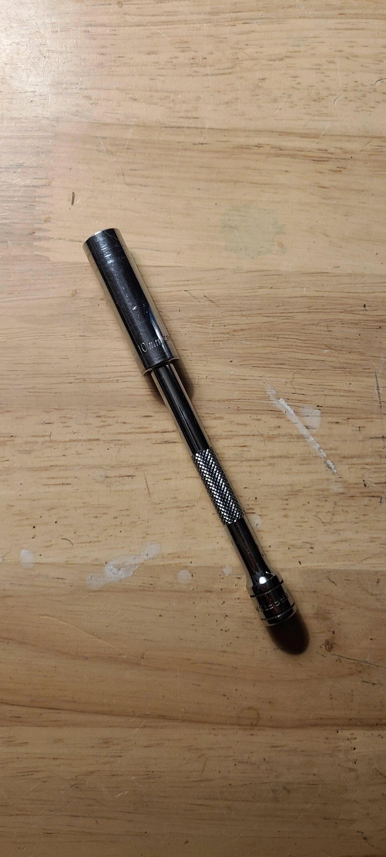

Thanks for this thread. Used a 10mm deep socket and extension, easy to turn by hand this way. I didn't remove wheel well liner screws or turn the wheels to gain access, just look at the pictures posted here and you can see where to adjust. I'd recommend gloves / long sleeves as there's a few sharp screws and plastic corners that will grab ya, lol. Turned both sides all the way up (counter clockwise)and then backed them off a full turn to maintain contact of the adjustment screw. My led fog lights are now functional instead of just looking cool.

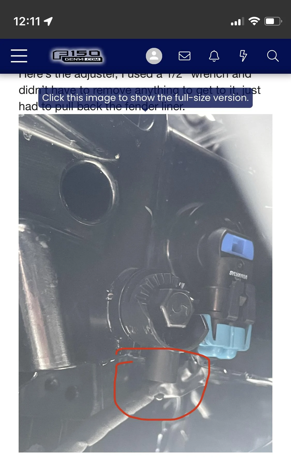

i must have different fog lights…i used a screwdriver from directly under that black bolt and adjusted mine in 30 seconds.
iphone pic won’t load but if i lay under the bumper and look up behind the fogs, i can see the previously pictured black bolt people are putting a socket on. under it is an adjustment screw like on the head lights. turn it. done
Vin
Apr 5, 2022
292
475
circled is where you need to insert the screwdriver from underneath. that will turn bolt also.
Right. But then I wouldn't get to use all of my other tools to unnecessarily remove all kinds of stuff to "access" the adjustment bolt.
?Thanks for the better way!!!!
