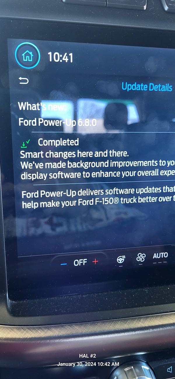

You can check on your sync screen
For version
And check last update. If successful it will display text of what was in the change
An example of one last jan
