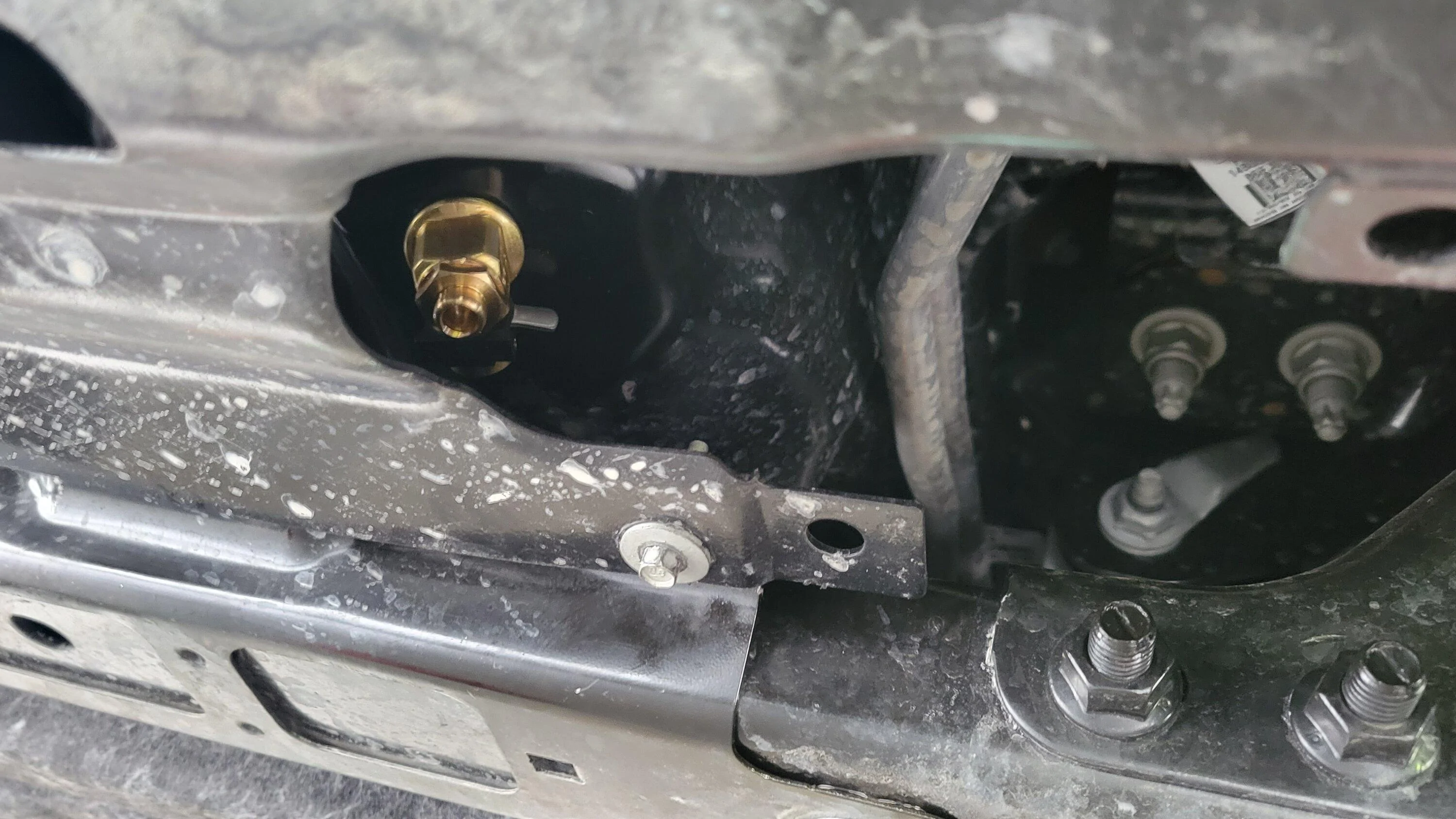

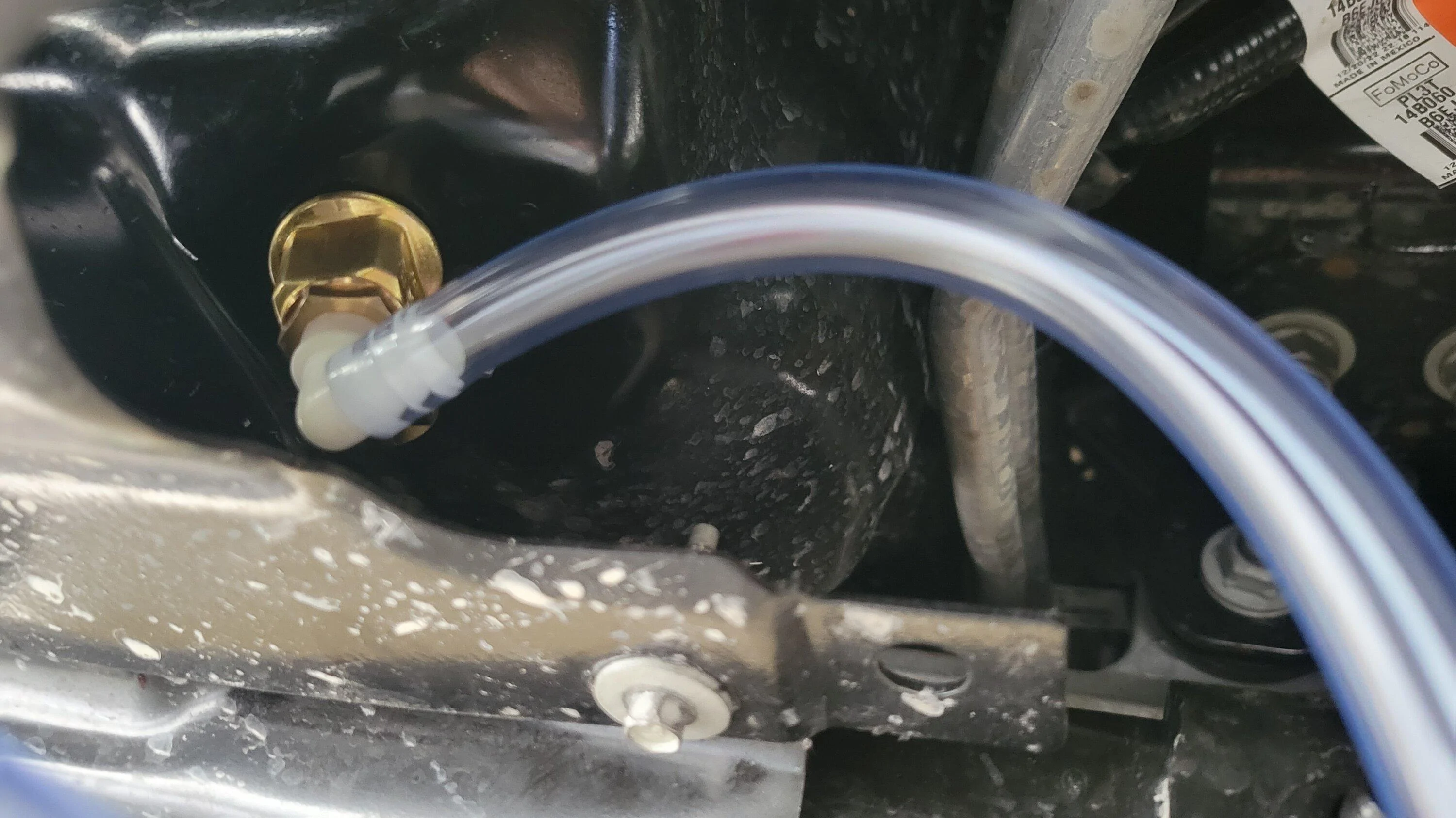

For those with 5.0's and this skid plate, you can use a Fumoto short nipple drain valve along with their right angle adapter and tubing for hassle-free oil changes.

... and if the Fumoto fails???
