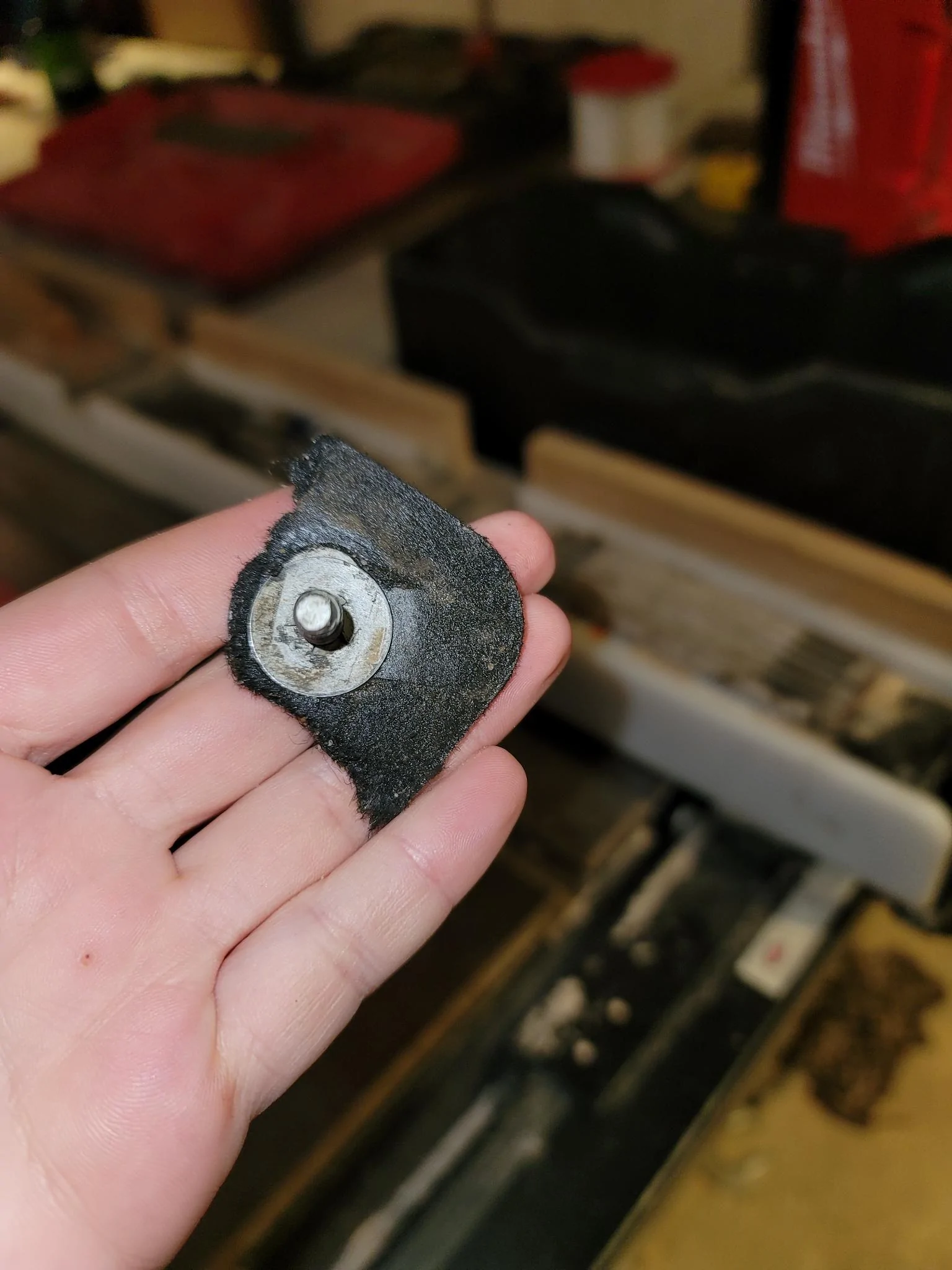

My brother pointed out that there was something hanging from under the engine, today. Turns out it's the under tray. I haven't seen anyone else post about it yet, but if you have one, check it out.
Truck is a '21 PowerBoost Lariat.
Ford F-150 Engine under tray failure at 32,000 miles. signal-2022-02-27-202345_004

Did you recently have your oil changed? If so, maybe whoever changed it didn’t properly secure it.

Vaguely recently. I have 84% life left. The bolt was securely fastened in the frame. It just tore.

I noticed you're located in Michigan. Is it possible you drove/backed over a pile of solid snow and ripped it off?

I just got it back from the dealer and they replaced it. The dealer implied that it could have been their fault from not completely removing it when they did the oil change. They said they have removed three of the four bolts and just let it hang during the change. And since it's a cheap POS it didn't take long before it failed since it's not supposed to bend like that.
So the dealership covered the cost of replacing it. If it fails again I'm just going to buy the skid plate mentioned above.
