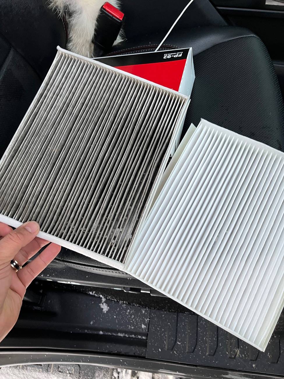

Engine Air Filter - what does this tell me?

I agree with @Gros Ventre. I normally change mine around the 6 month mark, and I can barely tell it was used -- maybe I should wait a little longer. The good news is that all that stuff in the filter didn't go into your engine. See the link below for a nice comparison of some common air filters.
Air Filter Test and Comparison
