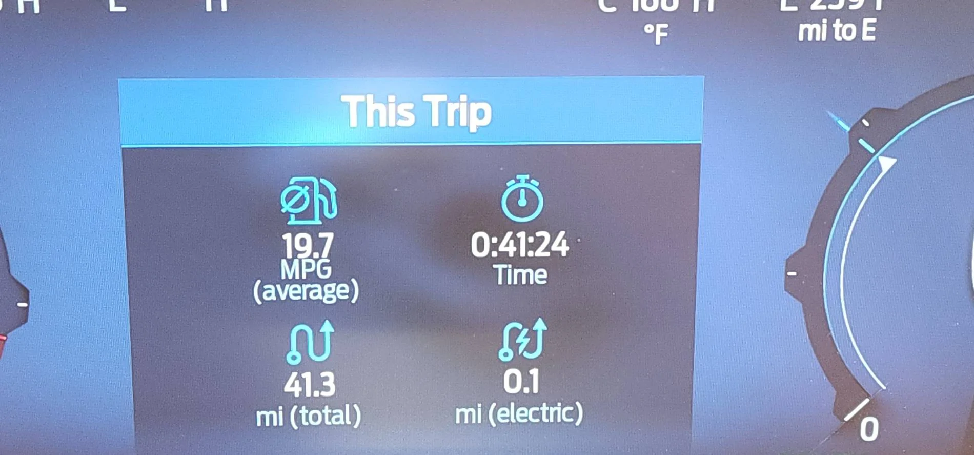

Has anyone had their Powerboost no longer go into Electric mode? Mine will start in Electric but once I accelerate enough to go into Hybrid mode, it will not go back to Electric mode. Even when I drive with soft acceleration/braking so it charges inside the display box.

Take it to the dealer and get it looked at?
I plan on it for sure. This blows my mind. A mix of highway, rural, and city driving and this is what I achieved.
