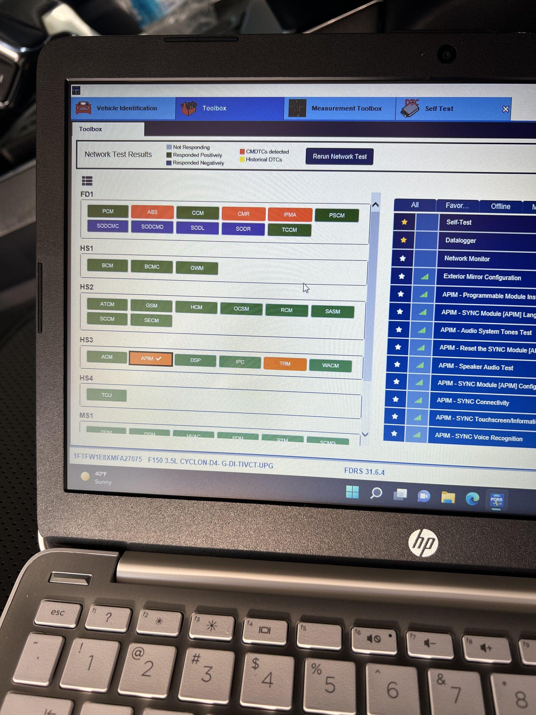

Wanted to ask some advice. I got the VX nano and have been updating modules tonight. Well everything went ok except when it came time for the Side obstacle detection control module c, d, LH, RH. When trying to update each one they all appeared to fail. Fast forward and now when using the truck I get Blind Spot Detection w/cross traffic off warning. Any ideas on what I should try next? VIN: 1FTFW1E8XMFA27075
Are the updates still in your list? If so, retry the updates. If not, I would probably try to PMI the module(s) and see if that resolves it. Maybe someone else has better insight though.

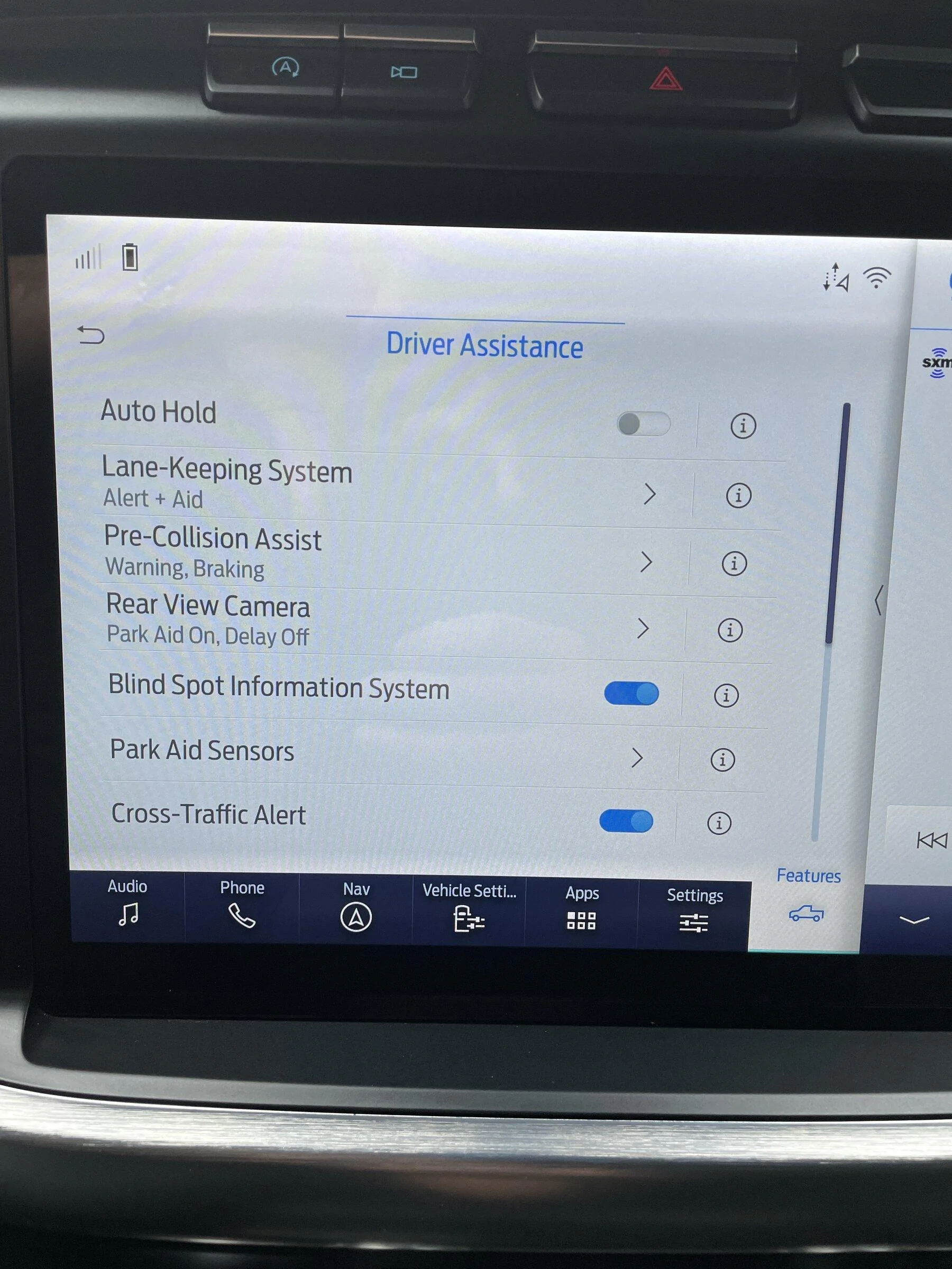

Check under your Features / Driver Assistance options, it may be off. When I did the TRM it turned off some of the features and took me a few days to figure it out.

So I’m thinking I have some problems with the APIM maybe? Can I PMI the APIM?
Possibly, although a problem with the IPMA might also be a good candidate. I’d check there before proceeding to a PMI.
