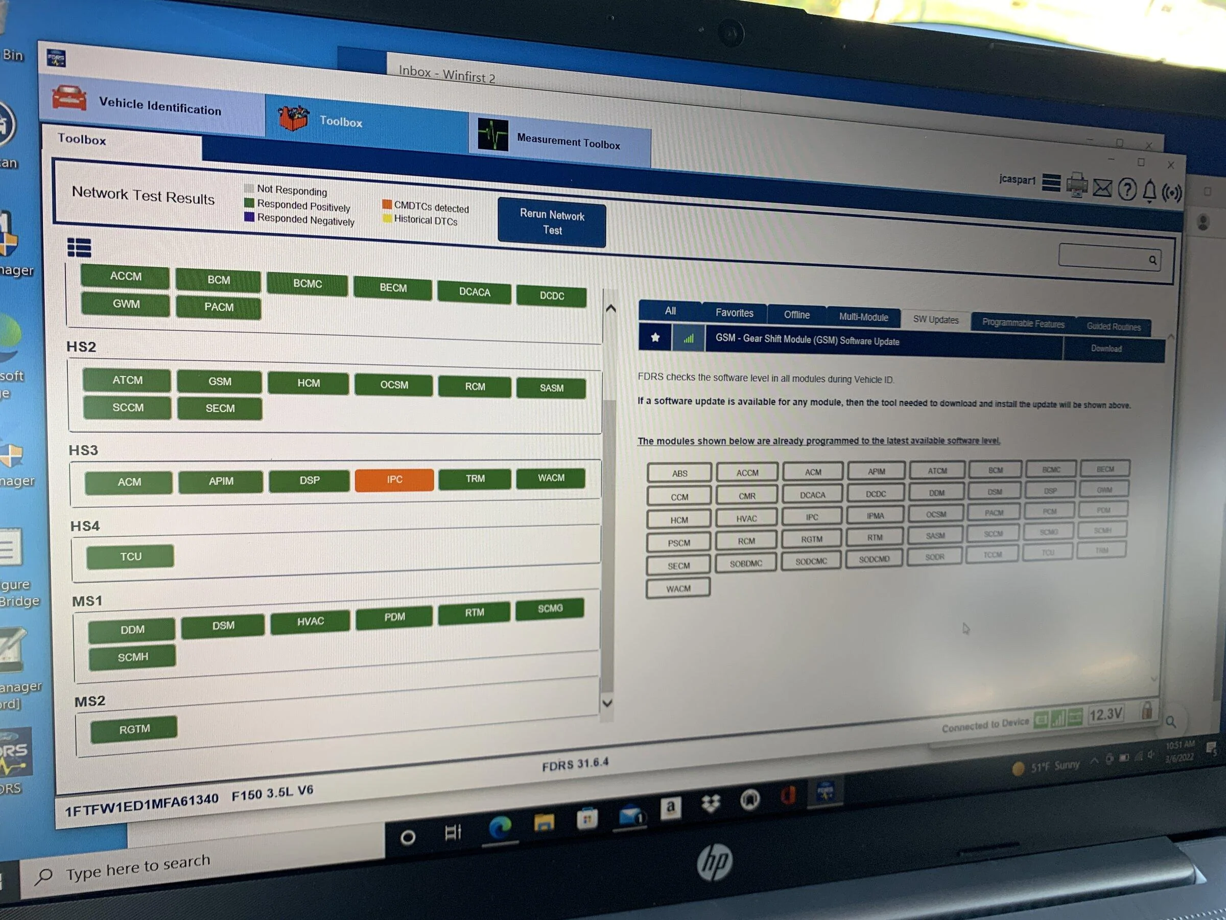

Anyone have trouble with their running boards after updating? am now up to date is seems but my power running boards are stuck out. Only DTC is on the IPC, cannot get this one to clear. Fuse is good and ran tests on DSM, BCM BCMC all good. Interestingly, when I ran a self test of the BCM after updating it (had a DTC) I it had very violent movement of the running boards. Did not do that this time.
You need to look at your Driver seat module. That is the module that controls those and the heated and cooled seats along wit steering wheel. You may want to PMI the DSM.
