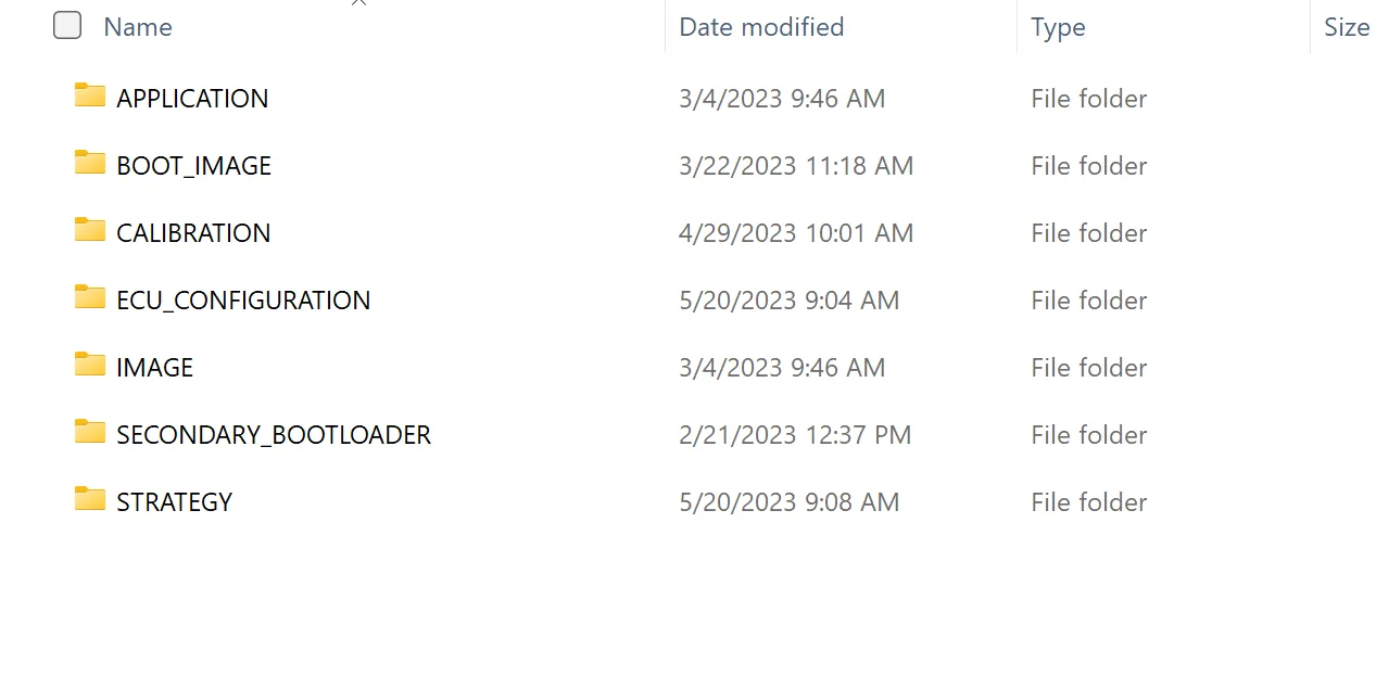

Look in this folder if this file is on there
C:\ProgramData\Ford Motor Company\FDRS\fdrs\data\vehicle_software\SECONDARY_BOOTLOADER

That is definitely an issue. Make sure youre in the right one. these are hidden folders you have to set the view to show hidden files and folders
Should look like this
Lemme download the CMR software again, I wonder if it's because I did the refresh files thing through the envelope.

Here's what's in Secondary_Bootloader now:
Ford F-150 ECU module programming guide using FDRS 1684974383088
It's a 3KB file
