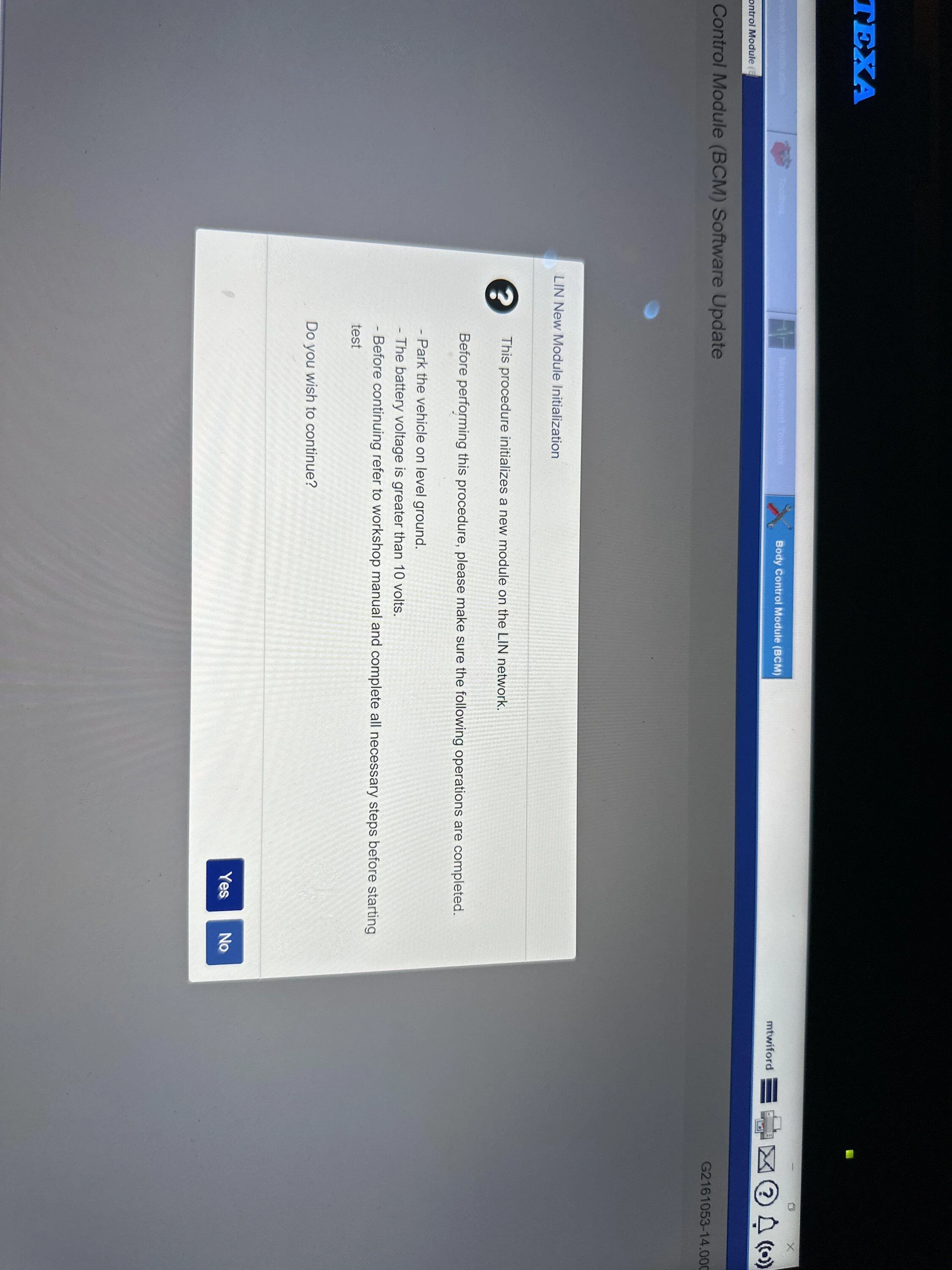

Ford F-150 ECU module programming guide using FDRS imag
Finally running through the rest of the updates. Did the BCM and got this after. Is this process straightforward? Not sure what steps are in the workshop manual

That step took I think less than 30 seconds. It looks more scary than what it is.
