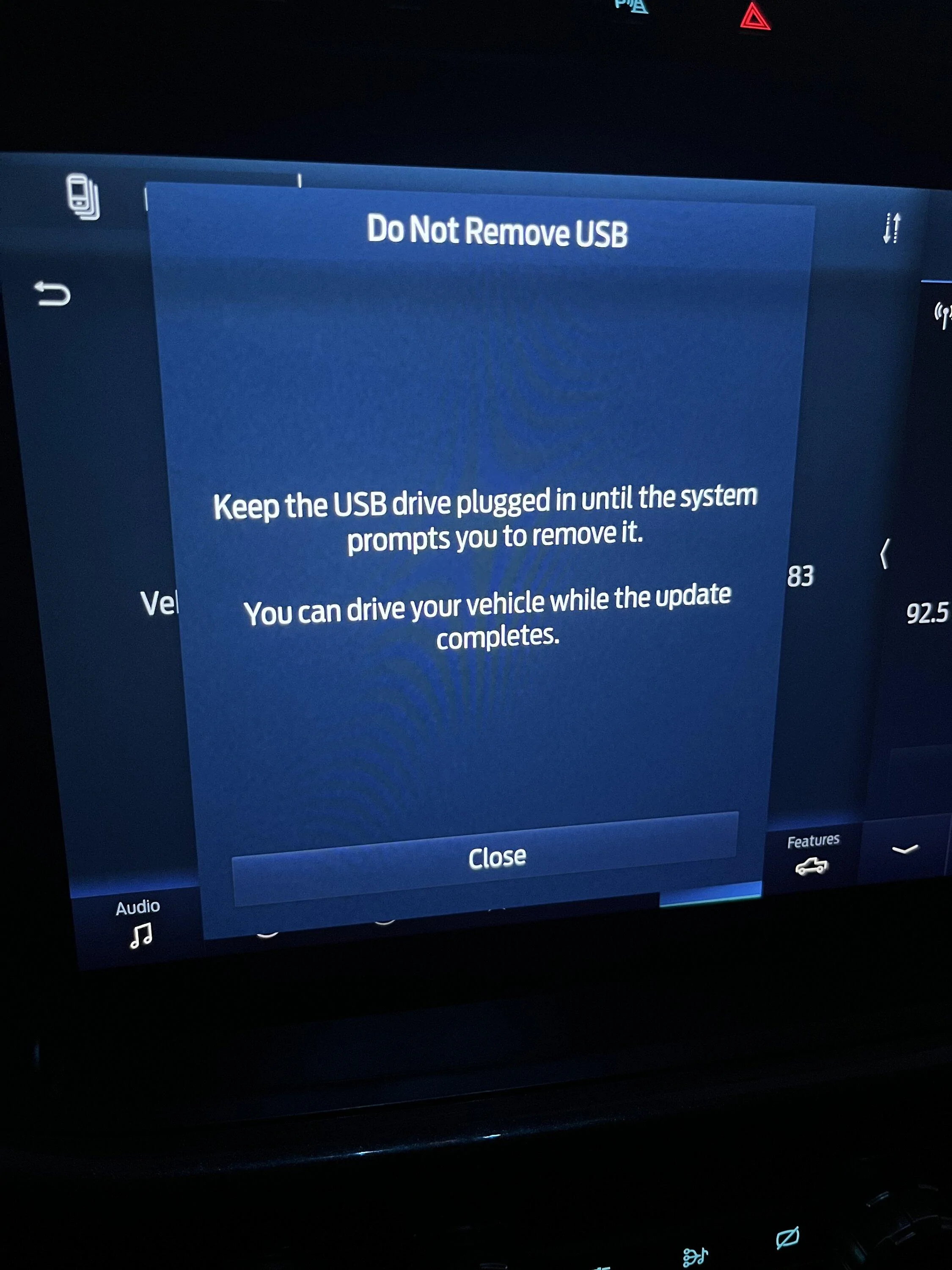

whats crazy is the whole time it did the update the status bar stayed at 0% i got the restart message left the door open and took the key to the other end of my house. i supposed ill need to purchase fdrs again for alot more updates

Before and after. Never got a prompt to remove the drive after I did the whole door and key thing I assume it worked ??
Yes. You’re good
you just got over a BIG hurdle
