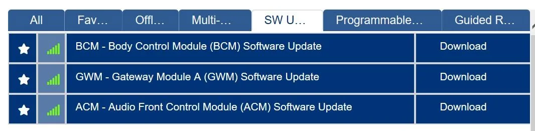

...t FDRS/FORscan are both very new ventures for me. I assume the line that needs to be changed to get the unreal engine is in the BCM?
7D0 = APIM
If you have havent downloaded the Forescan spreadsheet from that thread, go head and grab it. If you have it, the second tab has the module list and when Jesse drops his gold nuggets the first item has the module number so you'll know which one to update.
