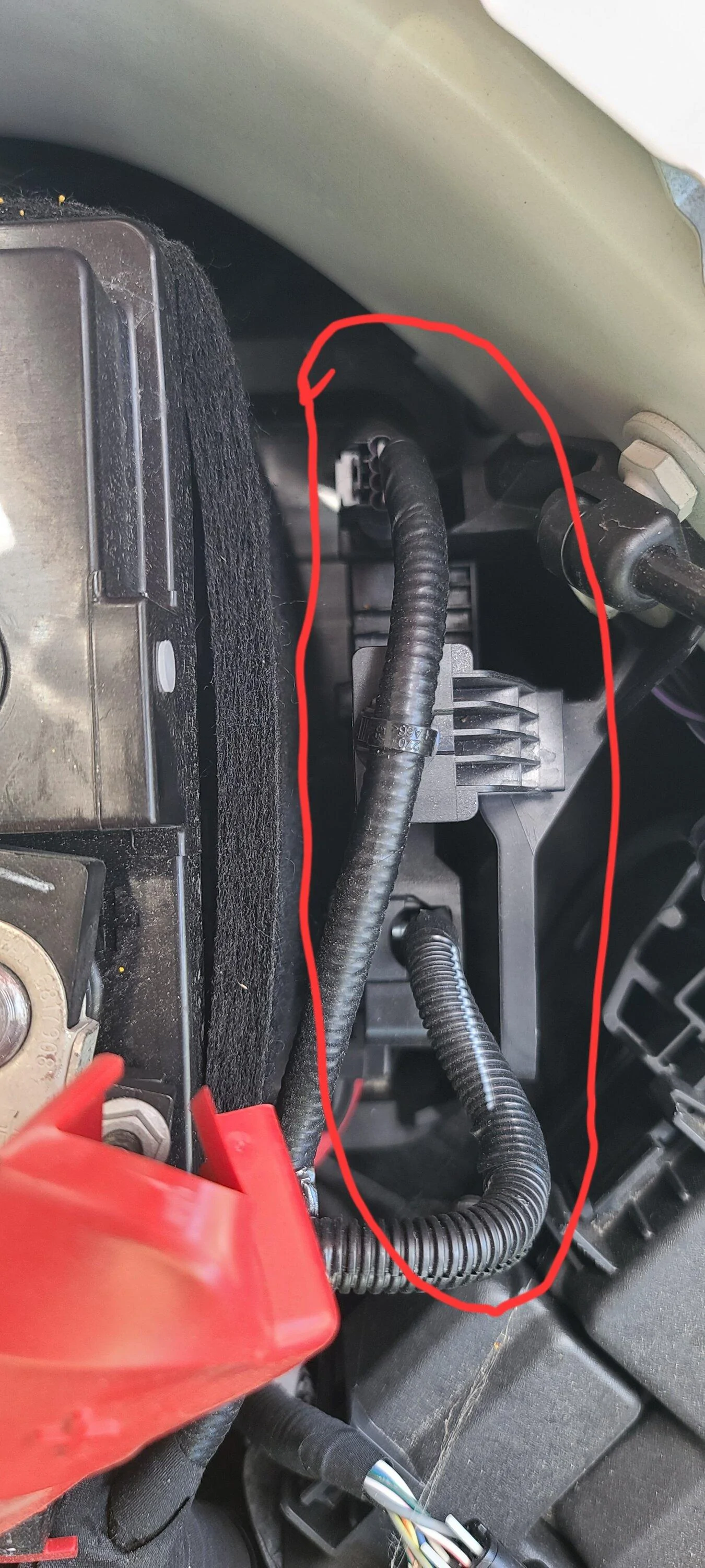

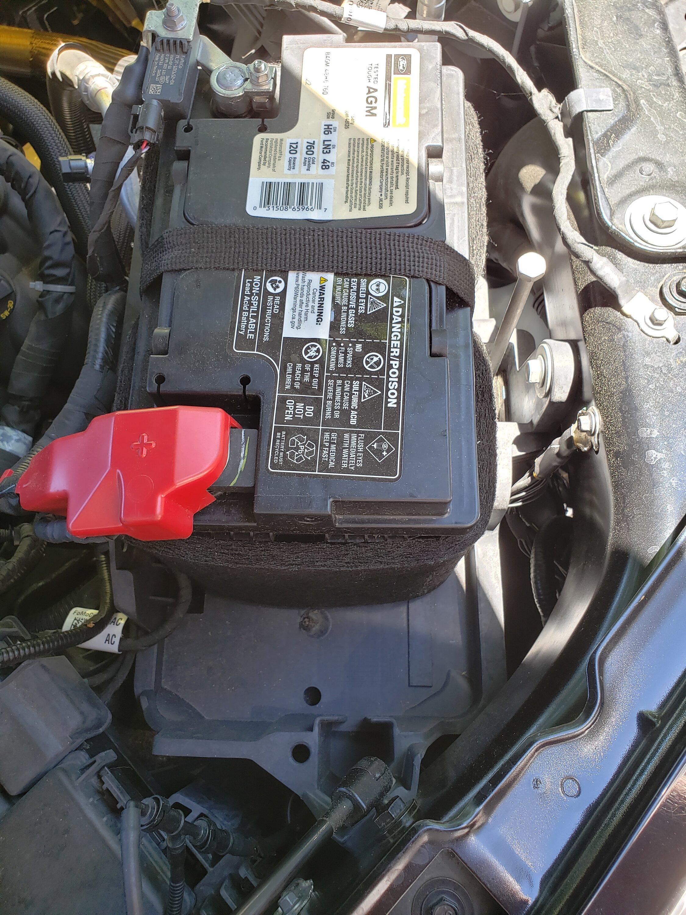

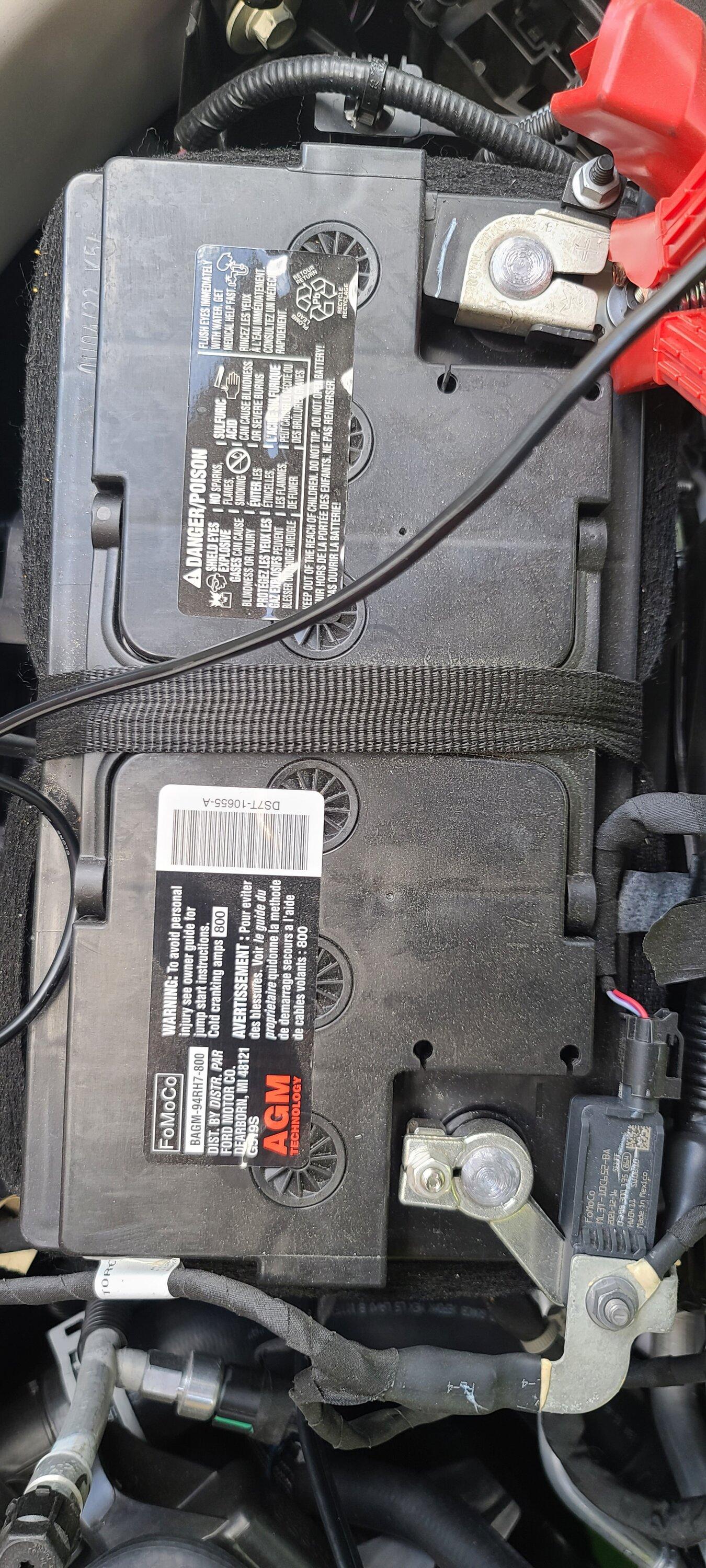

I do know it's the 800 battery and if you look closely at the tray there is additional available surface area in all 4 directions. Not a lot, but some.

I guess they got cheap on mine. I have the 760 with 3 more inches of room to go in the battery box. I might look into getting an 800 like you have. I guess BMS can be programed for it.
Hmmmm
That big void is a bit misleading because on the positive end of the tray on my truck is a "module" and its mounting housing. While my battery is bigger than yours in exterior dimensions, I don't think it's as much increased as your photo might imply.

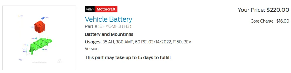

And then compare that to the Lightning's 12V (Low Voltage Battery-LVB) and you'll see why you need a powersupply to do any programming at all:
