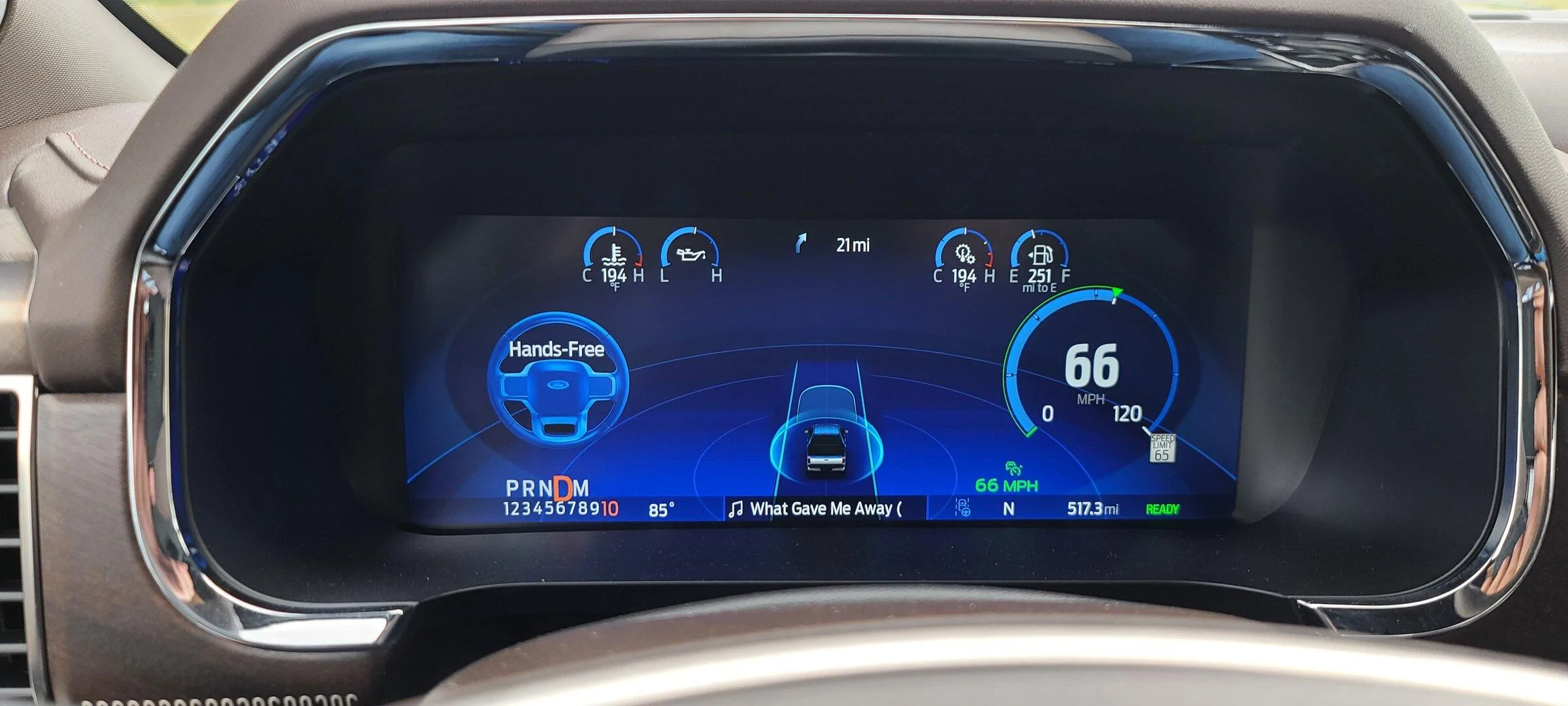

More than an addiction. Got up to version 22034/Revision 364 with BC 3 weeks ago. New APIM, TCM and GWM update popped up today taking me to version 22095/Revision 421. So far I don't see anything new or different with this update.
