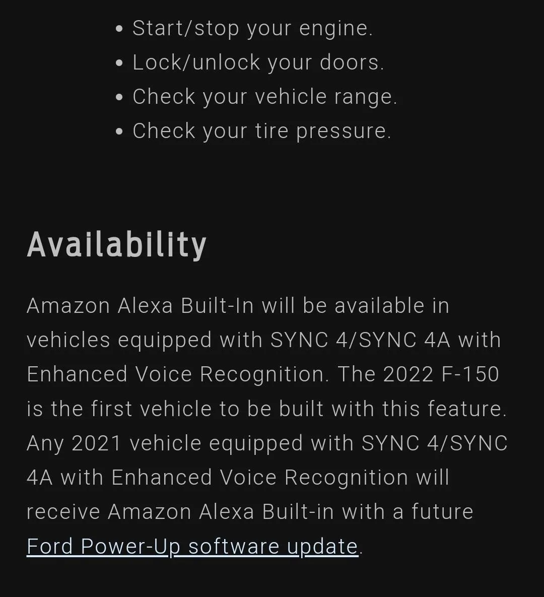

Can you help in that please. Also do you know how to enable Alexa in Job 2?
You cant enable alexa without an update. there is no update available
Make 7D0-02-02
4600-0000-40XX
If it doesnt work then it wont show without a later software version. I thought it did work on Job 2 but i may be worng.
unixadm
Feb 15, 2021
253
342
Elk Grove, CA
2021 F150 XLT 5.0L Sport
I completed the remaining updates on my 21 PowerBoost Platinum Job 1 truck this morning. No issues to report. APIM updated to 421 as well. The only pending update is the GSM which others reported won't go away even though it was updated. I had a couple crashes of FDRS which occurred at the end of a programming session for a given module, but it never crashed where it left the modules in bad shape. Once it did crash when it had not yet completed other associated modules, which lit up some DTCs until I completed the updates on companion modules.
I tried out BC today and wasn't overly impressed, but the best improvement is the calibration for the hybrid drive itself. Overall it seems a bit less clunky now and it's easier to stay in full electric compared to the original calibration on my 01/27/21 built truck. It will also cruise longer at higher speeds on full electric versus the prior calibration. Transmission shifting also seems a bit better as well, and I had just reset the adaptations last week prior to performing all of these updates, so I could compare apples to apples. I easily completed this on a never updated Job 1 truck in the two day FDRS license window.
Make 7D0-02-02
4600-0000-40XX
Jesse, "Alexa Built-in" is a 2022 F150 only feature currently. But Ford says:
Ford F-150 ECU module programming guide using FDRS Screenshot_20220501-212732_Brav
