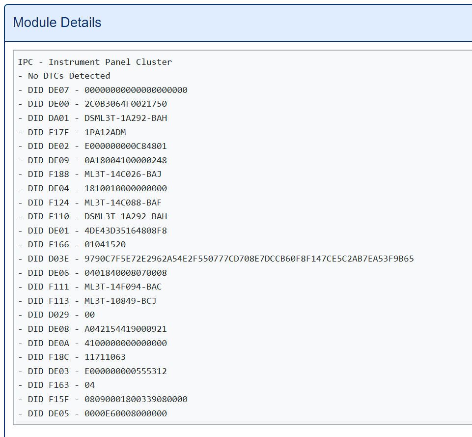

Ok guys with 8' XLT clusters Please compare your cluster to this info and let me know if yours matches. If not we know our issue. I believe though if field 188 is the non matching we can do the same I have been for others with the 12" and remote in and get you fixed up. If you match and are not getting passed the updates then We are back to square one!
Jesse my 188 is ML3T-14C026-BAK
do you want to remote into my system? Here are my values...
Yeah Im trying to confirm because he said his update went through so let me look at his logs.. Its odd the last letter went backwards.. so let me be sure.. I was going based off what I was told that their update went thorough without a hitch.
Let me confirm in his logs.
