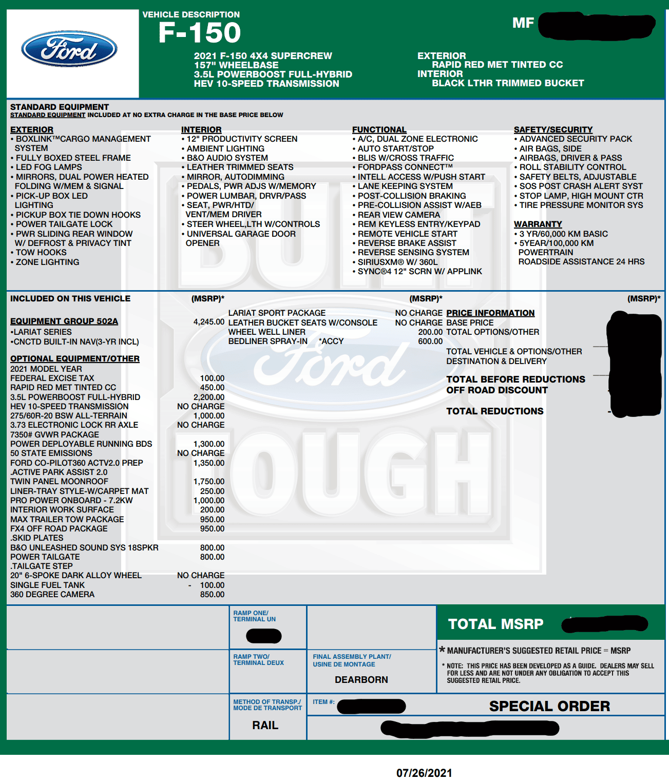

For anyone interested below is the procedure I used to verify my setup for proper cameras in motion and BC.
1 - I found a donor 2021 Job2 truck on a dealers lot exactly the same as mine with BC on the window sticker (Minus mine is a powerboost and the donor one was a 5.0) and compared IPC, APIM and IPMA settings.
2 - I downloaded my AB and the donor trucks AB information
3 - Renamed the AB files from .ab to .xml
4 - Used WinMerge to "Prettfy the XML" and compared the values. I use @livinitup's spreadsheet to verify non important/truck specific info and only changed what was necessary.
These are all the changes I made to match the job2 truck with BC from factory.
IPMA
706-02-02 xxxF CExx xx--
706-04-01 xxxx 1xxx xx--
APIM
7D0-01-01 xxxx xxxx Bx--
7D0-01-02 Axxx xxxx xx--
7D0-01-03 xxxx xxxx xF--
7D0-01-04 xxxx FCxx 6x--
7D0-02-01 8xxx xxxx xx--
7D0-09-04 xxxx xxxx Fx--
IPC
720-01-02 xxxx Bx--
** Please note that some of these may be different for you and your truck. Mine is a Canadian Job1 Lariat Sport PowerBoost, attached is a snippet of my widow sticker for reference.
