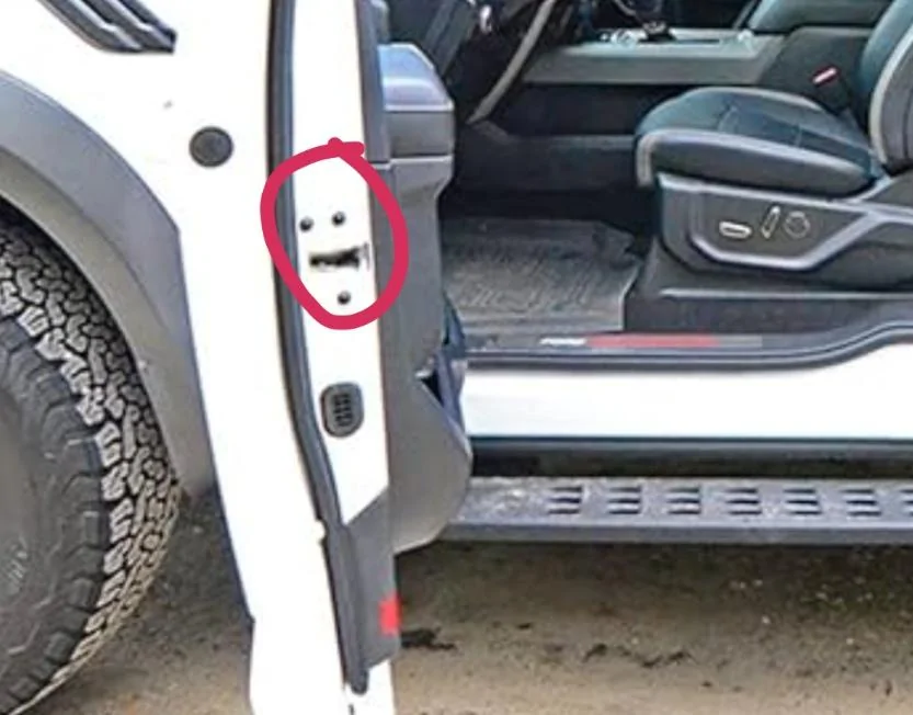

I also am sorry for lack of terminology. Where the door latches to the actual truck that mechanism in the door has three screws I think it's coming from there I've attached a picture. I can get the door to do this same rattle when the stereo is loud with emphasis on bass with the door open. When I pushed on one of the torque screws circled in the picture it got much quieter. So maybe the latch mechanism has something loose or there's a worn bushing or something. Mine does it at 70mph+ or songs with heavy bass in it. Let me know if that makes sense

Interesting. I’ll see if I can recreate it that way. I haven’t been able to other than just normal driving over bumps. Mine seems to be more at lower speeds but I have heard it on the highway too. I’ll mention it to servicer advisor but who knows if they’ll actually do anything about it. If they do end up fixing it I’ll update with what they did.
