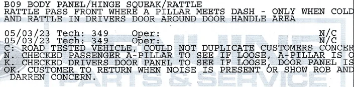

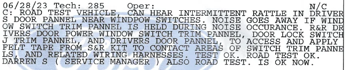

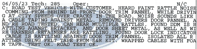

Thanks guys. My noise is right around the inside door handle and power window switches. Here are the report the tech put on the work orders.
