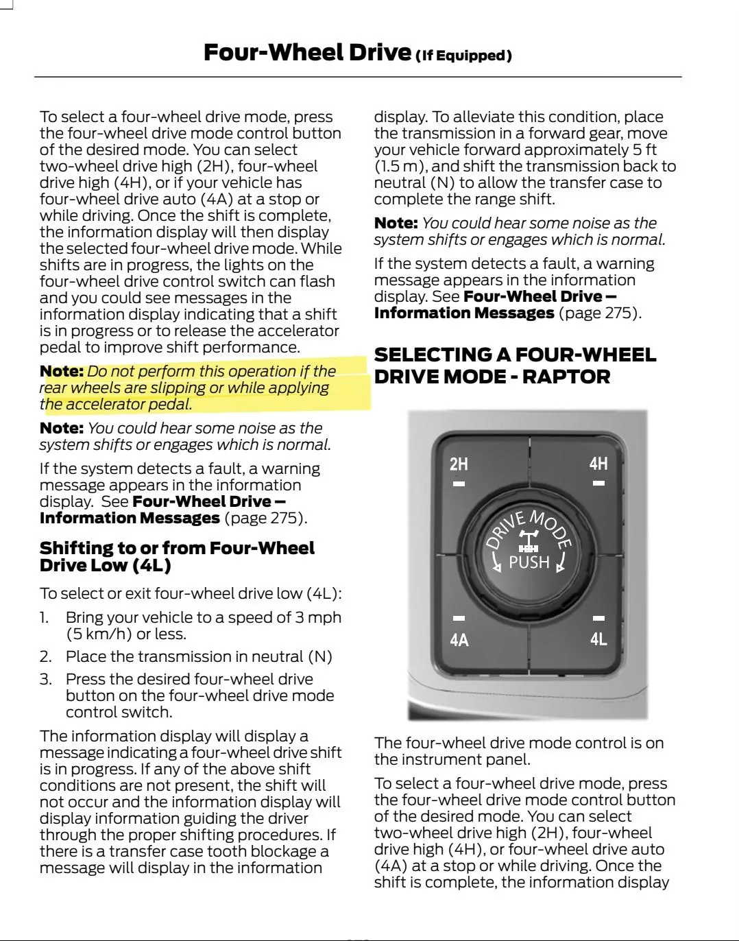

While I have read that you have to be going under like 20/25mph to engage the locker, and that it will automatically disengage at like 25mph, I haven't round anything about what speed it's safe to change modes.
I have 4 buttons for which wheels are engaged...2H, 4H, 4L, and 4A. Is there a reccomeneded MPH max for making changes with these?
I also have the dial that allows changes in modes, Normal, Eco, Sport, etc. Same for this, is there a max MPH for making these chnages? Many of these modes, also have a built in change to the drive wheels, eg., going from Normal to Sport, automatically moves from 2H to 4A.
Thanks
