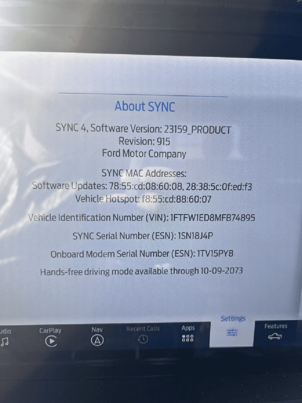

I do get the message that Bluecruise is available and I do get the steer8ng wheel, but it does not state “hands free”, but my software level says “Hands Free available until 2073”. Any advice?
That expiration date is normal. Eventually you will get an update that will show the correct one there.
