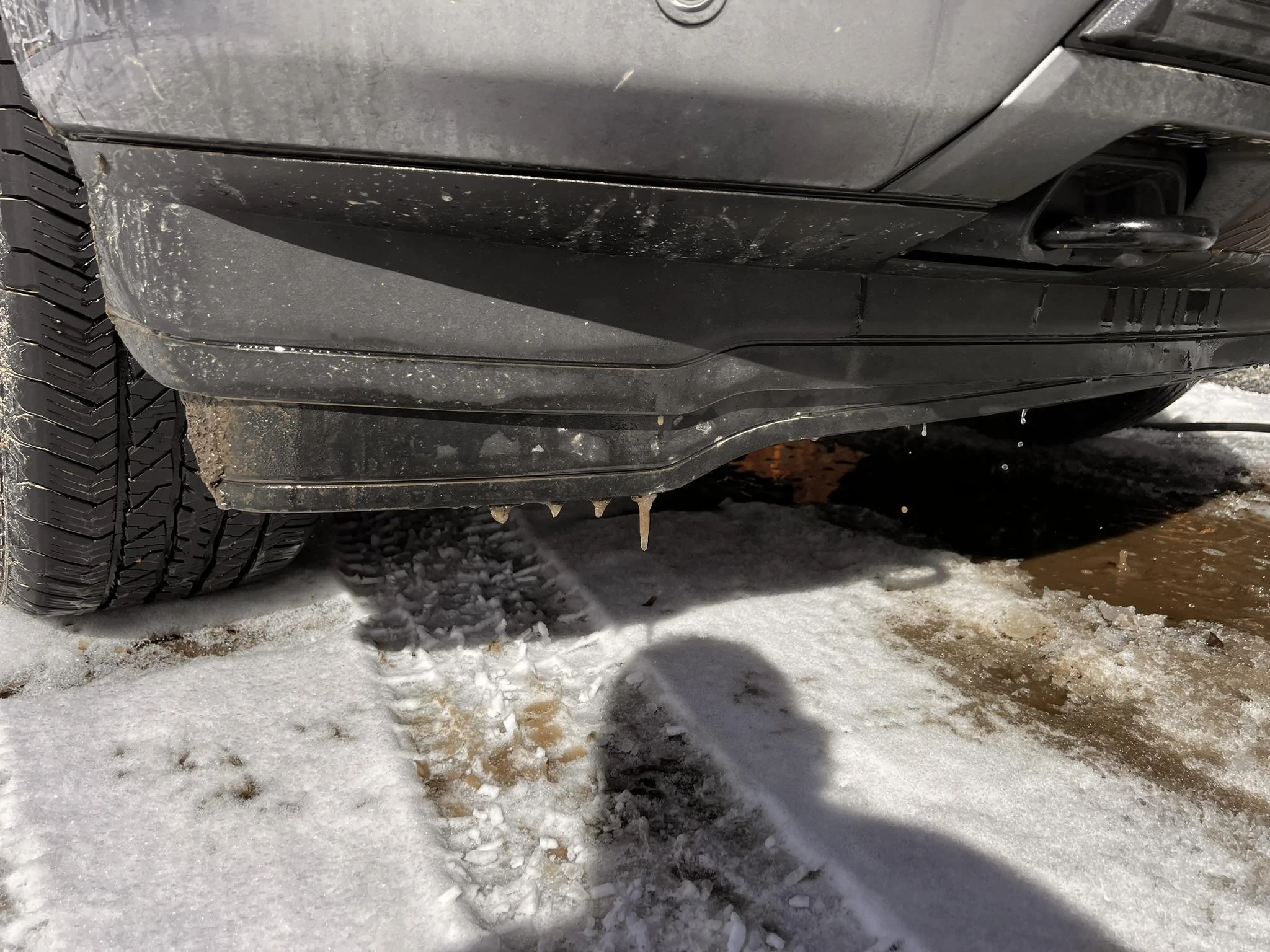

Are these the only connectors you need? why 9 of the little ones? are they fillers?
Ford F-150 Disable Active Air Dam via Forscan IMG_4358
are there two different connectors? Mine gets stuck down. wet snow plus -20F will lock them up pretty quick. I do wash my trucks with hot water once a week to remove ice buildup.
