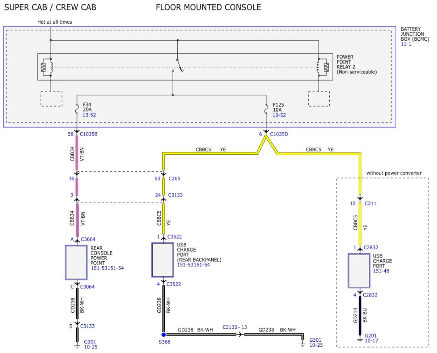

Eleminated another options as not sufficient:
I added a 12V outlet directly to the aux battery (not sure what the one in the console is rated for, probably only 50w or so), and then plugged in an Anker 100w PD adapter. Usually Anker stuff is pretty solid. This was by far the best result so far with DC power. The unit did power on, but was stuck in a reboot loop. If the power bank I ordered doesn't have a enough oomph, or won't charge and discharge at the same time, then I will have to no choice but to cave and power it from AC.

Truck's 12v sockets are on 20a fuses w/ 16ga wire.
