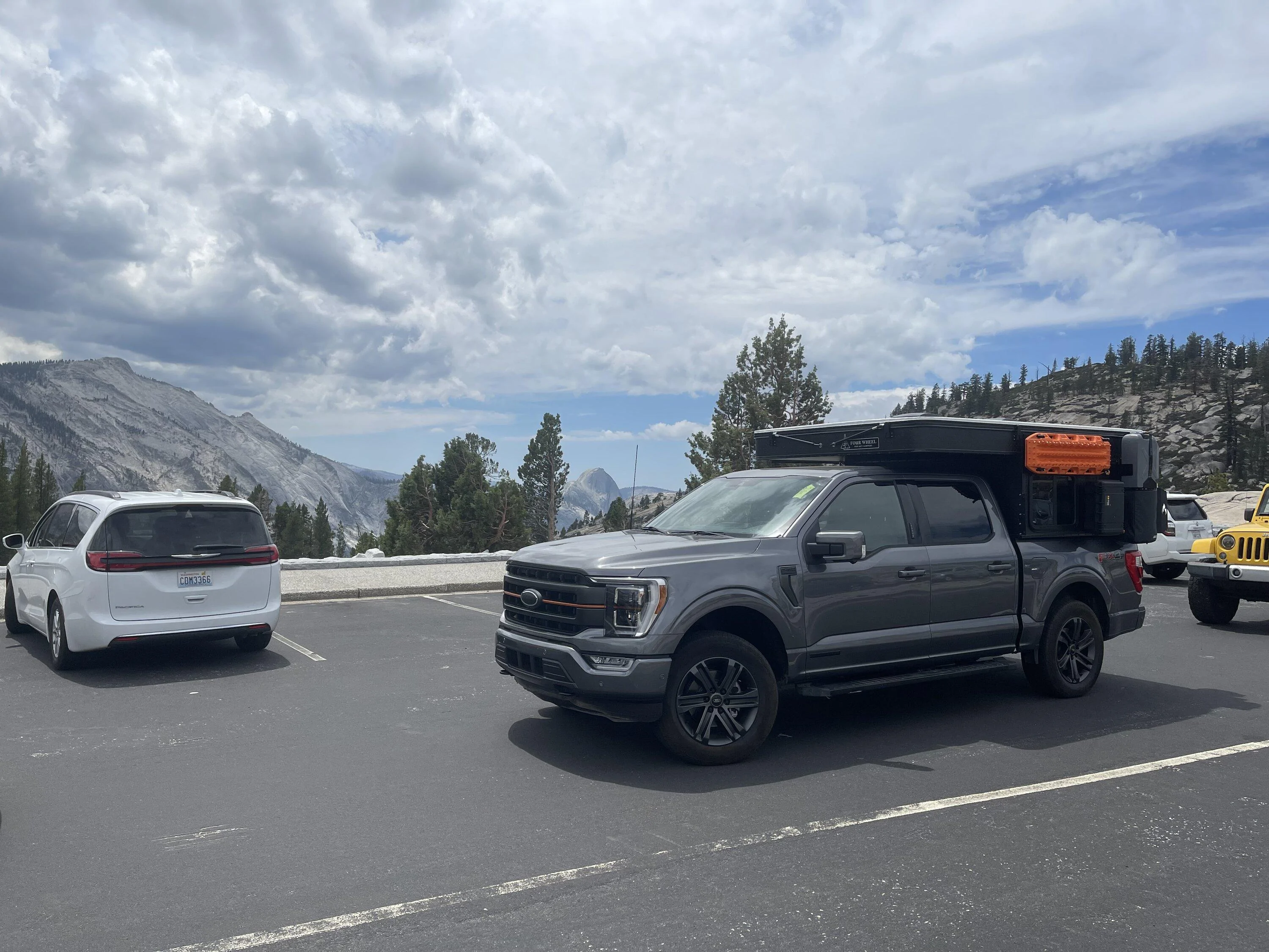

Yeah. This is what I’ve been doing. I’ve got a Bluetti AC200MAX which I charge via the AC outlets. This in-turn powers everything else via its DC outlets.
So it sounds like your build doesn't have a dedicated 12V system and battery(s).
Are you using a removable setup like one of the rack-top tent systems?

No. I have an FWC ProjectM
