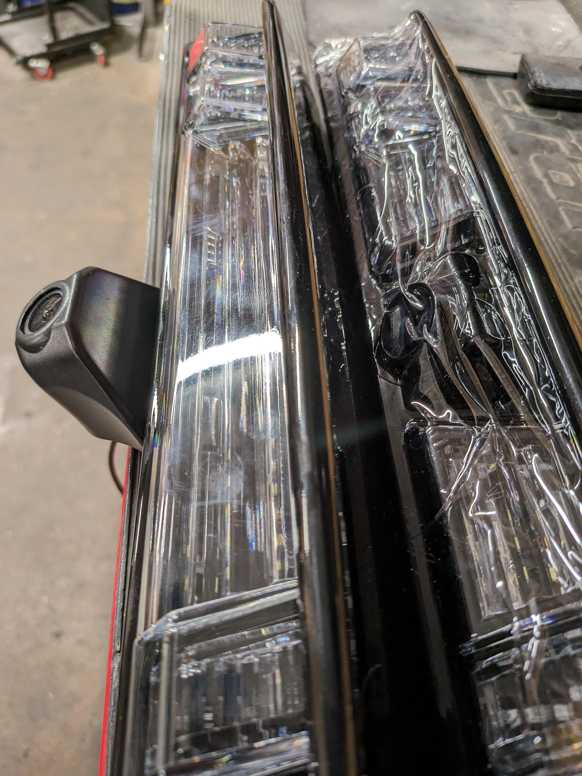

Digital mirror/dash cam setup showed up today as well as both Morimoto third brake lights. After comparing the two, I've decided to use the camera bezel from the digital mirror with the non-camera Morimoto third brake light for a few reasons.
First is because the camera equipped third brake light has about half of the cargo bed light compared to the non-camera third brake light. You can see in the pictures the camera mount takes up a large portion of the middle of the setup which is where the cargo bed light is.
Second is because the camera equipped third brake light the camera points much lower towards the bed and won't allow for much visibility behind the truck for the dash cam. You can see in pictures the angle difference between the two. The digital camera actually has two different camera angles in it, one that angles further down into the bed, and one that angle further upwards to see behind the truck. With it pointing at the angle the factory camera mount is it won't have enough visibility behind the truck.
Third is because I would need to Dremel the heck out of the Morimoto light to fit the aftermarket camera. It is setup for the OEM camera with how it mounts which is very different compared to how the aftermarket cameras mount. I would then have to use gasket sealant or something to seal it back up, and I just feel like that's a ton of work to potentially make it look factory, but have less cargo bed light as well as the camera behind at the improper angle to see behind the truck clearly.
